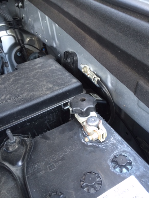

Like I said earlier, I have had the same lights come on during the last month. So I installed a thumb nut to make resetting the engine lights easier. The first time I set the lights off was because I disconnected the MAF sensor while the engine was running. Then the second time because I was moving a trailer that was tail heavy. The tongue of the trailer was lightening up the rear end. This confused the traction control system and set off the same lights again. So now, I will probably never need to reset the lights again.
