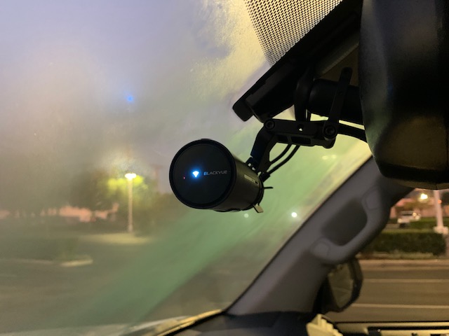

Blendmount with the wiring running up the OEM wire track on the windshield. I ran it down the driver side A pillar since the fuse box is there. No problems pulling the headliner down slightly and pushing the wiring it.

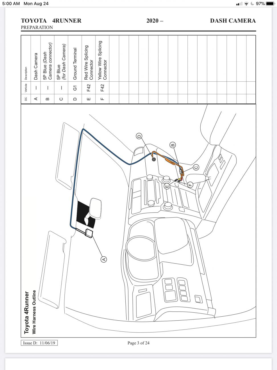

I just purchased a 2020 Limited 4x4 and I have an old dash cam already with a USB power connection. I was hoping to find a dongle that could hookup to the rear view mirror power, but the new TSS-p has changed the wiring. I did find this wiring diagram for the Toyota dash cam that may help with mounting and wiring.
