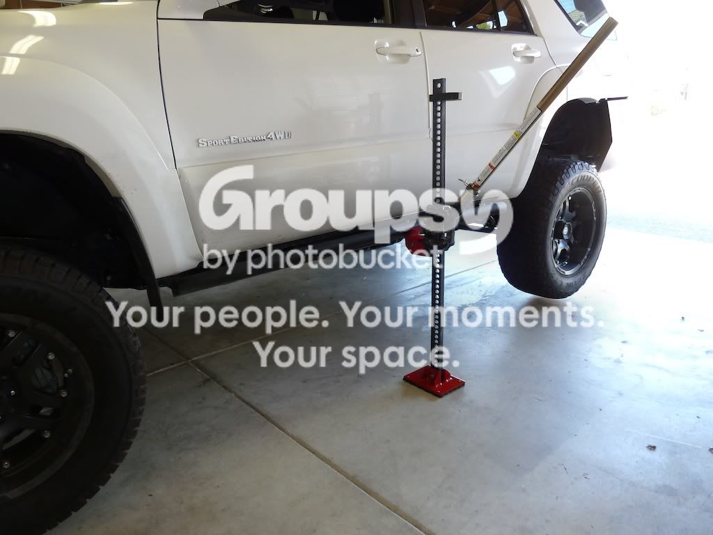

I just got a '17 TRD Offroad and am starting my build and was looking into the Demello Offroad Hybrid Sliders.
When you swap your tire are you putting in a jack stand after lifting it with the Hi Lift or just leaving the Hi Lift while you swap the tire? (I'm trying to figure out if the Demello will support the weight of the vehicle while I swap one tire at a time.)
- mainly trying to figure out long term effects of just the hi lift on the bolt on application with no weld
Love your build!
[MENTION=153423]packrunner[/MENTION] Thanks!
Let me start off by saying that I dislike using the Hi Lift jack and avoid using it except only as a last resort when no other jack is available or a viable option. When at home, I always use a floor jack and jack stands. Of course it's best to use jack stands whenever possible. Sometimes it's just not an option. I've only had to swap out a tire once while on the trail. The terrain wasn't conducive for the safe placement of a jack stand. I put the spare tire under the 4Runner before removing the bad tire. Then placing the bad tire under the vehicle before installing the good tire (while the vehicle was held up solely by the Hi Lift). The Hi Lift isn't the most stable platform but sometimes its the only option. It's always good to have something non-compressible under the vehicle (like a wheel) in case it wobbles off the jack. So to answer your question, the DeMello sliders will support the weight of the vehicle. I've also "slid" over boulders along the length of the slider. Nothing that a can of satin black spray paint can't fix once I got home.
