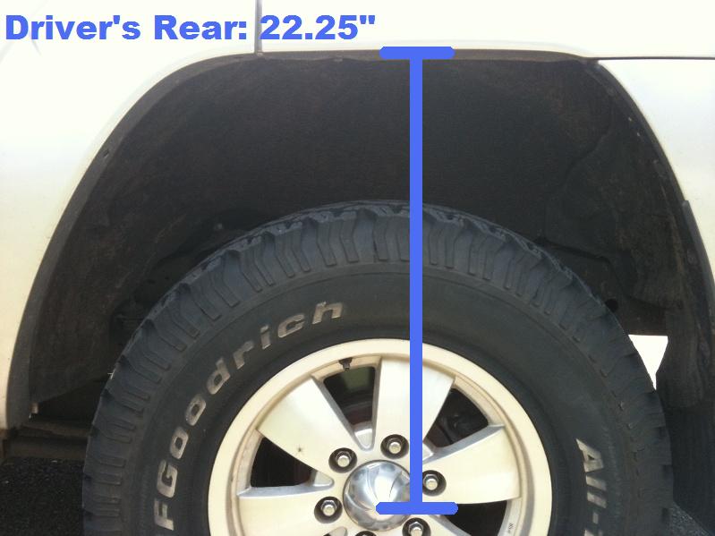

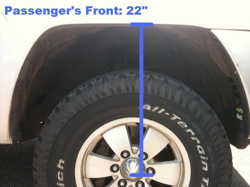

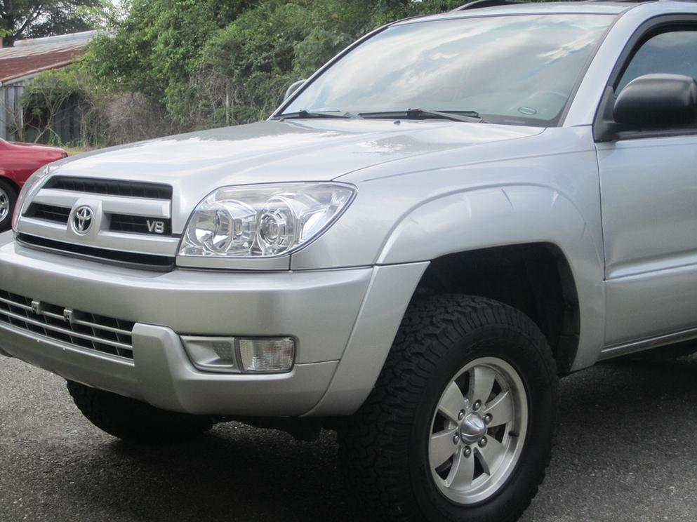

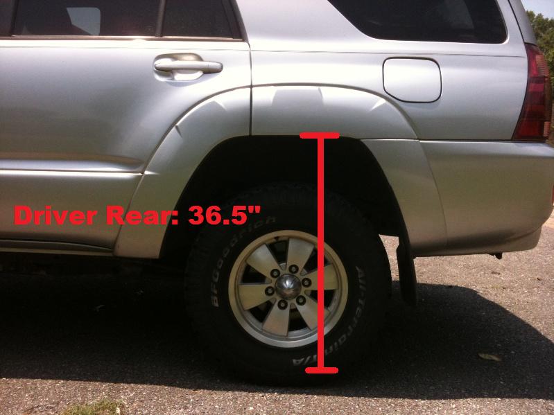

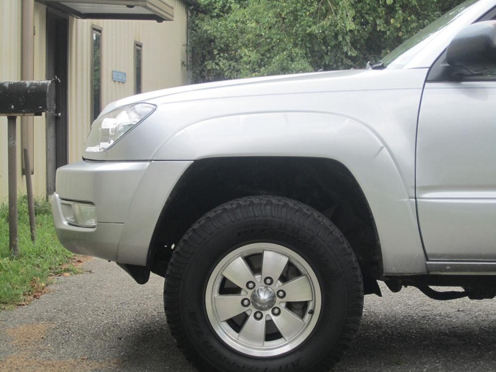

Daystar 1.25"/FJ Springs/Medic Links and Sway

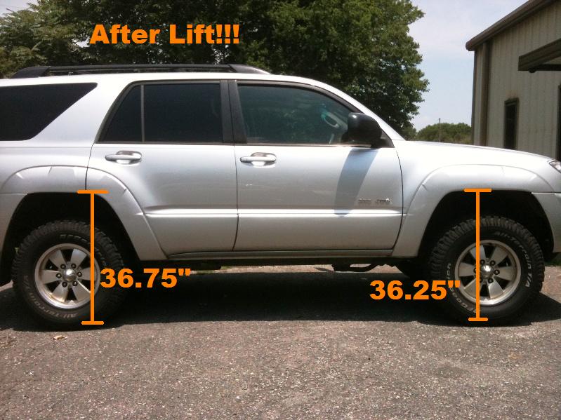

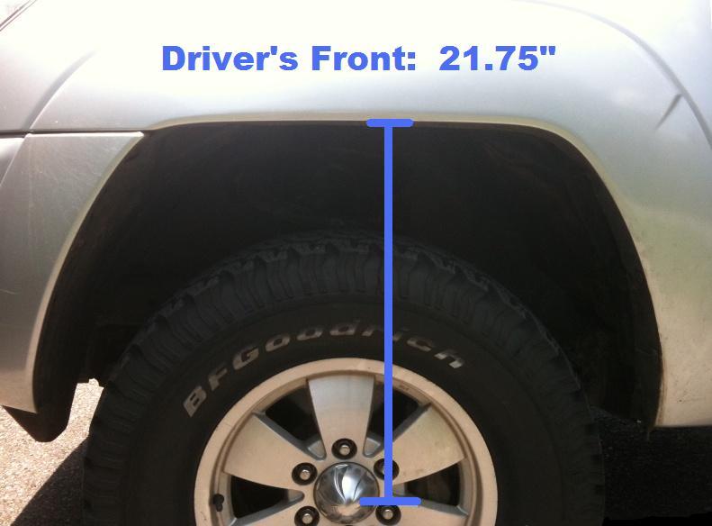

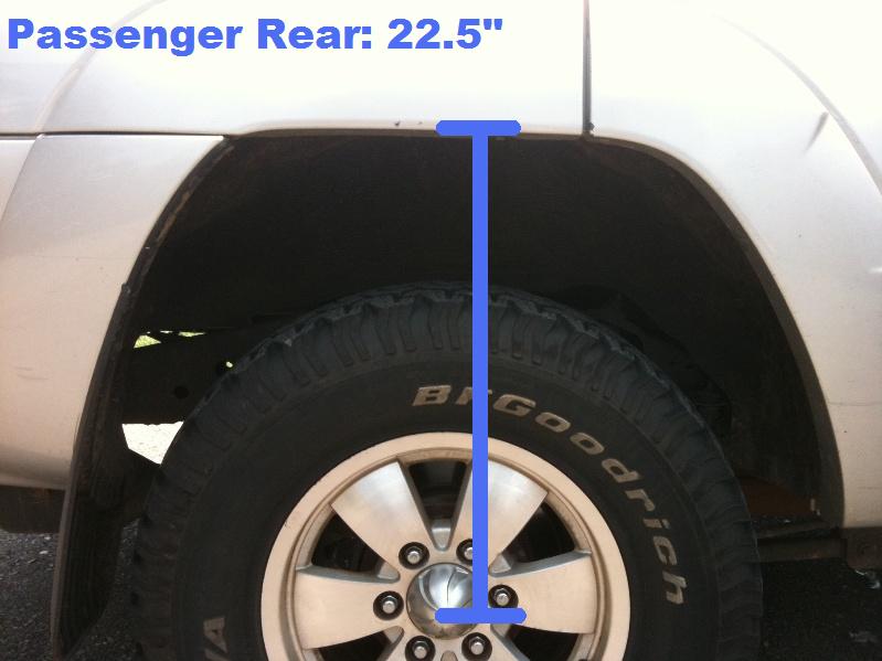

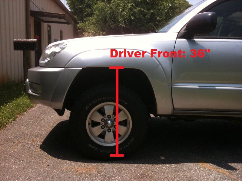

I gained about 3.2" in the front and 1.3" in the rear after the install... This is using "before" measurements from other members because I forgot to write them down before the install. Well judging from my incredible gains, I guess my stock springs were about done for. The shocks were ok, no leaks, etc. so I'm leaving them on till I upgrade to coilovers.
These are all "After" photos!!!

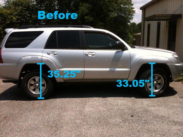

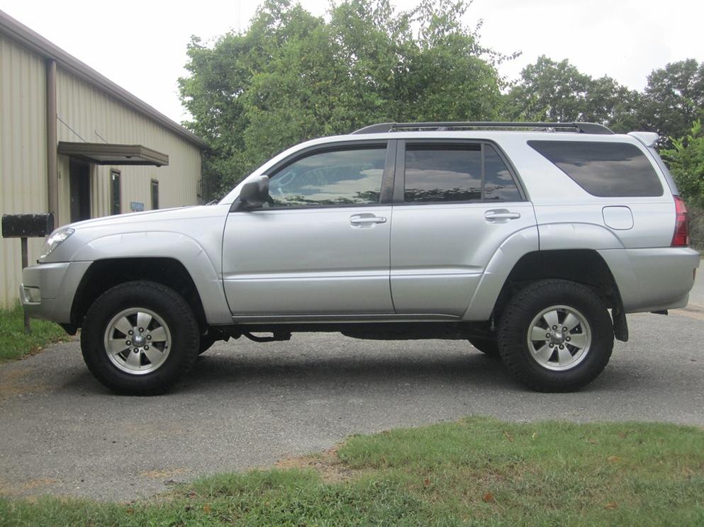

Here's the last pics with BEFORE and AFTER!!!

YEA! looks good! Thought my car looked completely different w/o the running boards on too...

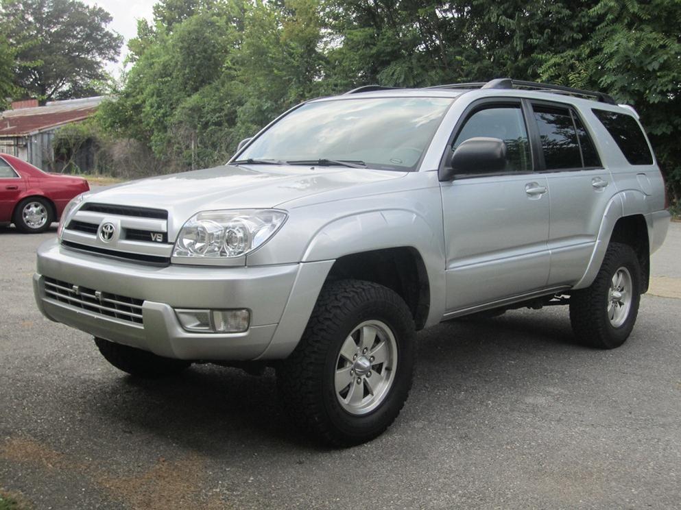

But how's the ride now???
Rides great! Better than stock... plus it feels like a real SUV now. I pulled up beside a suburban yesterday, and we were the same height. That's a good feeling haha

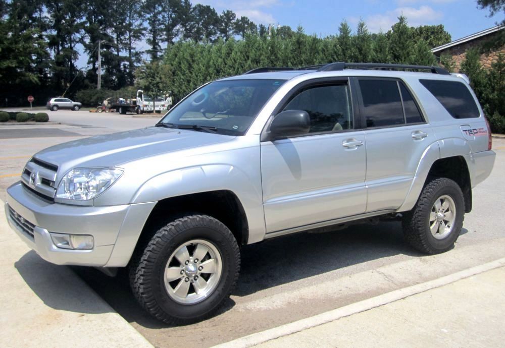

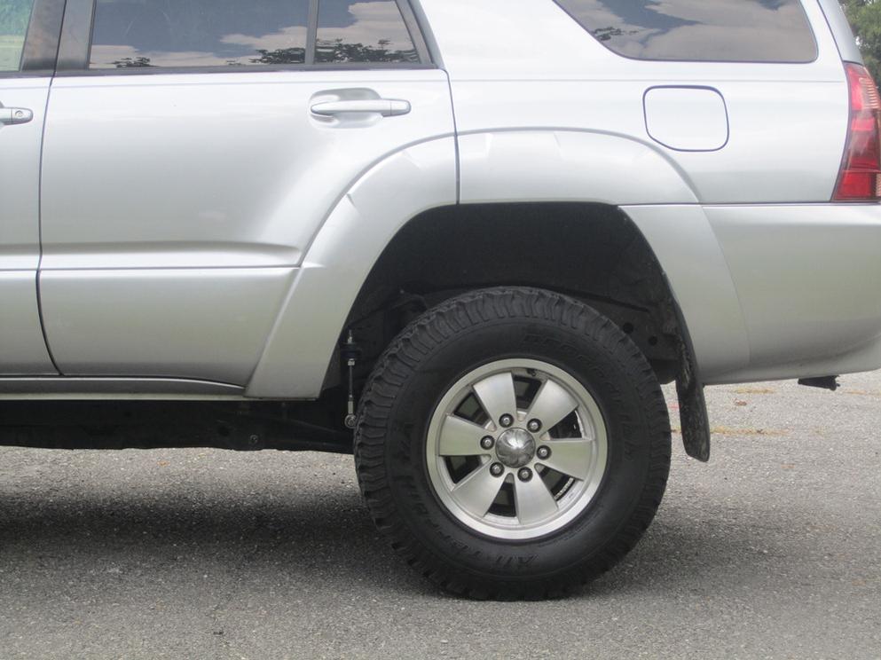

Added a Daystar 1.5" Rear Spacer, which I should have done in the first place. Looks alot better. I would have done the preload spacer as well, but I think I might get Bilstein 5100's for the front to firm it up some more.
looks great dood!!! i had to add the rear DS 1.5" as well. looked totally silly without it on my set up.

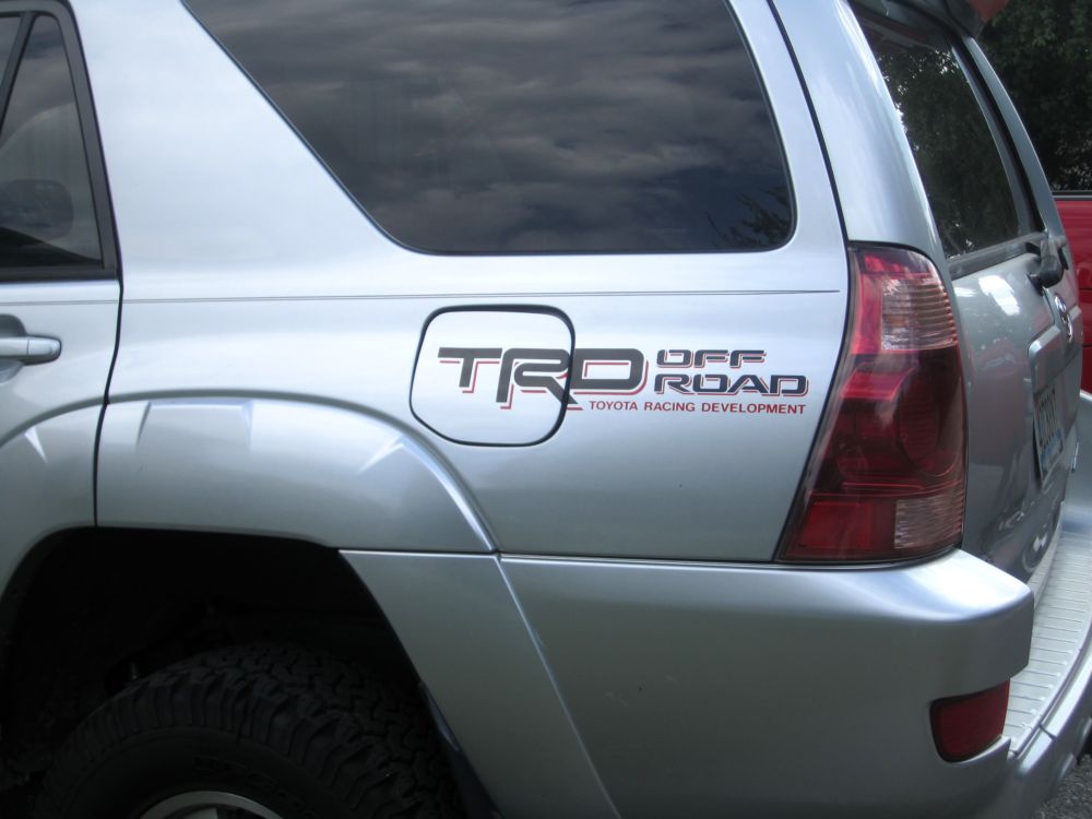

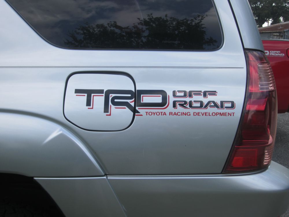

Added TRD Decals. I think they look good on a lifted 4Runner if properly done.

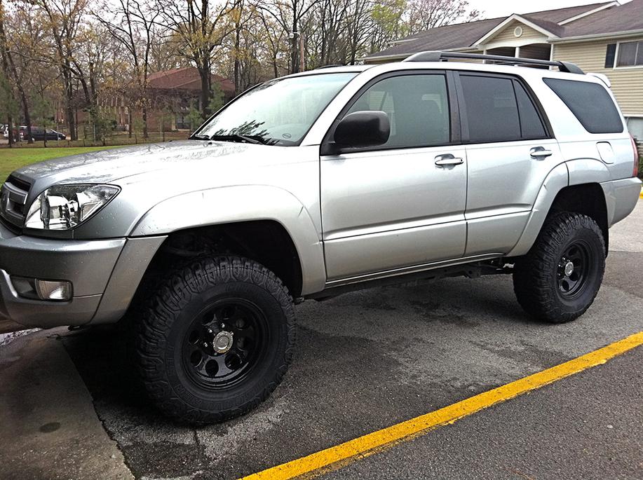

1.5" Body Lift
Cooper Discoverer STT 285/75R16
Procomp 8069 16x8, 4" BS
