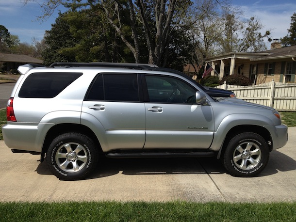

I read many threads here about the best way to level my 2007 Sport 4x4 and figured I'd start out with the 1" Budget Spacer Kit from Daystar. I picked it up from 4Wheelparts.com for around $45.

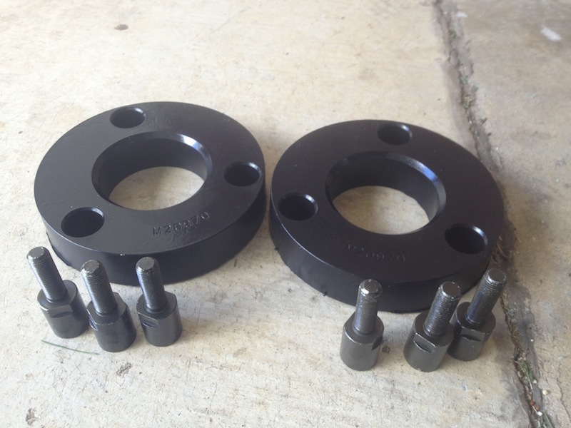

The kit is different than the one that Daystar shows on their website. It now comes with 6 stud extensions instead of replacement studs. This made it a whole lot easier than taking apart the strut & spring.

singleshot: Did you have to cut any of the original studs to add the extension studs? I will be adding the same spacer kit and the direction provided mention cutting the original studs to around 3/4".
you shouldn't have to cut anything.

Received the budget boost spacer the other day, and it is the new EZ install type w/ stud extenders. The instructions say you have to cut down the existing studs to 3/4". Has anyone else had to do this?
nope
but my kit was the 2.5" front lift
