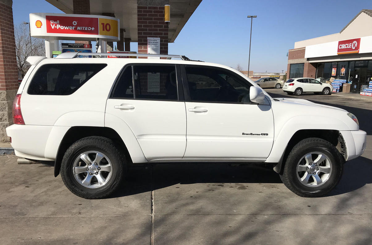

I did not trim the existing bolts like the instructions said. Here is a pic of the installed spacer and one of the truck as it sits with it installed. Plenty of room and everything tightened up like it was supposed to.
Biggest PIA is that inner nut on the top of the strut.

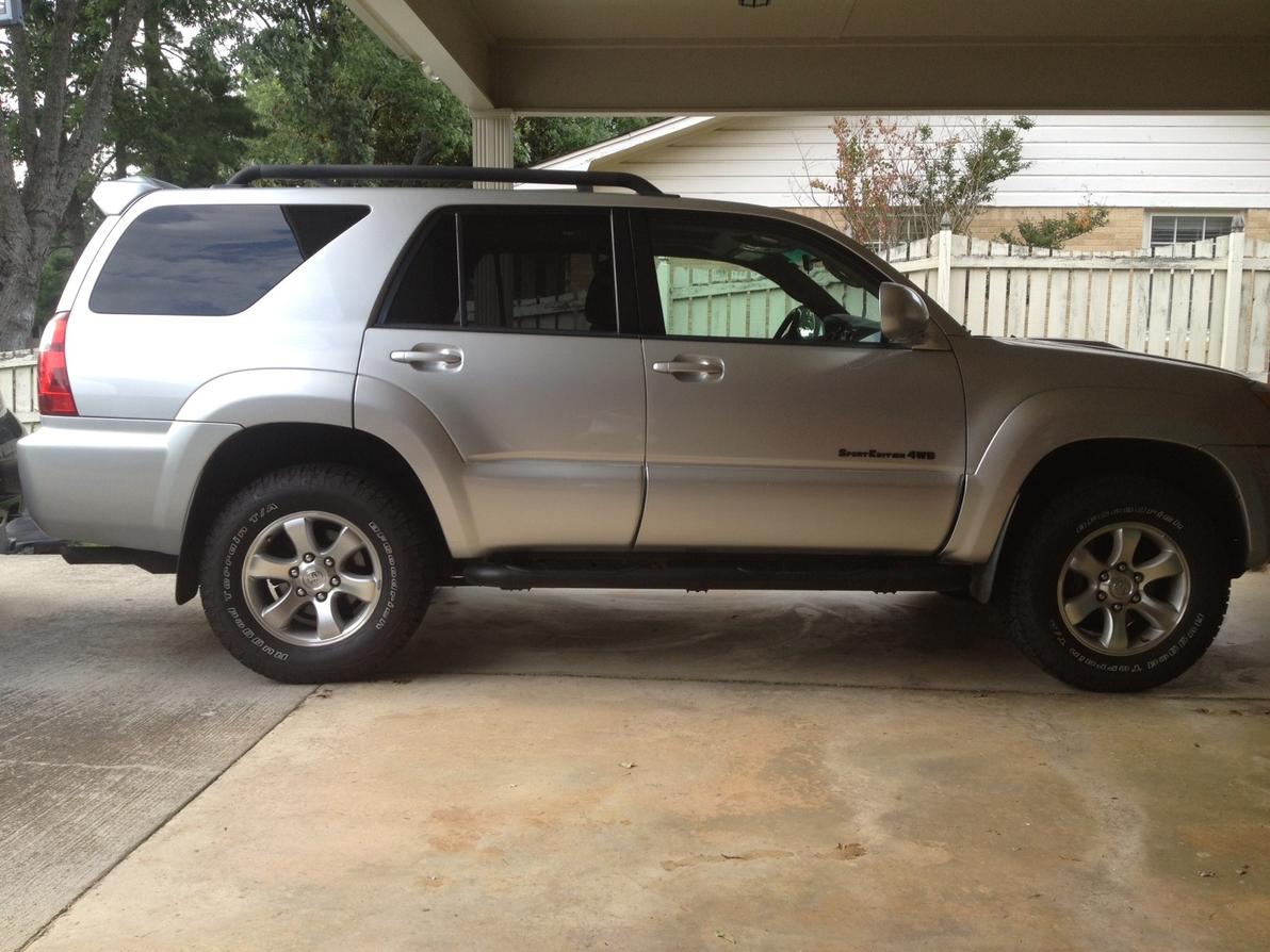

PS here's a picture of how it sits after the lift. (excuse my missing roof rail fascia - came off in the car wash :frusty:)
