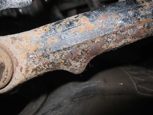

I also jacked up the truck and looked around a bit more. Still don't immediately see the problem. That a-arm "bump" certainly seems to be a likely culprit, but I want to be logical about finding the solution.

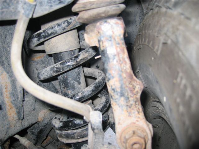

Can you take a pic of the top of the tire looking straight sideways in from the wheel well? I want to see how close the tire is to the top A-arm.

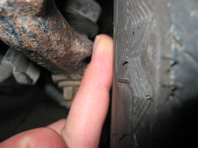

UPDATE:
The a-arm "bump" has enough room for a pinky finger to slide thru. It is tight, but should be enough.

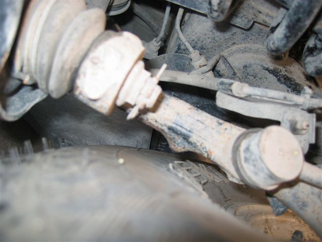

p1

I can't belive that is so tight in there! I'm running a bigger tire and I have more room than that w/out my spacers.
jacal,
Thanks for the pics. If it's not rubbing now then maybe the tire damage was done between the time you got the lift/tires and had the initial alignment.
How much room do you have between the front passenger tire and the top A-arm with the wheels cranked left at full lock? Also, how much room to the frame?
