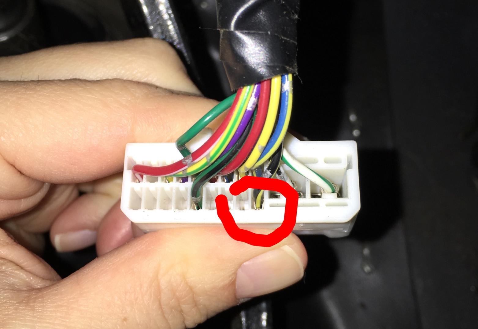

Old thread but helped me out so attaching a pic of the connector and the wire you cut on 2002 trucks.
