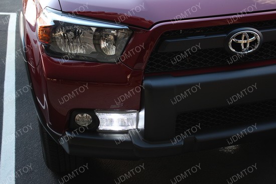

Cobalt Anubis New member Dec 24, 2015 #1 Has anyone posted a thread on how to change the bulb in the daytime running light housing? I havent seen one for 5th Gens. I just ordered the all white LED conversion bulbs and antiblinking device. Thanks. Attachments Toyota-4Runner-LED-Turn-Signal-03.jpg 65.3 KB · Views: 2,803

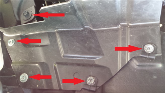

barryhiram New member Dec 24, 2015 #4 There is an access panel located under the bumper (drive & passenger). Remove bolts, panel, change 1156 bulb! Attachments Access Panel.jpg 47.7 KB · Views: 1,391
