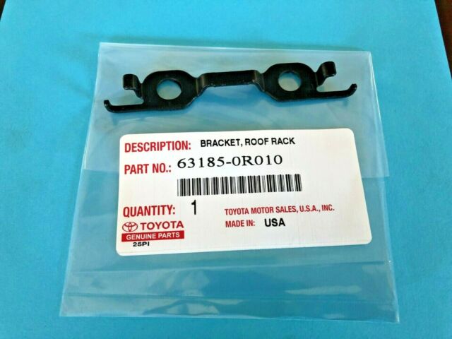

With the install kit, is the install just straight forward?
there’s two things to keep in mind:
1. When removing the oem bolts, remove them in pairs. As a pair, loosen on like 3 turns and then do the other one. The goal is to keep the retaining clip from falling off. Having both bolts in and removing them together will allow the retaining clip to stay in place. Also keep in mind there’s lock-tire on the bolts so it will get tough at times to turn.
2. Keep in mind order in which the washers go in. From bottom up.
Foam washer - adhere to the bottom of rack
Composite washer - top of rack
3. Metal clips - you’ll need to get the metal clips which sit on roof and between the white plastic tubes separately. They are not part of the instal kit. Let me find the part numbers and post it here later.
Awesome thanks!
So it would go
-metal clips
-foam washer
-rack
-composite washer
-then torx bolt

are these the metal brackets?
