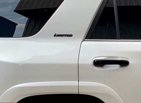

The last picture in the driveway looks like you pulled the limited badge.
Your build is exactly what I wanted. The limited innards with the SR5/TRD outside.

Yes I think I pulled the limited badge off the day I installed the roof rack. the chrome was bothering me.
If you wanted to, you could get an Tundra OEM black plastic overlay with double sided tape to go over the chrome. That is what I did when I was getting the OEM black out kit..

It's tough for me to tell (or maybe I'm just slow) but did you have to mod the front and rear fender flares so the lower profile rocker panel trim matched up? Or do the rocker panel trim parts you provided in an earlier thread match up well to the fender flares?
It’s hard to tell in the pics, but my Oem (limited) rear door flares does not line up with the rocker panels. The fronts do. This is because the limited has a different angle rear door rocker vs non-limited.
I have the correct rear door rockers, but I forgot to have the shop paint it when I got everything else painted :-(
I plan to to do it some day :-)
There are two options, black or body color. I believe the black has a texture to it. Body color is smooth and paintable.
