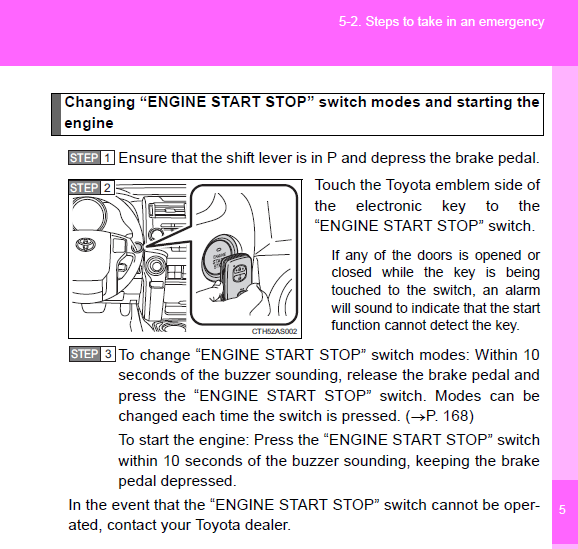

You can start with a dead battery. Hold the key fob up to the push button start with the Toyota emblem facing the start button, press the brake, and then press the start button.
Also, :rtfm:
Awesome, that's what I'm lookin for. I tired holding it to different areas of the column and dash with no luck. I ended up sticking the key down my pants and sitting on it for a while to unfreeze it and it finally started after about 20 minutes lol

Toyota's smart key system is the same as most in respect to dead Key Fob batteries. You just have to pretty much hold the damn thing over the button for a couple seconds until the light goes green, if I remember right the system wants it to be Key OFF, Engine OFF when you do this; doesn't like it in Acc mode; I'll see if we have a Prius or 4Runner tomorrow to double check this on. :)
