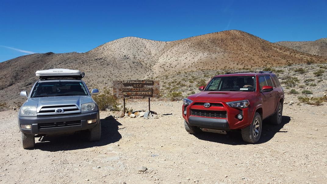

My buddy's '14 Trail is bone stock running BFG AT KO2 tires and it did great. At some point on the Racetrack road, he experienced shock fade which is expected from the pounding we received. We took our IR temp guns and measured the temps of our shocks. His were smoking hot but mine were not nearly that hot. I experienced zero shock fade and the 6112s stayed cool no matter how rough the roads were. With the RTT on top, the cornering was still relatively flat, no appreciable lean were felt by me. This impressed me to no end given that 100+ weight was on top at all times.

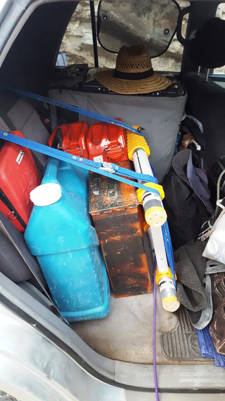

Cargo management:
I started to cut out a 1/2" plywood for a rear cargo shelf when my GF said just to use the factory dual shelf thing on this trip and figure what I really need. Damn it, she's so right:thumb: So, I used that and it worked out well. Things moved around quite a bit w/o using any straps to keep things secured. Two five gallon NATO gas cans and two water cans were inside and strapped down. The sloshing weren't as bad as I thought they'd be.

Cargo management:
