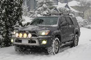

Just posting a small pic so I can get it on the main page :)
