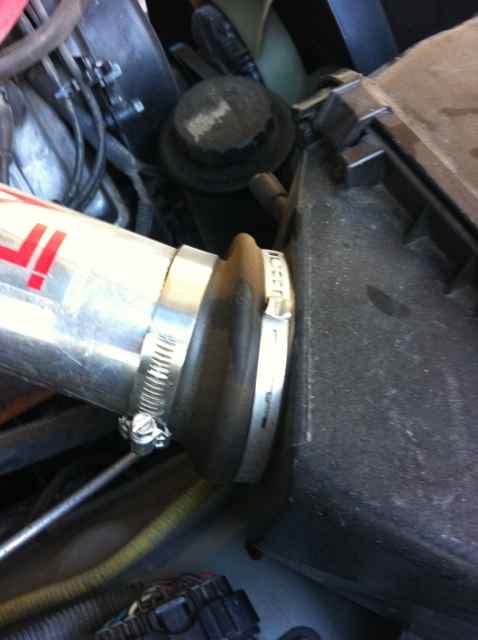

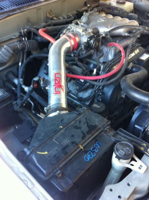

This has worked great for me the last few months - a straight shot intake tube modified to fit into the stock airbox. Nice, quiet, unrestrictive and snorkel friendly.
