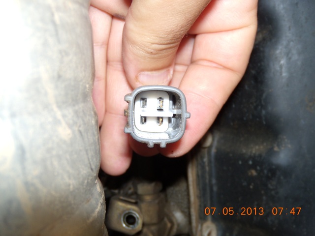

Pulled it to check
So I got under the truck this morning and made sure. Sure enough you are correct Sir.
Thanks again, parts ordered today.

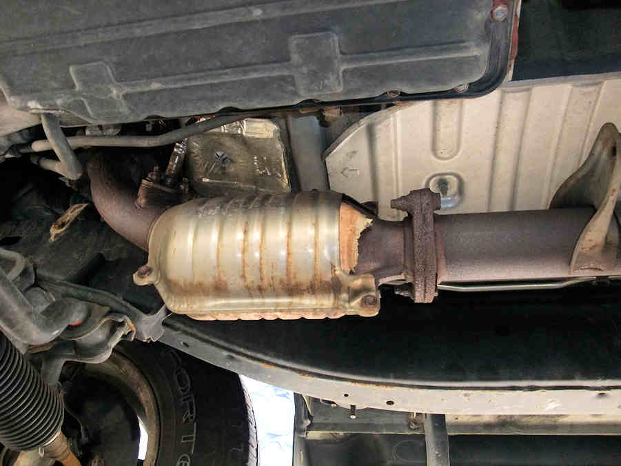

Here's a quick pic I snapped...might not have gotten the best view of it though.
As far as I know (and I'm no expert) if you have just one cat there will be just two O2 sensors. One is upstream, before the cat, and the other is downstream, after the cat. The purpose of having two is to compare the exhaust gases before and after the catalytic conversion to make sure your cat is functioning efficiently.
I think only the California spec exhaust systems have an A/F sensor. Also (and I'm not totally sure) I believe if there is a second cat, it will be smaller and more round, and toward the front of the vehicle from the one in your photo. I think on some of the later models (4th gens) there were two sets of exhaust pipes, each with a catalytic converter and a bank of two sensors. Maybe that was just the V8's? Anyway, hope this helps.

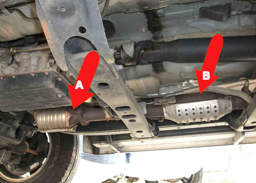

All the trucks have two sensors. The two-cat systems use an A/F in front and O2 behind, and the one-cat systems have two O2's. On two cat systems, the front cat is right at the bend bend upwards to the manifold, so I can't tell from that picture. It looks different from the rear cat. These are pics of a two-cat system.
