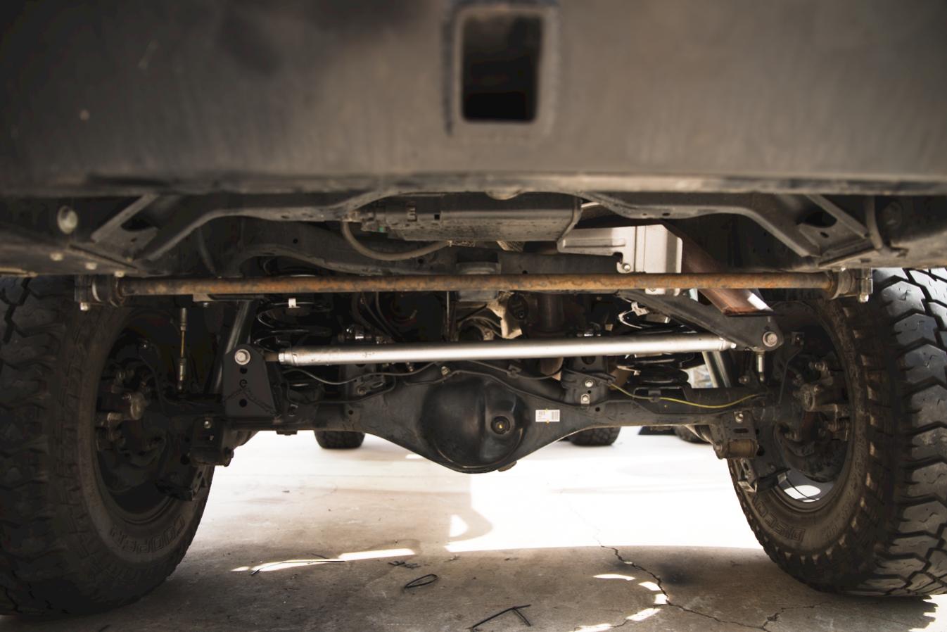

I have ordered and received the Panhard correction kit seen here for my 5th gen with KDSS. When I initially installed my lift (Icon with extended travel) my Panhard bar would contact my KDSS track bar at full droop. I since added the adjustable Panhard bar by Icon with the 5 degree bend in it (seen in the 1st picture). This helped some but occasionally at full extension the Panhard bar will contact the KDSS system. Therefore the solution was to try this kit out or go with the sonoran steel Panhard bar that is designed with the bends in it (2nd picture). With the correction kit being <100$ and the new Panhard bar being nearly 400$ I decided to go this route. Plus would also be to restore normal geometry. My question for this thread is this. Will I be ok using the Panhard bar with the slight 5 degree bend in it (it can be made stock length) or should I replace it with a stock length straight (no bend) Panhard bar (OEM vs. ICON vs other brand).
I think you need both. The PCK is meant to fix your roll center on lifted vehicles, not help with clearance. The Sonoran is meant to fix clearance issues with KDSS.
If you're just trying to fix clearance issues, get the panhard bar.
As far as function goes, the bar doesn't know it is/is not straight; I'm assuming the 5 degree bend is to clear some KDSS component, or the crossmember above? In either case, I like how it retains a fixed bushing at one end to fight twisting motion.
I'd say give it a shot - and let us know how it goes! It'll be good data.

Is the bar level at ride height from the factory? I was under the impression it was at a small angle like in the picture JSparky shared above.
The way the stock springs sag? Who could know? LOL.
That slight angle is just fine, level is fine, a slight angle the other way isn't a great idea as it would get worse on acceleration & bumps.

BTW, it looks like the stock bar length is 1015mm. On the 4th gen I just measured, there's a delta of 101mm between the axle and frame mounts at rest. I'm going to assume that particular truck can manage 4 inches of travel in either direction (I didn't think to measure that, but I'm all about it after thinking about the point you made above) simply for comparison purposes.
Assuming that scenario, a level panhard bar will move the axle side-to-side 5mm through that range of travel. This particular truck, as it is (angled factory bar) would see a side-to-side shift of 20mm through that range. If an aftermarket bar were used on this truck to recenter the axle (it would be 1020.1mm total length), then the axle would see side-to-side movement of 20.2mm.

I sketched it out in Creo using a 101 mm vertical distance between the frame pivot and axle pivot(comes out to 5.7 degree angle down at ride height), and 4" of travel in each direction from ride height. I got 20.4 mm side to side with 1015 mm length and 20.3 mm at 1020.1 mm bar length.
What I find odd is the bar only reaches parallel to the axle at full up travel(assuming your 4" guess is accurate), so something is off about the set up. Is it lifted without your PCK correction?
Maybe the 4" travel assumptions are bad? It would help to have actual cord measurements(bump stop to axle) at ride height and at full droop.

That truck is actually right at the borderline.
The maximum recommend rake is 10% of the bar length, so 101 mm distance is actually still acceptable for a 1015 mm bar.
Also, after giving it more thought and doing some more reading on panhard tuning, I'm pretty certain you wouldn't want the bar level at unloaded ride height. Loading the rear would put the frame mount below the axle mount and you'd get a lot of body roll and the body roll would partially unload the rear axle for a moment when you turn. In fact, you probably want to avoid the frame mount dropping below the axle mount during normal operation on the road, but it should be okay if it dips a little below on bottom out events since those usually happen at speed in a straight line. A little downward rake is good for heavy cars to reduce body roll anyway. Handling is more important than keeping side to side travel to the absolute minimum.
Also, having more rake(up to the 10% max) actually helps reduce body roll, so people may like it, but it could have some adverse handling impact, so returning it back to the OE rake with an axle side correction kit is probably a good idea. Might not be the greatest idea to move up to the 3.5" correction hole if you only have 2.5" lift or less just to chase a level bar though.
