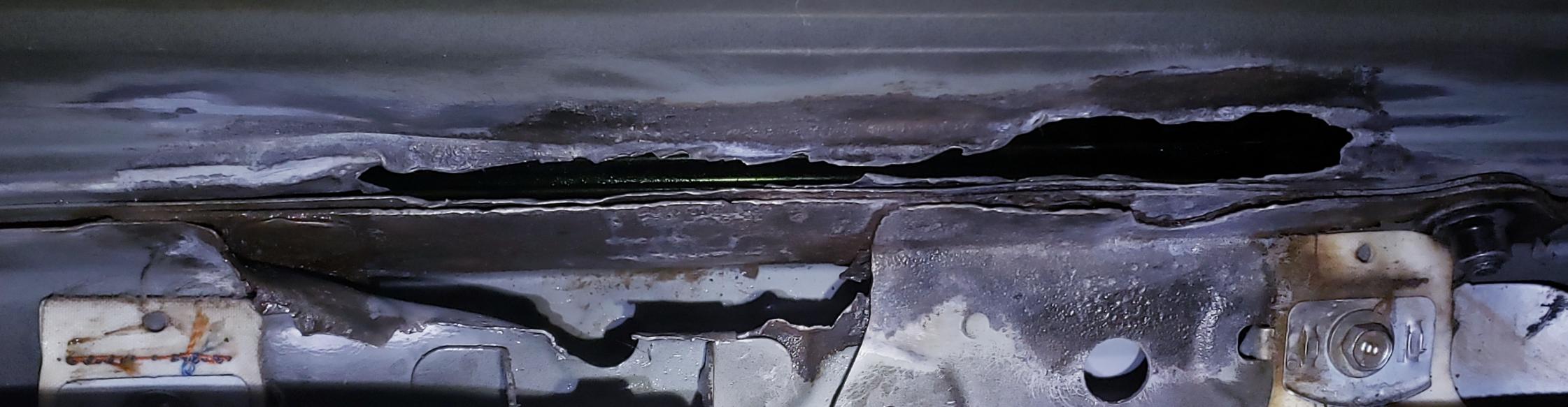

Destroyed Factory Roof Mounting Locations
I have to ask because I could not find anything on the net about silicone being bad for paint in regards to sealing a roof rack as example. I saw multiple web sites saying that modern paint contains silicone as it helps flow through the sprayers. Some car wax contains silicone, windshield sealant is silicone.
Do you have any links that show its actually harmful? I'm just wondering because as I've used it in many automotive sealant areas like adding grommets for exterior lighting etc. maybe I haven't kept the rigs long enough to see damage but I've never read anything bad about until now. Thanks!
Let's clarify: there are a lot of different kinds of sealants, there are a lot of different kinds of silicone, there are a lot of different kinds of silicone sealants. Some people use the words "silicone" and "sealant" interchangeably, even though not all sealants have silicone, and not all silicone products are sealants.
What I can't do is give you an exhaustive list of every kind of sealant that everyone has used to seal a roof rack, and whether or not they are compatible with paint, metal, weathering, UV exposure, etc. I caught some flak when I posted this to a Facebook group. Lots of people said "stop making blanket statements, I used XYZ sealant on my roof and it's fine". Sorry, but I would rather make blanket statements that encourage research and PREVENT accidents like this happening, even if I'm not being inclusive of exceptions.
Sure, some acetic silicone sealants appear to be corrosive to bare metal. However, my assertion isn't that the sealant corroded the metal in OP's roof. What I'm suggesting is that by using a sealant that cures and hardens (as well as removal/reinstallation of the rack without new sealing), it shrank back from the surfaces it was bonded to. This allowed moisture to creep into the joints and stagnate, causing runaway oxidation.
This is why I advise against using a sealant that cures and hardens (like most silicone sealants). Most silicone based sealants are not made for continuous exposure to the elements and sunshine (UV) that can make things very hard and brittle. Also, you have to consider that your vehicle roof goes through hugely dynamic situations like vibration, heat/cold cycles that expand and contract the sheetmetal, weight loading, etc.
Butyl rubber is what OEM applications use because it's a sealant that never cures. It can move with dynamic applications without losing its bond and seal. It's also fairly inert and easy to remove, even after years of service. Can you imagine chipping hardened silicone sealant off of your roof rack mounts in ten years?
By the way, your last example (windshield sealant): that's butyl rubber too :wink2:
Just wondering if you used the Oem bolts and rubber washers ? This is what my Oem rack came with.
I did not use the factory bolts the rack had its own set, which I think could have also been an issue
Got the areas cleaned and rust-free.

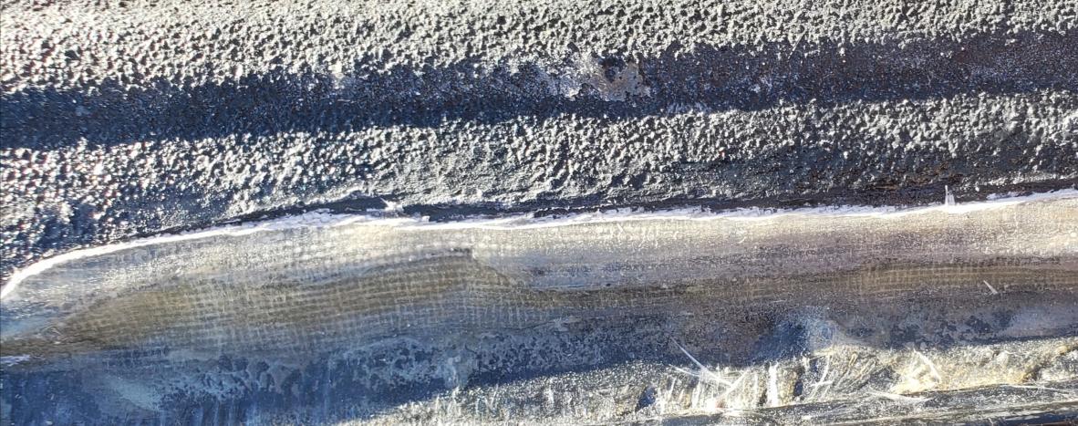

First attempt at fiberglassing the outside. It doesn't look pretty but it's sealed tight to the metal both on top of the roof and in the rail. I'll do the inside as well. Everything else will get a coat of POR-15.

This is why I don't want to mess with my roof rack or install a new one. The factory installed one is probably the best you can get at having proper sealing.
Don't count on it.
I've had several roof racks factory installed and every one has ended up rusting like the OP's roof. They were not 4 runners.
A couple things at play here.
The truck was left outside near the ocean, same as mine, less than a mile from the ocean. Salt air comes into play. It's a real problem.
The factory should seal protrusions properly, but I would not trust it.
On my list is to remove the factory install and reinstall it to what I feel is adequate. Hate to see a good 4 runner wasted needlessly.
The reason why there was no tell tale signs of intrusion is likely because the water once inside finds its way down the inside of the framework all the way down to the sills or rockers. On one of my vans the jacking point had rusted so thin that it collapsed under a jack but looked fine on the outside.
Another area to check is the hinge mounts for the rear hatch. That can get rusted from the inside from the roof rack leaks.
I did a lot of marine work and pretty standard in the industry is to use a 3M product called 5200. It's a marine grade sealant that works well under the water line on hull protrusions and does not leak. It must be properly applied in a process called "bedding" the attached parts. It seals both the mating surfaces and the hardware threads. Galvanic corrosion is really not an issue for something like this.
Repairing the damage with fiberglass is fine but you must realize that polyester resin is not waterproof, epoxy resin is and has a much higher adhesive strength.
Similarly regular automotive bondo is also polyester, not waterproof and also has poor adhesion.
Marine fairing compound looks just like the bondo, costs more, but also can be used below the waterline, commonly on aluminum hull yachts. You can't beat it off with a sledge hammer.
Lastly, I wouldn't use POR15, it can have problems with moisture creeping unnoticed underneath it, not worth the risk.
Again, in marine, IMRON is used, or any polyurethane 2 part paint, properly prepped and applied of course. Prepping constitutes cleaning the metal with phosphoric acid along with etching primers.
Just some food for thought
Best of luck with it. :usa2:

Just a guess but was the rack still in really good shape like not corroded at all? Was the metal of the rack directly touching the metal of the roof maybe where paint had worn off? Factory racks have a rubber or plastic spacer and I'm sure factory bolts are chosen specifically to avoid a dissimilar metals issue. Your rack I'm guessing did not have a spacer and or the hardware was a dissimilar metal. Again just guessing.
Galvanic action occurs when two electrochemically dissimilar metals are in contact and a conductive path occurs for electrons and ions to move from one metal to the other. One metal corrodes as its ions are deposited onto the other metal. ... Cathodes are noble, or stable, metals that are not prone to corrosion.
If I'm correct, your roof acted similar to a zinc anode on a boat prop shaft or the zinc outer coating of a galvanized steel beam. It sacrificed itself protecting your roof rack.
Listen to the above and the guy on page 1. Likely the main cause. I am in the coatings industry and you would not see that sort of corrosion from normal water and leakage. Not possible in that time frame.
Bad metal next to bad metal and you get what you get...

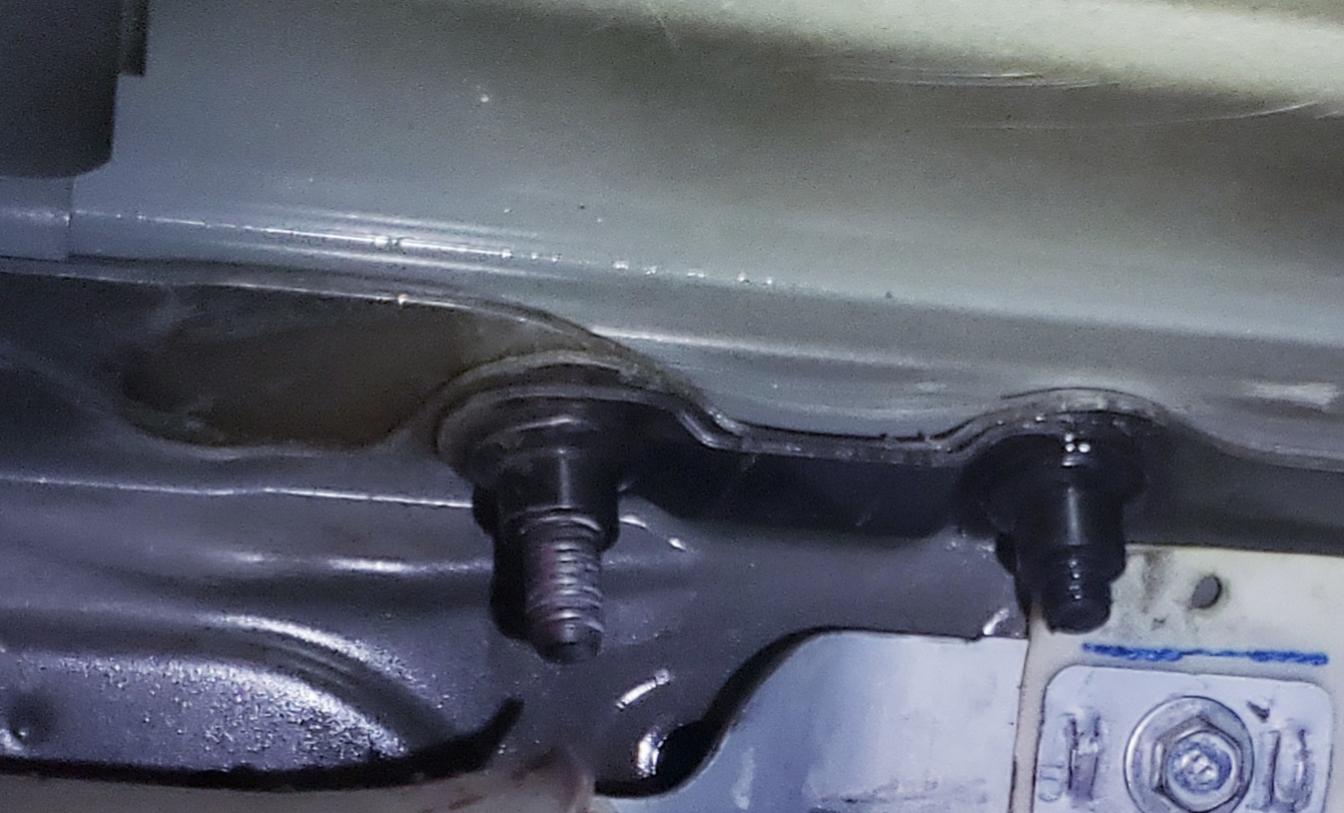

I started to see tiny rust spots popping up on the roof. Gobi Stealth rack. Took the rack off and found rust building up in the water drains as well. Not terrible yet. I am in Panhandle Florida near the coast and definitely have not washed my vehicle as often as I should. Also seeing rust on parts of the rack where the powder coat is chipped off.
Getting the roof repainted and will get a clear film or color match wrap on the roof for when I put the rack back on. Haven’t looked at the mounting points yet, still have the rack mounts in to prevent water damage until I get some OEM hardware. Definitely going to use the Butyl silicone.

First, my condolences to OP. This sucks pretty bad no matter how you look at it. However, I do believe it's repairable, but at what expense? Personally I would take it to a body shop and see what they say. They probably replace roofs all the time after hail storms. Estimates are free.
Also the root cause may not matter so much to OP, at this time, because the damage is done. The root cause is valuable to others that may see the same issue.
For the the non believers in galvanic corrosion, it's real. In this article, he states
The contact between two dissimilar metals frequently occurs in various situations in everyday life. An aluminum head on a cast iron block, zinc galvanized on a steel beam, solder on a copper pipe and steel fasteners in Aluzinc sheeting are just some common examples of different metals paired in constant contact.
Note that he say's zinc galvanized on a steel beam. Or in our case a zinc screw and steel body.
The OEM rack has a rubber piece under it called "End Support Insulator - Toyota (63487-35020)". They also isolate the aluminum frame from the body by using a support plastic bracket. Finally the hardware looks chrome not zinc plated.
We had our Frontrunner installed for less than a year and needed to pull it off. The Frontrunner (steel) spacers had started to rust pretty bad and was contacting the roof. I contacted Frontrunner about it with pictures and heard nothing back. Fast forward a few months and I see they now come with plastic spacer blocks instead of steel. In their defense, they sent me a set of plastic ones instead that we plan to install after removing the rack and taking care of any surface rust issues (if any are present).
In the world of mods 5th gen mods, the roof rack has been our most frustrating but is actually one of our most used. It ain't up there just for looks, but there's no free lunch.
Yes, galvanic corrosion is a real thing. No, it is not the primary reason this happened (root cause).
Galvanic corrosion can only take place in the presence of an electrolyte (in this case, stagnant rainwater and moisture). If the roof holes and hardware had been sealed correctly, it would not have corroded, galvanic or otherwise.
