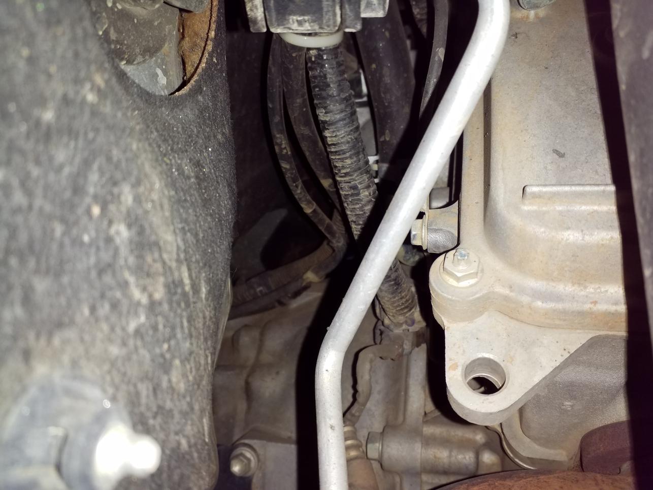

I have 2 lines on top of the trans in this picture.
Just feel above the trans where it meets the bell housing.
Transfer case, just feel on top of it. It is like a 1/4" hose with a tee going to, 2 different spots up there.
Sunday I can get under there and get pictures then to help you.
