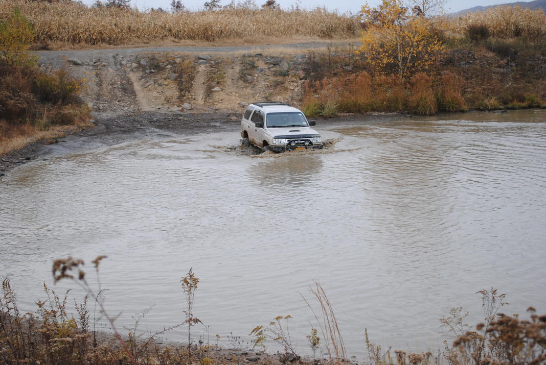

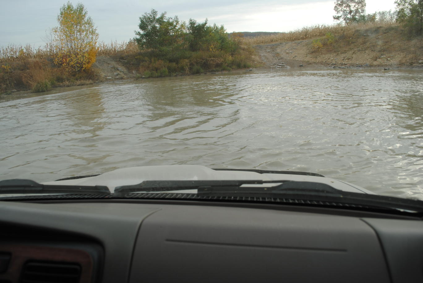

I never had a problem with the stock fan & water. :fish2:

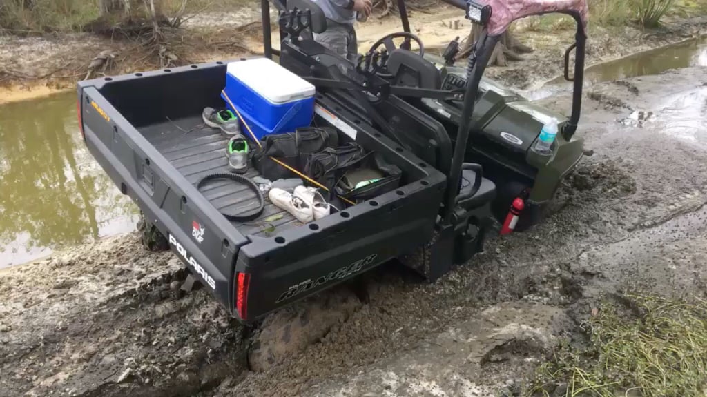

Yup, my Polaris Ranger has a switch that shuts down the fan...however, I always seem to forget to use it before going through water..[emoji30]

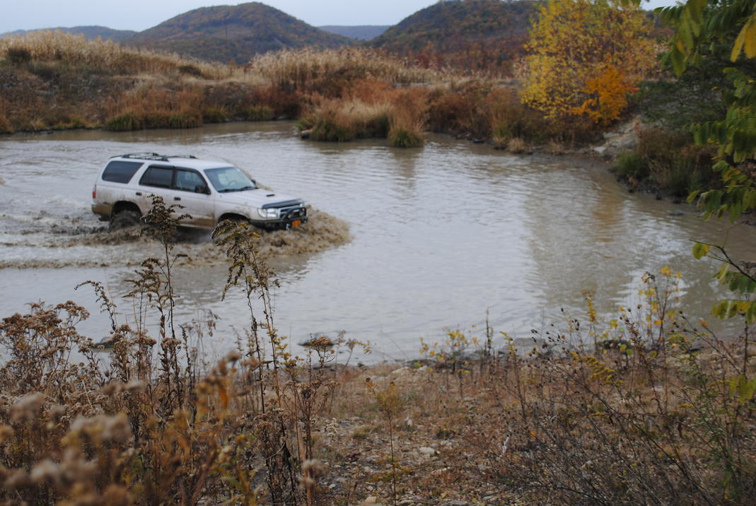

Rausch Creek? If so 10 ft to your left and your swamped.

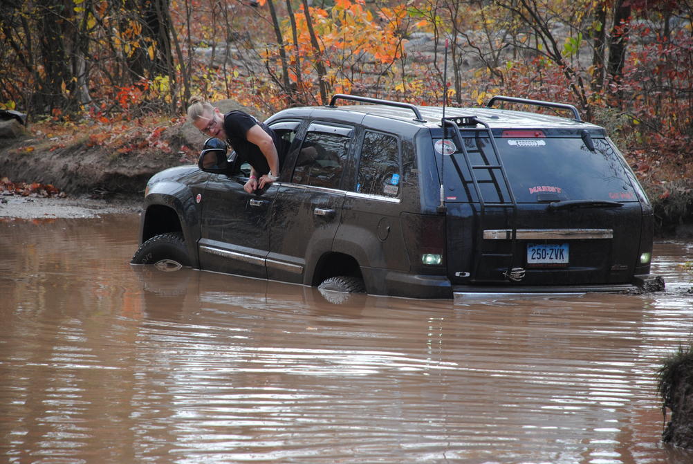

Yep, Rausch. There were 3 of us playing in there & none got stuck but we didnt go left like you said. There are no entrances to the pond on the left side thank God. I let the Cherokee go first, LOL

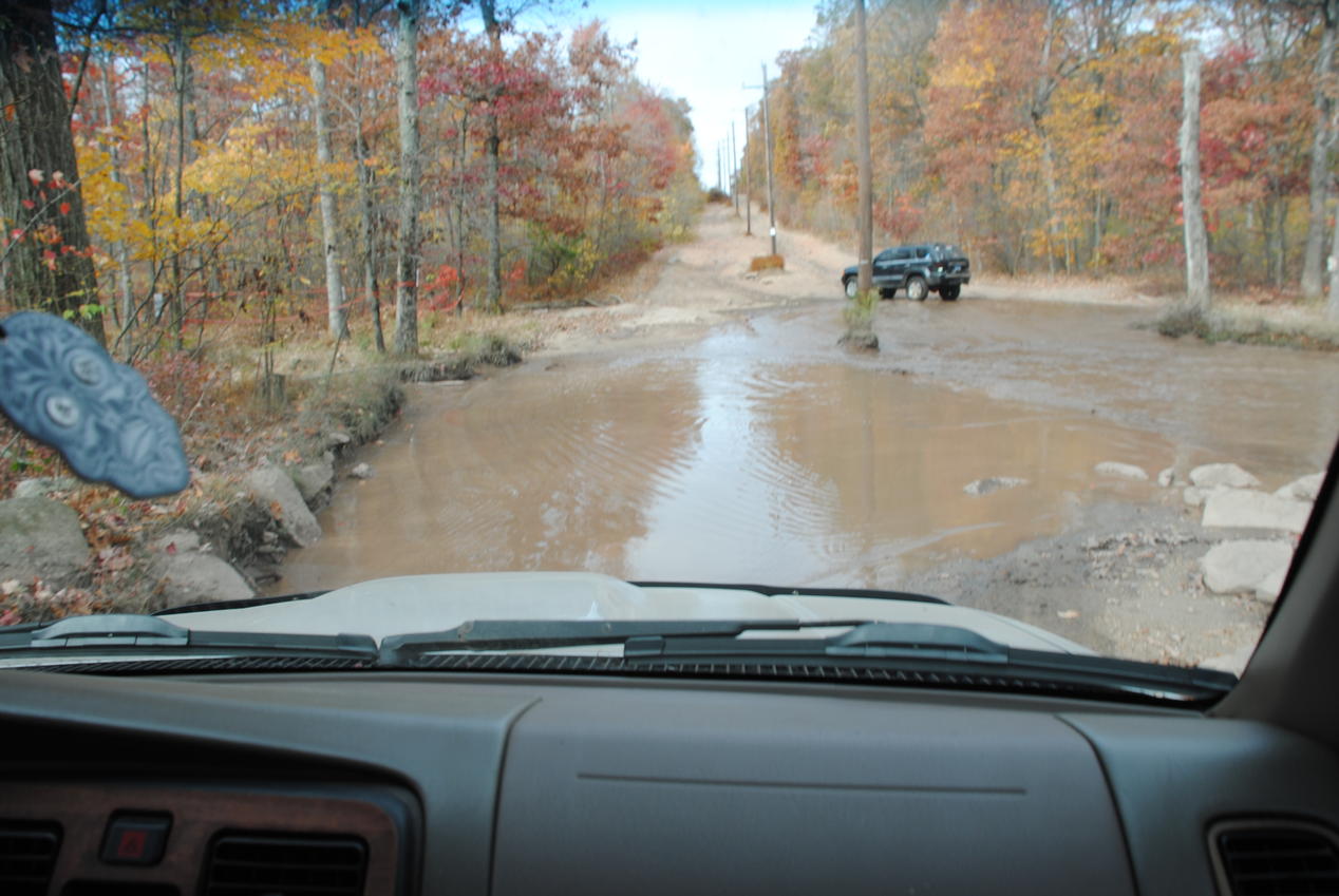

actually there was an exit to the left, glad i didnt go for it!

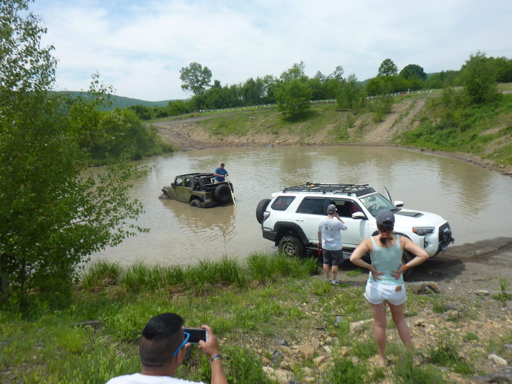

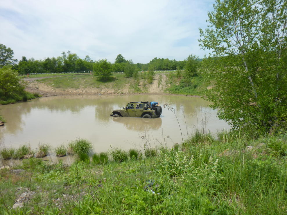

Yes you are. This jeep went second. He was shooting for that rampway. Was trying to show up all the 5th gen Runners. Had to be pulled out by one of them LOL.

LOL Ah, that's not that deep, it's a Jeep! LOL

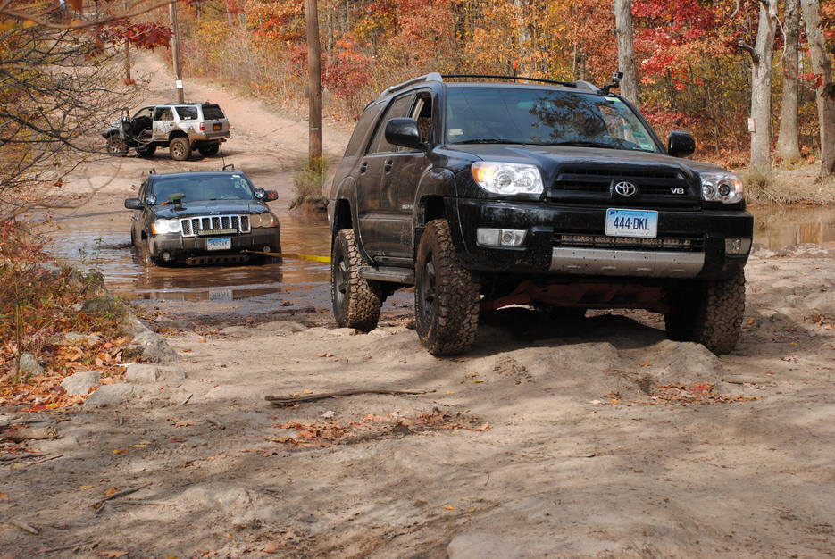

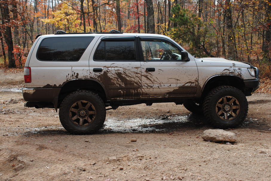

I have a 1" BL with 33" MT's.
I made it through here too & the Jeep got stuck. LOL
I let the V8 pull him out. LOL
A lot of times it's driver skill, I was in 4-low 1st gear & felt the rig slowing down from drag so I slapped it into 2nd & powered out.
