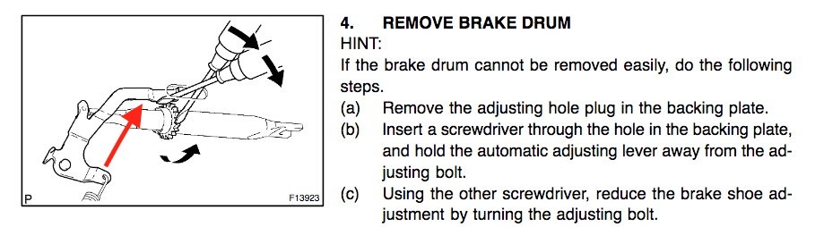

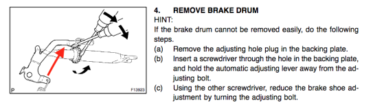

FWIW I angled a pocket screwdriver and was able to push the backside of the adjuster wheel down from a high angle to adjust it.
BTW - I just looked at the FSM again and realized that it actually shows you can "lift" the the adjuster lever away from the star wheel by levering a screwdriver against the bottom of the access hole, as opposed to "pushing" it away on the older style. I should have looked more closely the first time.
