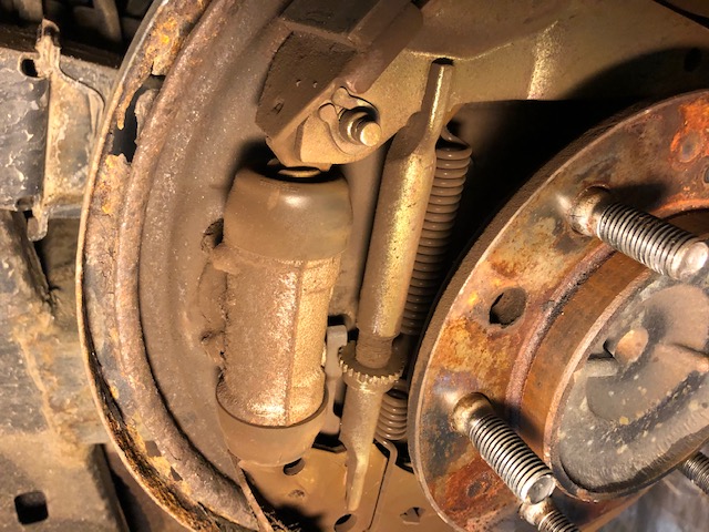

I was replacing the shoes on the rear drum brakes on my 2001 this morning (one side is soaked in gear oil), and noticed that things were quite a bit different than online tutorials I'd seen. For instance, in [MENTION=120071]mtbtim[/MENTION]'s video: https://www.youtube.com/watch?v=IJkVEBYSecs
It was only after getting most of the way through one side that I realized that maybe things are different in a non-functional way.
My setup has an adjusting lever on the back side of the rear shoe (see first pic), instead of on the front side of the forward shoe with the parking brake lever. This seems to be non-self-adjusting. I can't work out the way that the parking brake action would bump the adjusting wheel (?).
Additionally, there's a hole in my parking brake lever where I think a return spring should go (?), but there was no spring there on either side (see second pic). Also, there's no pin sticking off the adjuster set to guide the adjuster lever.

OP, I've seen your same set-up before helping someone with a rear axle seal job. It does appear you're missing the return spring though but I have seen the adjuster plate on the back side instead of the front side. I think this is how it came on your rig. I don't know for sure but I think for some reason Toyota uses a different adjuster style on some of the 3rd Gens. If you can upgrade to the style most of us have, which is the one in our video, that would be ideal.
I think you're missing some springs. Yours does not look the same as the pictures in that blog post. Here's what my 2001 looks like, yours should look the same. I see two springs on mine that I do not see on yours.
My bad, I should have said that I didn't put that long main return spring that stretches between the two shoes back, which has those two portions of spring coils you show. It's a little bit difficult to take off and put on, so that was the point where I stepped back and decided to post. :)
It looks though that maybe the 2001-2002 are different. Here are the ones from the video which are from a 1996-2000 (they showed opposite side).
On the back side there's a return spring that both keeps the parking brake lever and the adjuster lever (which are on the same shoe) pulled back when the brake cable isn't taut.
I think that we might both be missing our return springs on the parking brake lever. I think this one from [MENTION=7105]Scramble[/MENTION]'s Amazon link should go here? Or does it not need a return spring since no one seems to have it? :confused:
Even with that though, how does our adjuster actually move the star wheel when the parking brake is pulled? It's pretty obvious on the 1996-2000 how the adjuster lever bumps the star wheel when it takes a lot of motion to engage the brake, but I've got to think about whether the rear shoe movement would do that.

I have the same setup as OP, and also couldn’t figure out how the adjuster worked, but it does seem to work somehow because I was able the adjust the rear brakes by pulling the parking brake repeatedly.
Maybe I just had to yak about this a little, I should have never doubted the brake designer gods.
I took a closer look at the back side adjuster lever and now it's more apparent how it actually does the adjusting. The fork has an extra pusher surface that hits the adjuster lever and raises it up. The lever's spring pushing on the fork helps return the big parking brake lever so it doesn't stick. It's all hidden once everything's installed up.

Thanks for the post [MENTION=105603]skcolb[/MENTION]... Looks like have the same setup on my '02. R&R'd the e-brake bell cranks today (which were completely frozen up) and watched [MENTION=120071]mtbtim[/MENTION]'s rear brake shoe replacement video last night. When I pulled the drum this morning I thought my shoes were reversed.
pic is of passenger side...
One other thing I think worth mentioning is that with this setup you can't adjust the star wheel through the access hole in the backing plate using two screwdriver method since you would actually have to "pull" not push the adjusting lever away to spin the adjuster.
FWIW I angled a pocket screwdriver and was able to push the backside of the adjuster wheel down from a high angle to adjust it.
