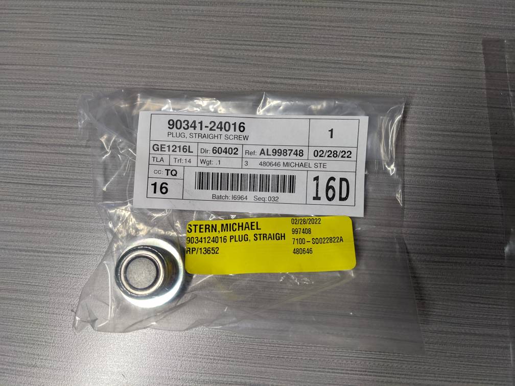

These worked for my 2000 4x4:
- Front diff fill plug: Lexus PN 9034118060
- Front diff drain plug: Lexus PN 9034124016
Got mine for $9.48
I don't see a need to change the fill at this time...
EDIT
90341-18060 comes up as a Toyota part and my local dealer has it for $7.26.... tempting
