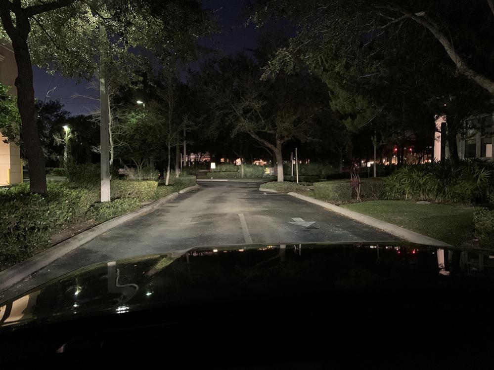

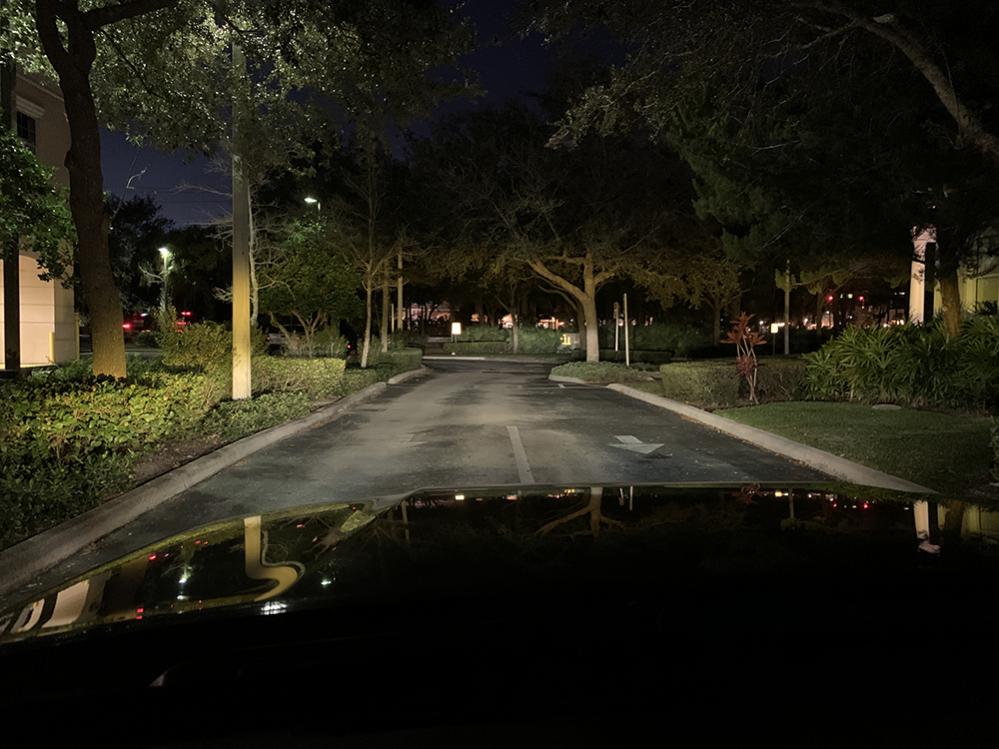

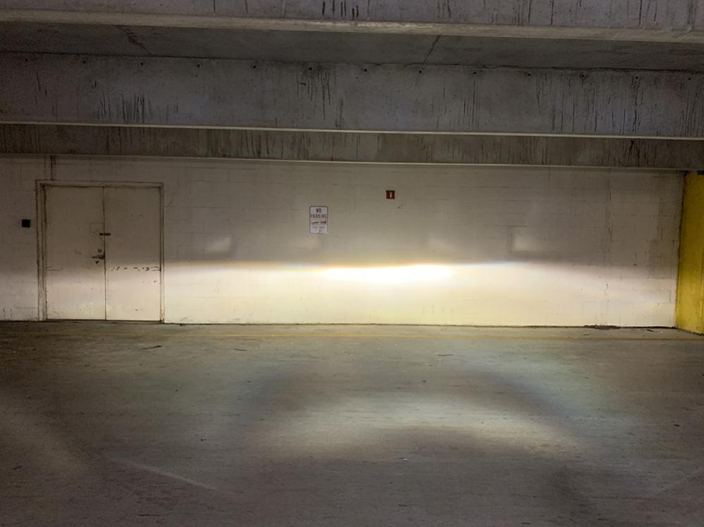

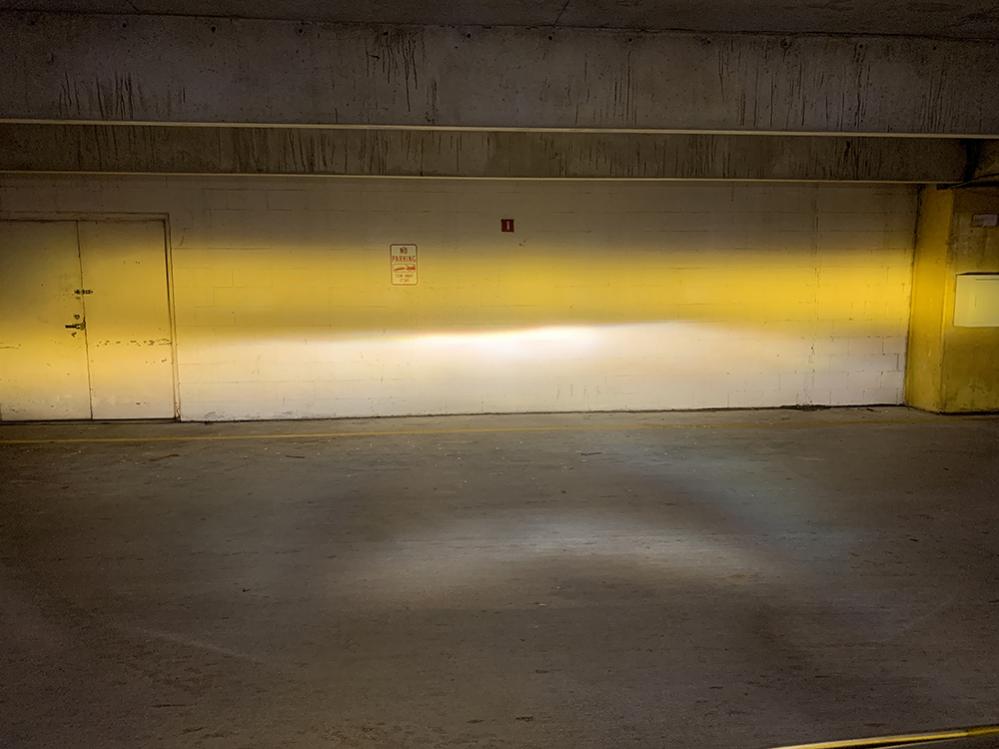

Installed my SS3 Sport Yellow Fogs yesterday on my Limited Edition.
The instructions say to reuse the factory mounting bracket, but it didn't look possible. The factory bracket has an adjustment screw that goes across the back of the light. But the new SS3's have a bunch of protruding heat sink fins coming off the back which wouldn't allow the factory bracket to attach.
So I used the new brackets supplied in the box. Everything went together easily, plug n play. But my fogs are showing up higher than my low beams and I don't have that adjustment screw anymore to move the lights.
At first I thought maybe I put the left one upside down on the right side and vice versa, but I called today and they said there is no left or right. So is there a way to adjust them that much to get the beam lower than the low beams? Isn't that where it should be?
I see a lot of info about aiming headlights at 28-33" from ground at 25ft, but haven't come across fog aiming recommendations.
The pics are with and without the fog lights on. One against a parking garage wall and one in a bank parking lot.
