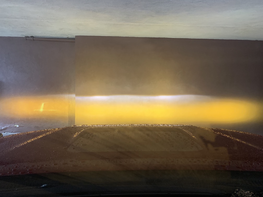

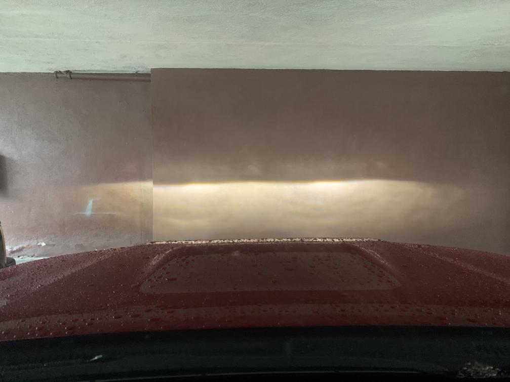

Just got these and they are bright! Even adjusted them as low as possible but when 'ON' it bleeds into the LED low beams. Don't know how it looks if I am oncoming traffic - hopefully I am not being a tool and blinding people. Will try and get some photos - sorry no before photos.

There's a proper procedure for aiming them- Measure from the ground to the center of the lamp (let's say it's 18"). Then park 25 feet away from a wall on flat ground. Subtract 4" from your lamp height (so 14" for this example) and mark that on the wall with a long piece of tape. The top of your fog light cutoffs should aim for the tape.
Cover or unplug your headlights if you need to see it more clearly, and aim the fog lights one at a time.
These don't use stock "click wheel" adjusters. Basically what I did was tighten the mounting brackets to the lamps until I could barely move them. Then, after mounting them in the bumper, I could aim them from the outside by pushing them very hard up and down. Good luck!

I could give that a try but I have it lowered down all the way to the point where I can't point them lower - the pod hits the bracket.
EDIT: I also have the bracket pulled as far back as it physically could.

If they're not low enough and the pod is hitting the bracket, pulling them forward should give you a bit more room. If they're hitting the bezel, then you can push them back.
Aiming is important, good luck!

Thanks I'll keep playing around with it. In the mean time, here are some photos with fog pods off and on (daytime)
