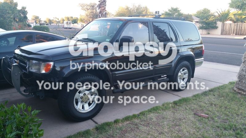

So I saw this 97 limited pop up on craigs and made a the decision to throw the newly acquired 1st gen up for quick sale in order to buy the 97. Needless to say I am now the owner of this sweet thang :bounce:
The amazing thing is that I was able to pick this thing up for about $700 cheaper than I sold the 86 for, which is awesome.

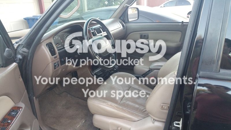

She has a mere 276k miles on her and is in need of some maintenance items here and there. However for the most part she is pretty darn clean and has working a/c, 4x4 and rear diff lock :laugh:
The interior is pretty clean and overall it is just a pretty darn solid truck, especially for the price :humble:

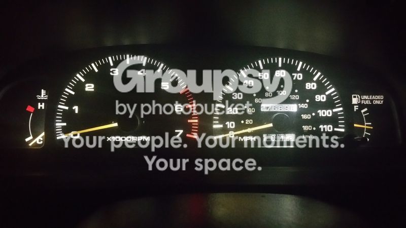

I then remembered that I had ordered some LEDs for my last 4runner that I never got around to using, I lucked out and they worked for my dash :bounce:
I now need to order the rest

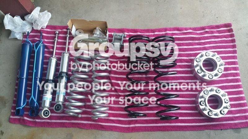

Collected all the parts for the lift slowly but surely in order to save money as I was trying to go for the whole budget thing...:hippie:
However after collecting about half of the parts used I decided to buy the front lift stuff new from toytec, as well as the diff drop, panhard drop, and rear LC shocks.

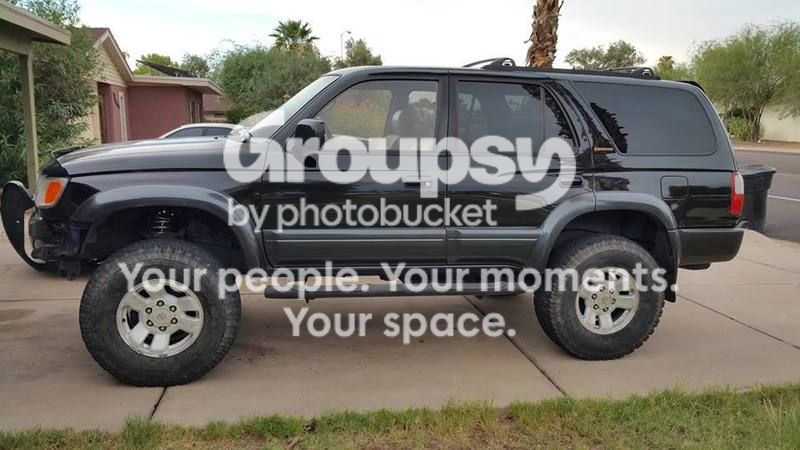

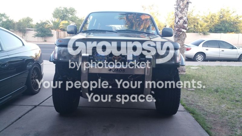

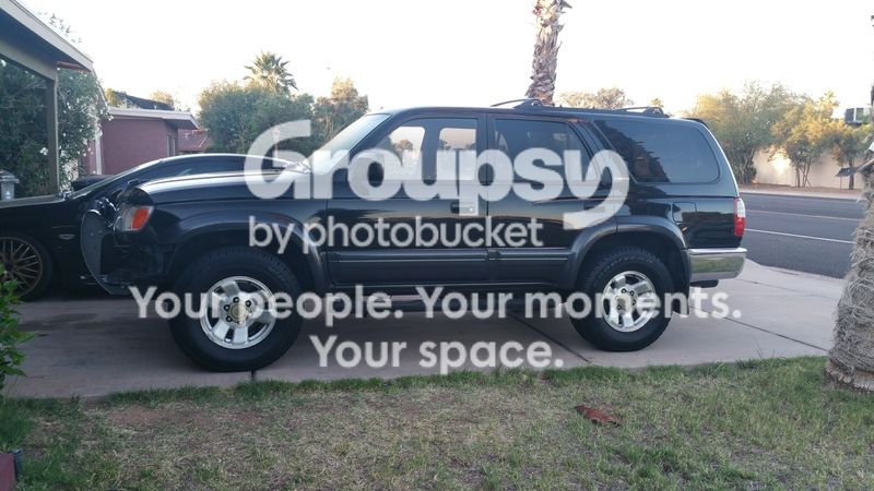

Here is everything installed. I NEED to figure out something for the front bumper. I have no front bumper at all so it does not ride the greatest.
And I am not sure that's why the front is sitting so high.

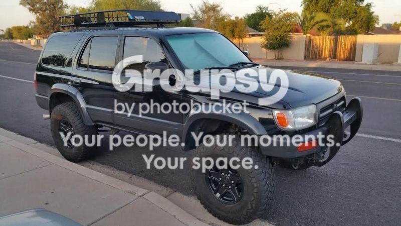

I am thinking about doing a body lift here soon so I can go to 35s. It seems that 35x12.5r16 are much more common than 33s. I cannot find any decent used setups. Might try and switch to 17s as well, I missed my chance at picking up some sequoia 17s the other day :(
Anyways that is all to report at the moment I will keep documenting as things progress.
Looks good. What perch did you set the bilstein 5100's to? Make sure that your hub to fender measurement is no more than 23" (~3" of lift). Otherwise you will have a ton of problems with your front end. This could also explain the poor ride quality. I've found 22.5" hub to fender to be the sweet spot for the bilstein 5100's. Any more than that and you will have next to no down-travel, meaning that your tires will not be able to drop into depressions in the road properly.
I have a plate bumper, winch and skid plates. I have my tundra bilstein 5100's set at the middle perch (3/5) and its giving me the aforementioned 22.5" hub to fender height and rides well on and off road. With no front end weight, I'd recommend the 2nd perch.
Good call, Brandon
I went and measured and I am at 24" up front
I am not sure what I want to do at this point, I am on the second setting on the 5100s at the moment and do not want to go down to the first and end up being too low up front with the bumper installed.
I am going to let it settle for a little and add some weight up front before I take it apart again. I do not feel like going back out there to take it apart :mad: it's pretty hot here in AZ and not fun doing manual labor outside haha.
Got it aligned today....jeez was that fun driving this thing unaligned
The guy said he had a hard time getting it aligned due to the lift. They spent 2 1/2 hours trying to align it :noidea:
Either way it seems MUCH better now.
