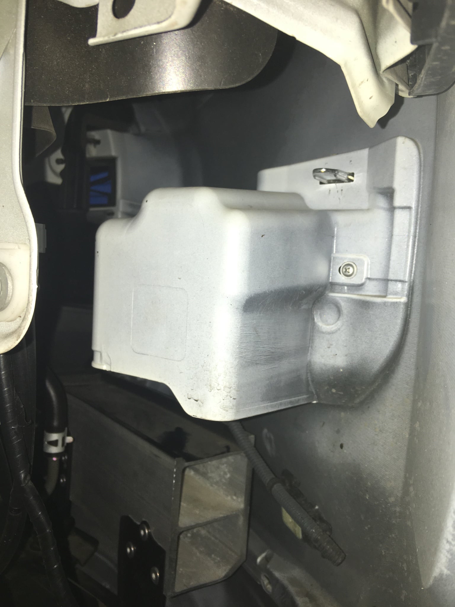

A little help! I've got a 2016 limited This is what I'm seeing. Not sure what to remove.
2016 limited: Just wanted to provide an update. The passenger side is exactly how it was described earlier in this thread. There are 3 silver tabs with white clips in them and can be removed relatively easily from under the car by removing the fender flashing. I tried using the factory bracket, but broke the the leveling screw in doing so. Don't see how it's possible to remove the factory fog light with out breaking it. Either way, even with the factory bracket, it did not sit flush so I used the one provided. I did not do any trimming of the brackets and felt it looked fine.
For the driver side you can only remove one clip from under the car, and the other two can be accessed from the top. Just remove the plastic covering the top front portion of the Engine, and you will see one of the clips. The other clip is just above that one.

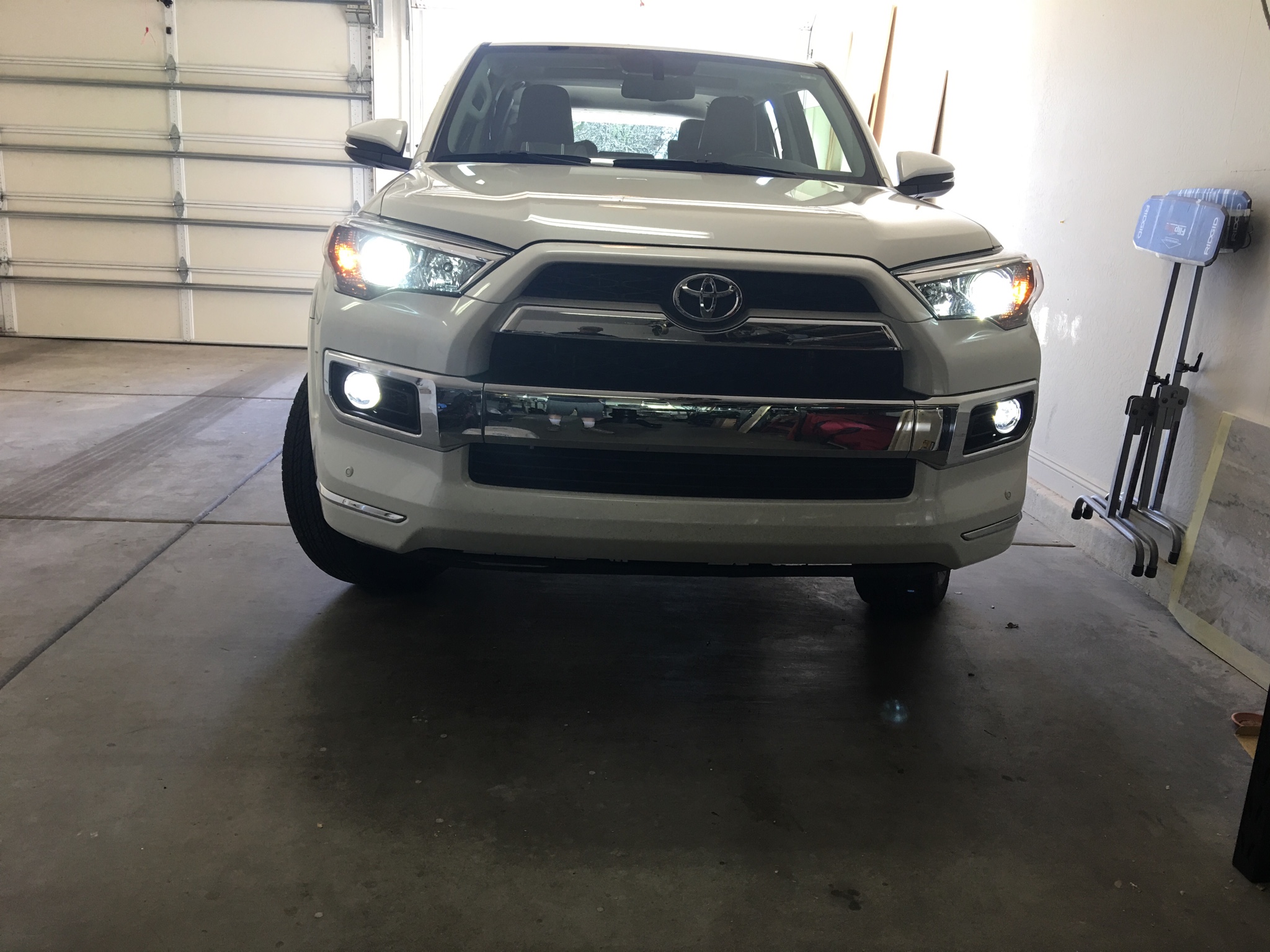

Here's a pic all done up. The lows are XDdepot HID KIT with the 4300 Philips bulbs. Might swap these out for a 5500

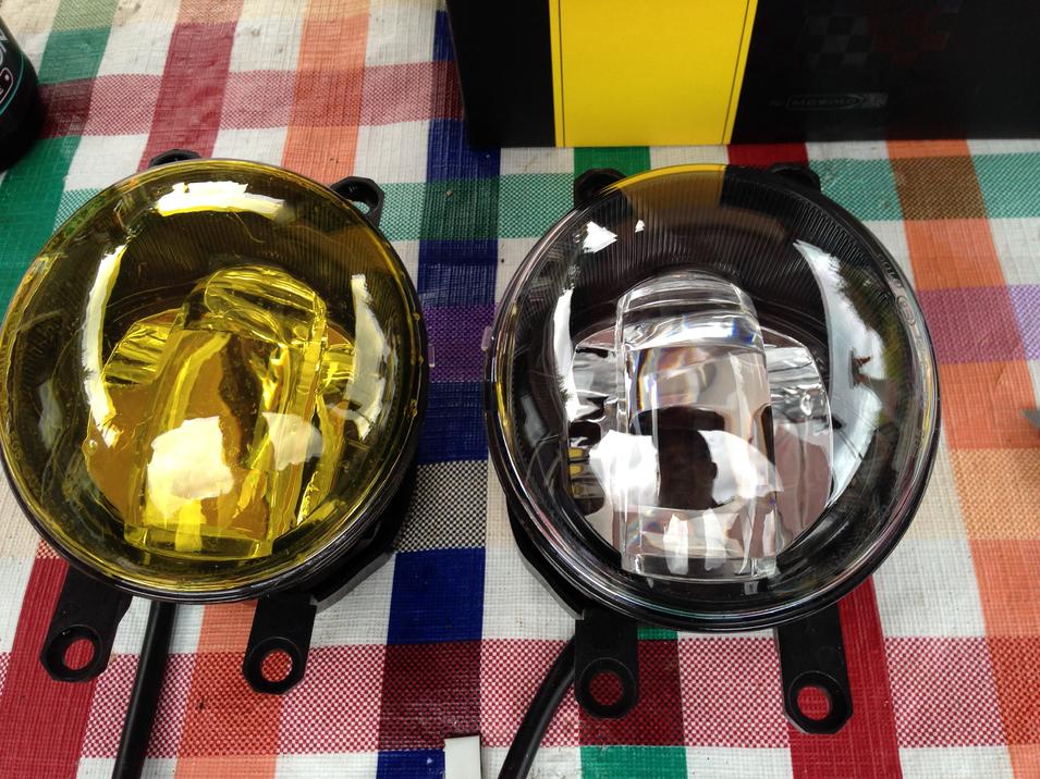

Anyone have a picture of the yellow laminX version? Is it a cover you can take on and off or is it a permanent painted lens? I'm trying to decide which color to go with.

The laminx is just a colored film you put over the lens. You can remove it when you want but cant reapply. I have them on my stock fogs.

Here's a close up pic for you. It's a thick yellow film that sticks over the lens.
Thanks for the close up pic, made the decision easy to try these out.

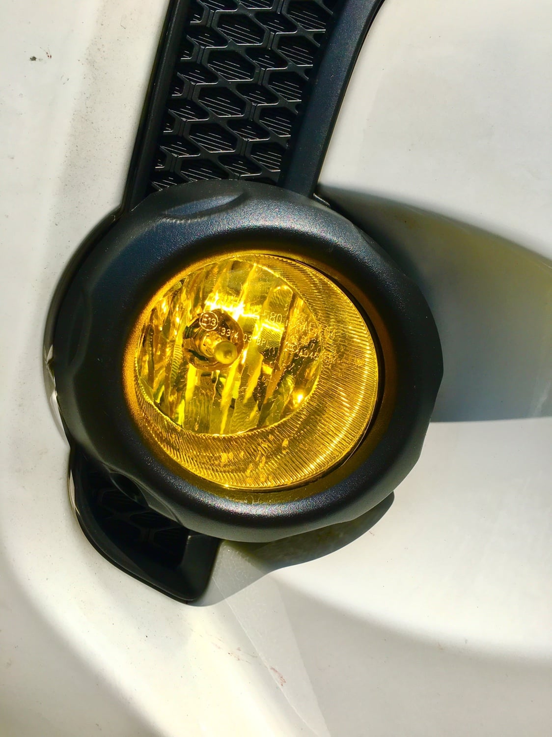

You may want to do a fog light bulb upgrade at the same time as installing the Lamin-X.
I found the near useless factory fog light bulb was completely useless after I installed the Lamin-X.
I installed the Phillips LED bulbs for a noticeable improvement over the factory bulb, let alone the factory bulb with Lamin-x...

Thanks [MENTION=201719]Magnetic[/MENTION], I had purchased the bulbs first because of exactly what you said...poor lighting from the dogs and arguably the whole 4runner lighting system (have also upgraded interior lights to LED) but as soon as I saw your close up, the decision to go with the amber cover was made. Thanks again for our post !

I totally agree. Upgrading the factory bulb is a must. I purchased a yellow LED bulb, which made for a deeper yellow color when it's on.
