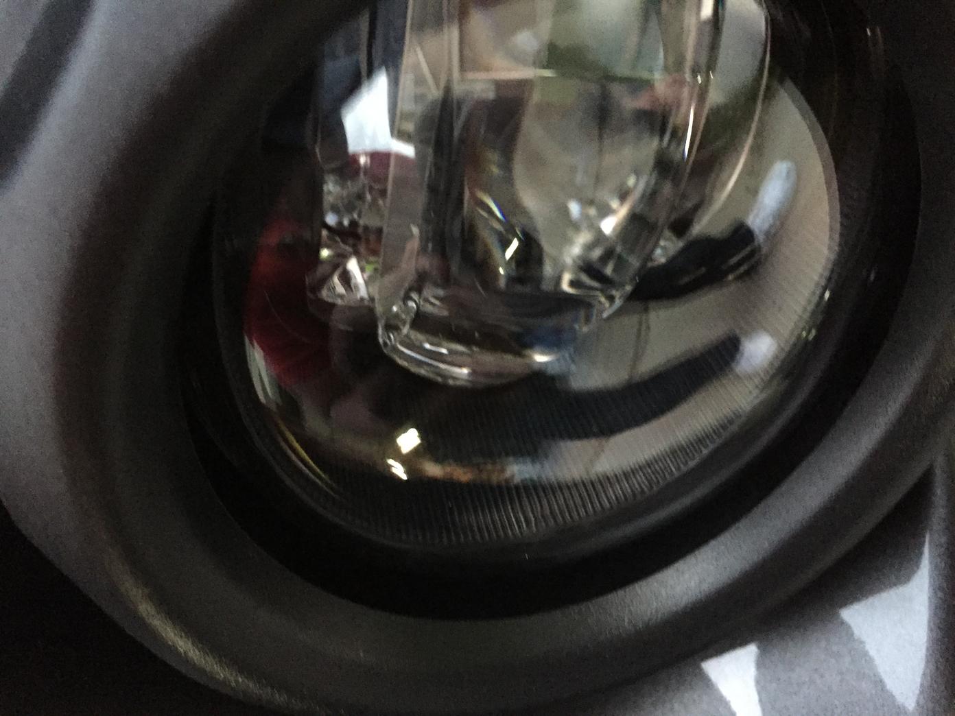

Not fitting flush
I can tell by some of the pictures that the Morimoto's don't fit flush (see pic) as the stock ones do. Has anyone figured out a way to install it better? also if not has anyone encountered any issues from water seepage due to that gap there?
I know that some that have replaced their OEM fogs with the Morimoto's (I'm sure it is in one of the posts in this thread) actually took their OEM light assembly out of the adjustment fixture, removed the Morimoto's from it's adjustment fixture, and placed the Morimoto LED's within the OEM adjustment fixture. Supposedly it fit like a charm and worked normally.
The second part of your statement / question.... "has anyone encountered any issues from water seepage due to that gap there?"
The Morimoto is a sealed light fixture. So is the front portion of the OEM fog light... they are both mounted from the rear and the front bezel is not a sealing fixture of any type...
So you don't have to worry because your question does not apply!
