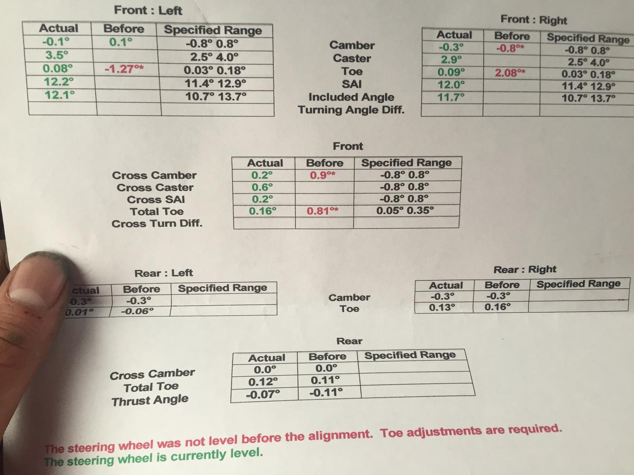

Boom much better. Fixed my handling issues. That ball joint sucks to beat out. Not sure why the left is much higher caster but no complaints how she drives

Just giving an update. I have maybe a few hundred miles on them but no squeaks from the uniball or bushings. I know that was a common thing with other uniball uca.

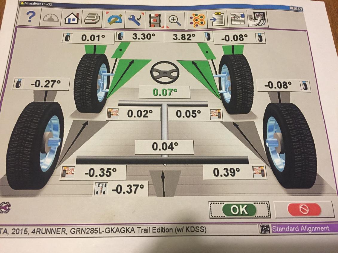

A bit more feedback for the dirt king UCAs,
I got a great alignment, now the 4Runner handles better than ever before. Tracks beautifully on the highway.
The tech did a great job. He mentioned that 4 degrees was certainly possible, and to return if I wasn't satisfied with the handling.
