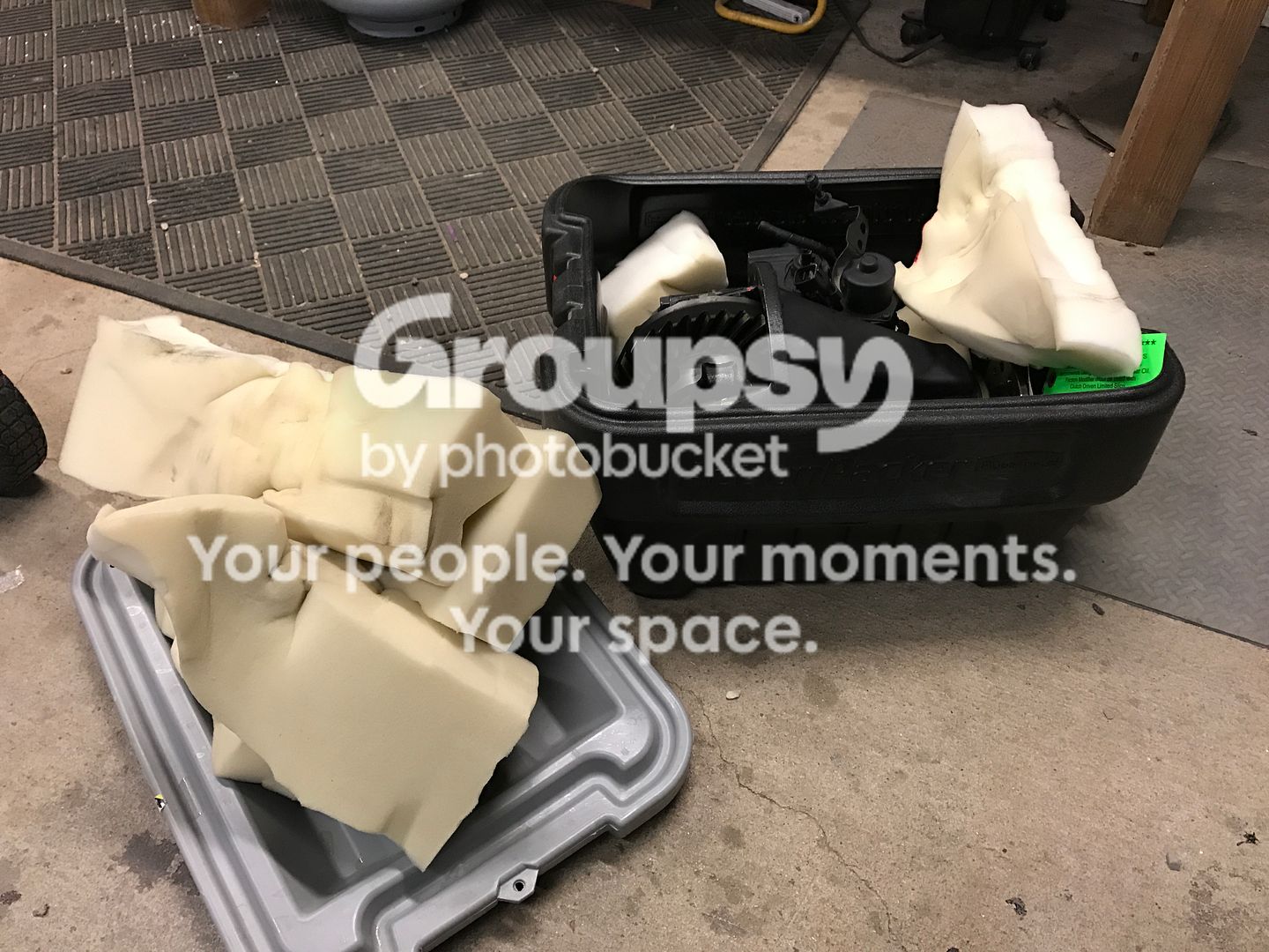

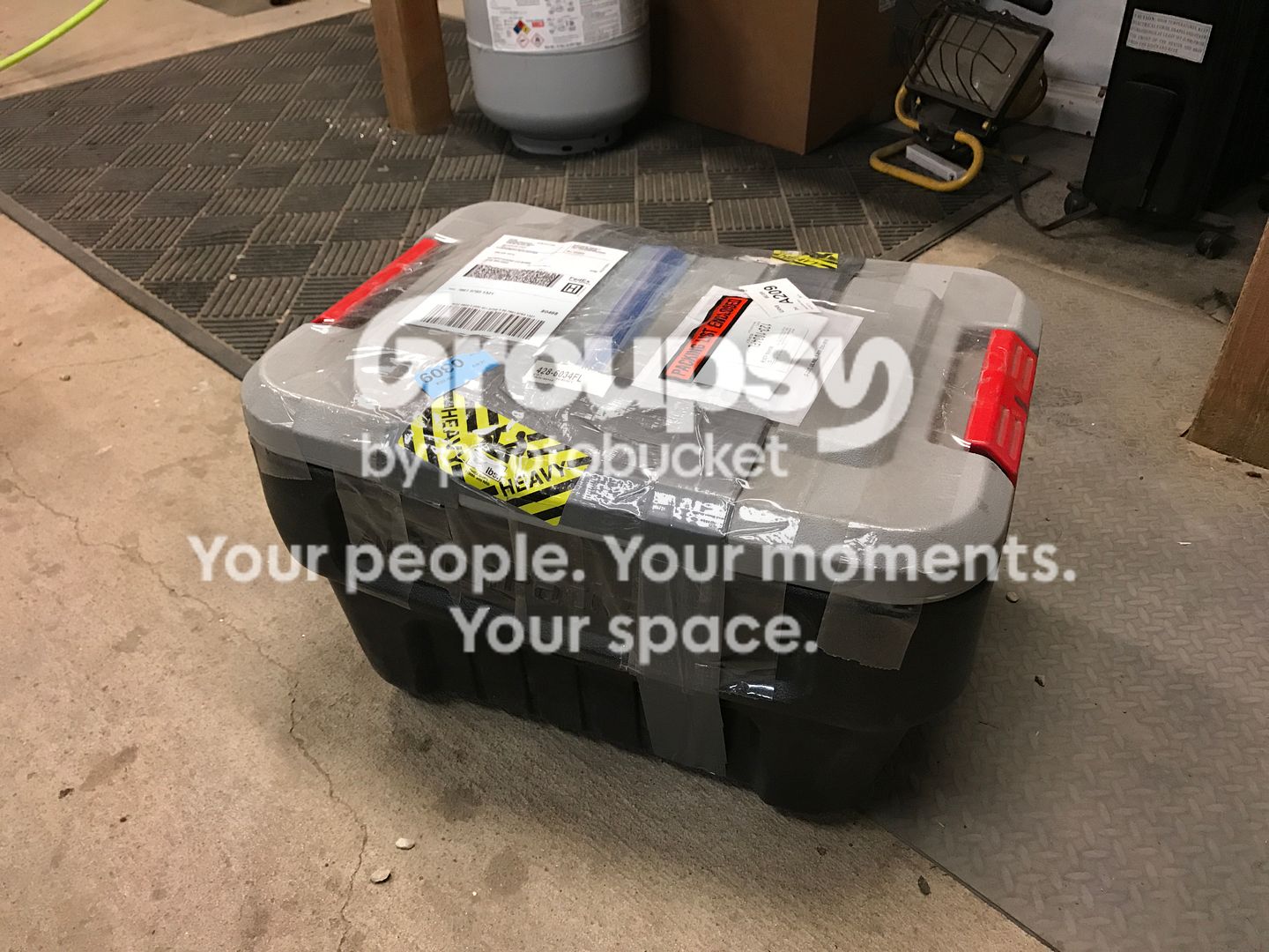

So how exactly do you ship a 73 pound diff across America twice? Action Packer to the rescue! It held up great, and the built in handles made it easier to move around than a regular box.
I packed it with scraps of foam from my new sleep platform.

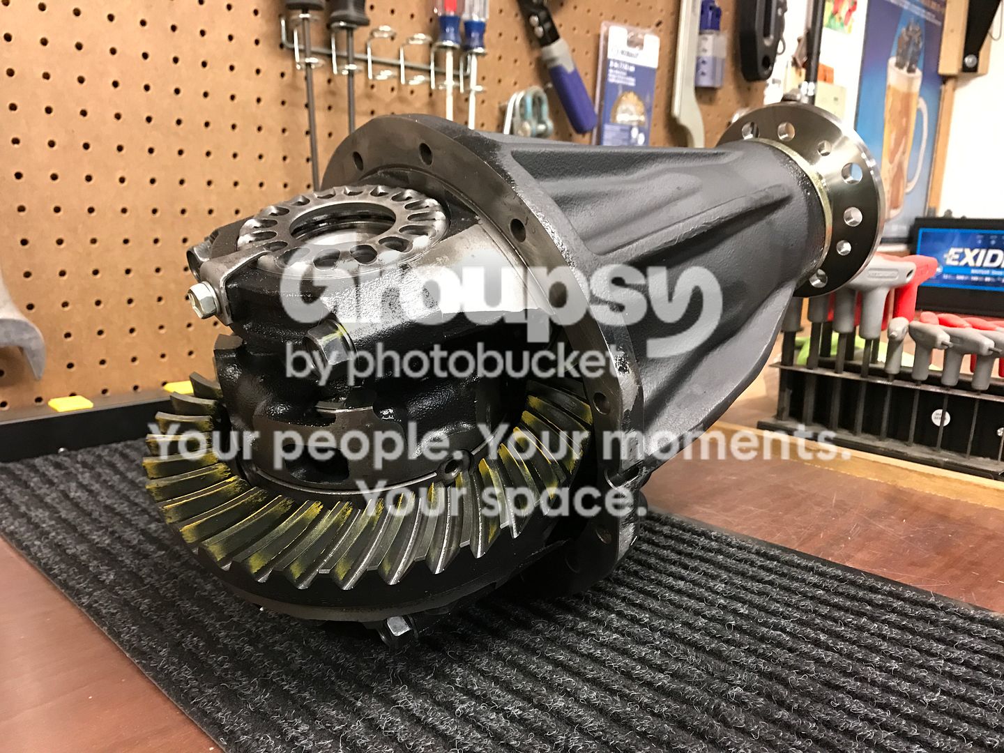

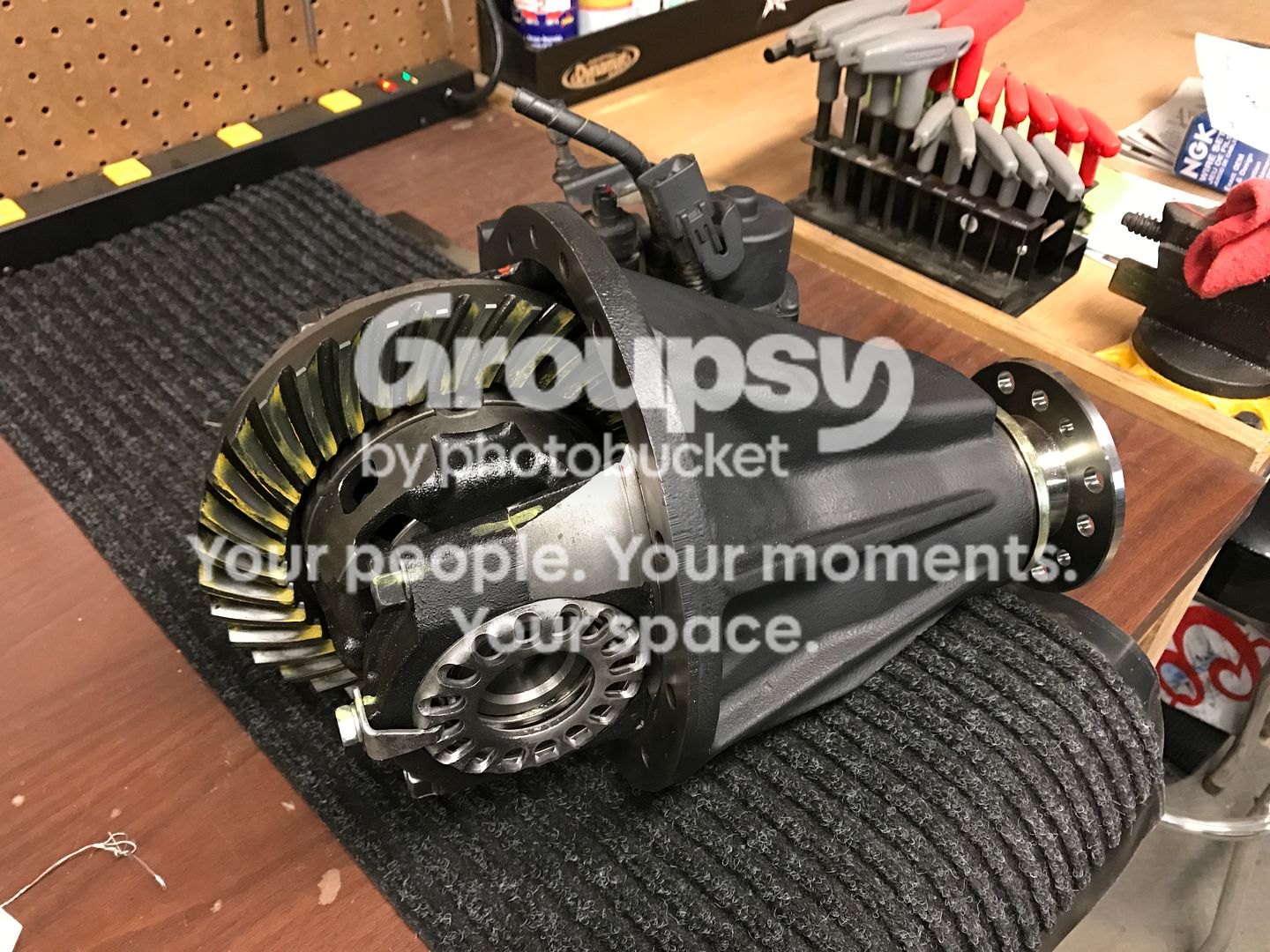

Here it is, I just need to get it back in the 4Runner.
And this was no in the door, out the door job. They even took the time to file off the rock rash on the bottom of the housing for a nice, and leak free fit! I had planned on doing it once I got it back, but they beat me to it. :D
