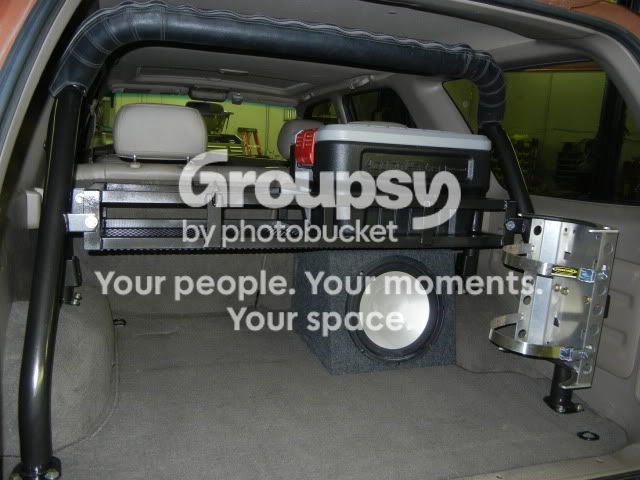

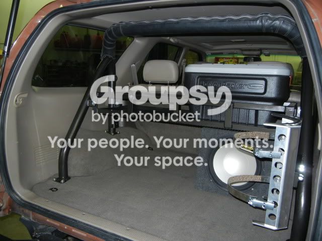

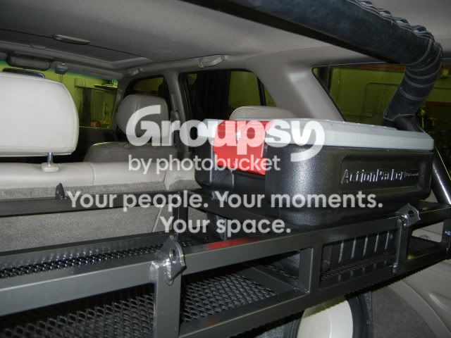

I decided to build a removable rack that will bolt to the roll bar and hold two Action Packers above the subwoofer box along with my Hi-Lift, it will have expanded steel on the bottom.

More progress
DSCN0961.jpg~original
DSCN0960.jpg~original
Bolted in place
DSCN0959.jpg~original
Action Packer in place

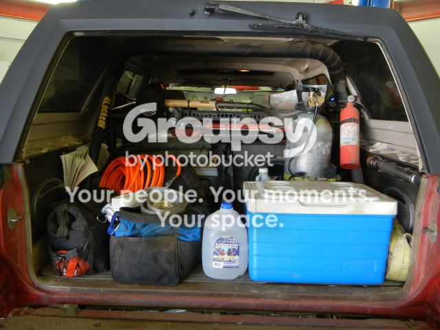

I wanted to get the cargo area wrapped up, so I went through all my gear/tools and got them organized.
I also got my Hi-lift jack installed in it’s new home. I always pull the base off them (that’s what makes all the rattling noise), it’s in one of the Action Packers.

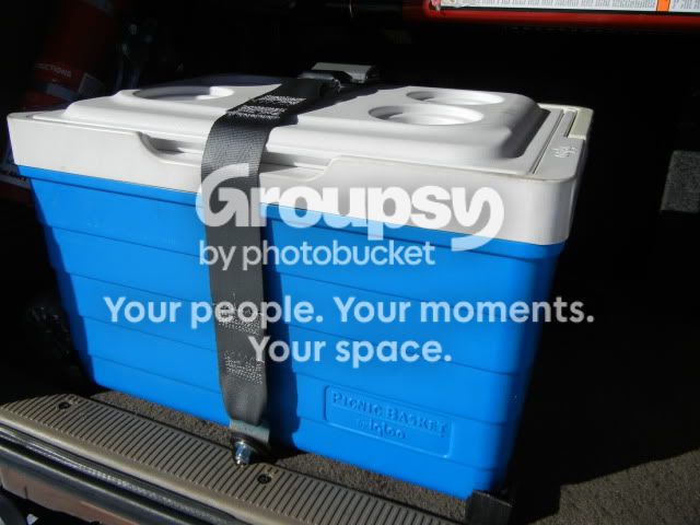

I needed to find a way to secure my cooler, so I made some stops to hold it in place and used a seatbelt to hold the cooler down. It makes it quick and easy to get inside, and it keeps the cooler from sliding around.
