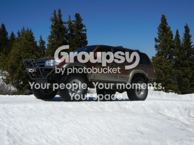

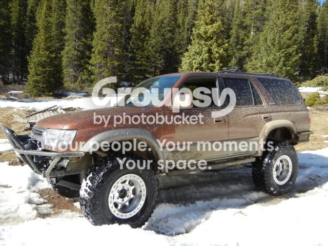

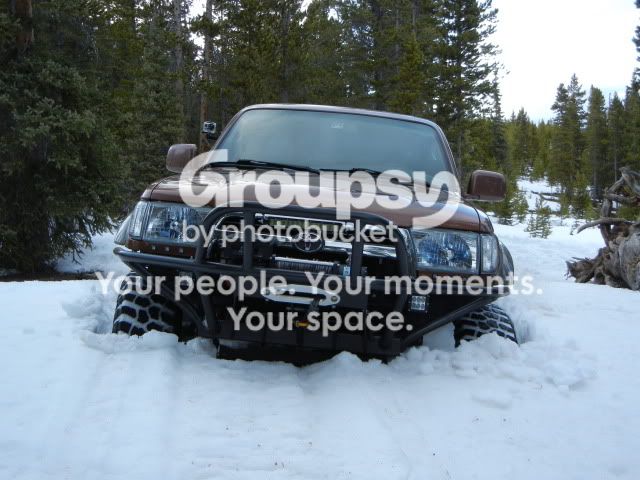

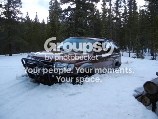

I took the KM2’s out for a trial snow run after work the other day. It’s been a horrible year for snow, and it really showed once I got out on the trail. The conditions are more like the end of May or early June. I still found some deeper snow on a couple side trails and the KM2’s seemed to work great. They hooked up really good; the snow was super wet and slushy but they still pulled through it. I do feel the MTR’s floated on top of the snow better, but it’s too early to tell for sure.
I was making great progress until I got greedy; gave it a little too much throttle and slipped the tires, once I spun the tires I was stuck and had to winch out. It was still fun!

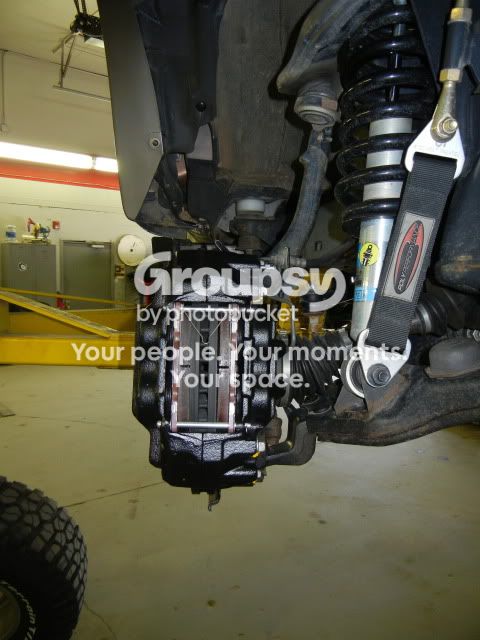

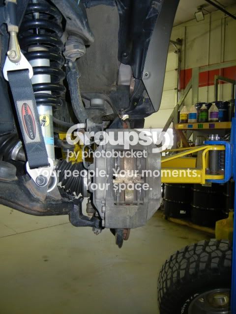

I finally got around to doing the Tundra brake swap! A big thanks goes out to BFAD for his write up, it defiantly took all the mystery out of the process. :D
http://www.toyota-4runner.org/3rd-g...ements-231mm-13wl-tundra-calipers-rotors.html
Before –
DSCN1199.jpg~original
After –
DSCN1200.jpg~original
My old stock brakes were shot (35’s and heavy beadlock wheels will do that), the rotors had started to warp, and even before that I felt uneasy coming down a big hill toward a stoplight. There just wasn’t enough braking power for the wheels and tires.

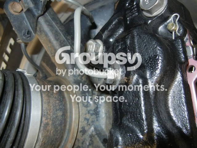

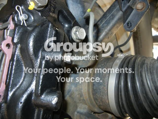

Everything went smooth for the most part, but I did run into one problem. I bought two calipers from Napa and I started on the passenger side. It went great, no issue’s, just your typical brake job with a little trimming. I moved over to the driver side, attached the brake line to the caliper, and what would you know, big problem. I tightened the brake line down and it bottomed out on the caliper, but the flared end of the hard line still had 1/8”+ of play inside the caliper. For the hell of it I unclamped the brake line and it leaked brake fluid like crazy. I took it all apart and measured the thread depth to the flared surface inside the caliper, and it was way too deep.
It took me a week to get these calipers, so exchanging it for another one wasn’t much of an option unless I downed the 4Runner for a week, or reinstalled all the stock stuff and re-bled the brakes. I figured it was worth a shot to fix this one; so plugged the hole, took a good 1/8” (or more) off the caliper, reamed it, and chased the threads. The fix worked great and it’s not leaking. So far the brakes feel great; the 4Runner actually wants to stop and I don’t get that horrible feeling when I see a stop light change red in front of me. The brake pedal does have more travel to it, but once they start working they work good. I’m going to re-bleed them and see if that helps at all, along with checking the adjustment of the rear shoes.

Congrats on the upgrade. I think they will be a huge benefit to you & your truck considering the setup overall. I wonder how the hole for the brake line ended up like that?
One thing I might do if I were you, and if I were to do it over, is hit those big bolt heads on the calipers with some paint (black, or whatever you like). Mine have already rusted up to a nice orange/brown color and that's down here in NM where they saw minimal moisture/salt.
It sucks to have brand new brakes w/ugly rusty bolts.
Must be nice to have access to a post lift whenever you're working and needs the truck off the floor. Congrats on the brake upgrade, too!
Nice work, great upgrade. Definitely check your rear brake adjustment, as they are heavily biased towards the front from the factory before they are even worn down. Just a little more help from the rear can provide better pedal feel and considerably more life from the front parts.
Ain't it a world of difference!! Stops on a dime, even with the 35s :D
So much better! :D
I have a feeling that the casting is new, and not reman'ed (or it's a reman that they machined to repair some damage?). I also noticed the threads were very sharp and had never been used before; there was some metal debris from the two surfaces threading together for the first time (it was not cross threaded), and the hole seemed to be drilled at very slight angle off of the other side. It just didn't seem right.
Thanks for the heads up on the bolts! Once I know these calipers work good, and there are no issue's with them, I'll hit them with some black paint. I'm a little leery after seeing the job they did on the brake line fitting but so far it's working fine.
Thanks man! It's very nice to have access to a lift, defiantly a perk of the job! :)
Thanks for the input! Your 100% right, I've noticed that on all my Toyota's. I try to adjust the rear shoes on a regular basis, the automatic adjustment just doesn't seem to keep up. It makes a huge difference in pedal feel and stopping power.

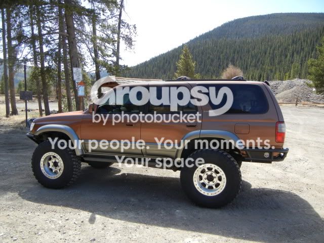

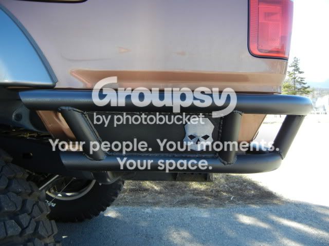

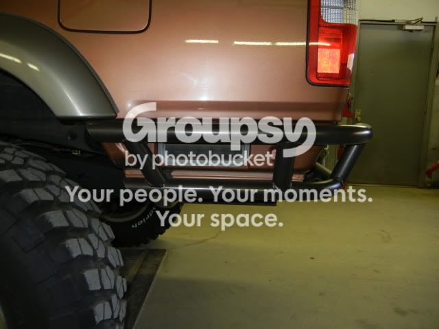

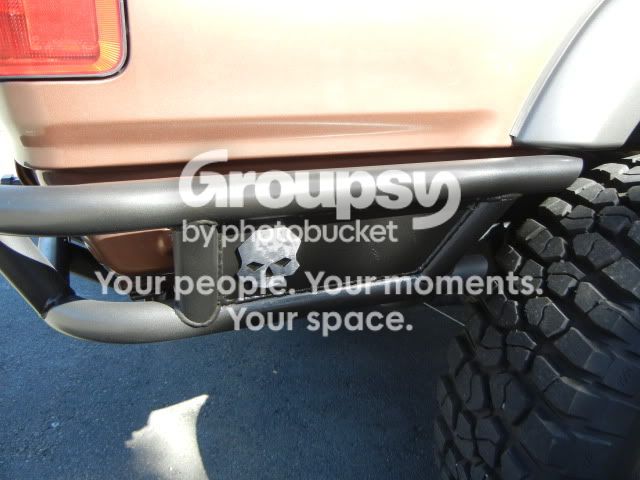

There is one thing that has been bothering me about the rear bumper…
DSCN1204.jpg~original
I hated how visible the “Interior pressure equalization vent” (or whatever it’s called) was, and when I had the old Turbo 4Runner there was a few times when rocks, sticks, etc worked their way into the opening. I decided to cap off the main opening with some 1/8” plate, but it looked “blah” once I had it welded in place. I could have drilled some holes in it, but that would have defeated the purpose of the plate. I found a couple Ballistic Fab weld-on skulls that I had in my toolbox, so I figured I would give them a shot; I hit them with a Roloc disc and then clear coated them. It’s a little cheesy, but they break up the panel really well and match the wheels. I can always paint them the same color as the bumper if I decide I don’t like them.
DSCN1206.jpg~original
DSCN1205.jpg~original
DSCN1207.jpg~original
The panels with the skulls are pretty cool! I like it. If it was mine, I'd put an AR-15 bolt face logo there or something, since I'm into that stuff. You could also put TRD right there if you could come up with some steel letters in the correct font. But the skulls are cool...maybe just a little too edgy for me if it was my truck.
Yeah, I'm still undecided about them. My last 4Runner had spider webs, skulls, and spikes integrated into the tube work. It looked awesome on that truck, but this one is so clean that I don't know what to think. I like the idea of the panels; they really needed to be added, but they need something else to break up the "blah". The TRD would be pretty cool, any other idea's?

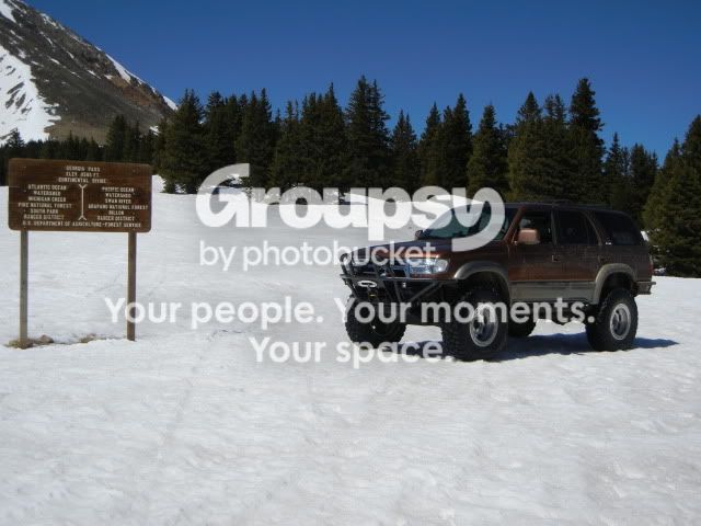

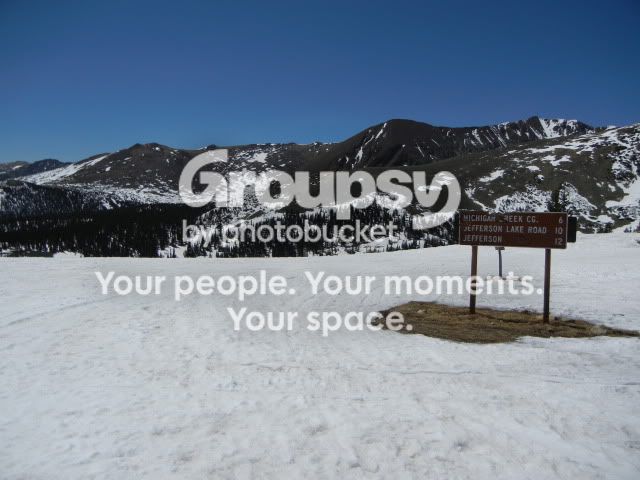

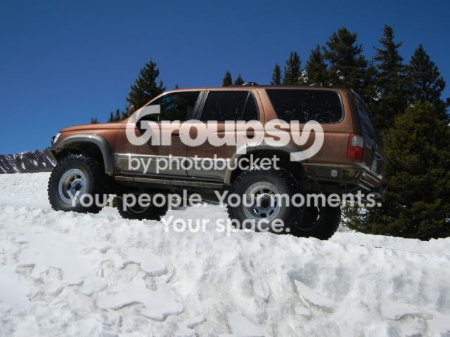

I made it all the way to the top of Georgia Pass this weekend, that’s nuts for this time of year! The snow was still packed down from all the snowmobiles and the sun had melted the snow just enough to get traction. It get’s really steep towards the top and I didn’t think I was going to make it, but the KM2’s hooked up great and I made it all the way to the top!
Towards the top :D In places the snow was even deeper (maybe 10’-15’), but for the most part it was a couple feet deep. We should really have two or three times that, it’s been a horrible year.

Here's another logo that looks cool, and is kind of applicable. Plus it has just enough mystique to it....not everyone will know what it is, but some will. Just the logo (not wording) would look pretty cool.

Oh yeah, RE the skull, I don't think it looks bad. I'd probably just leave the panel plain black if it were me.
