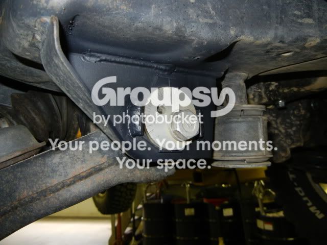

I have taken the 4Runner rock crawling once; and on that one trip the Budbuilt belly pan, along with the Lil’ Skip gas tank skid plate, saw their fair share of rocks. The gas tank skid plate held up great, but I noticed that the belly pan had started to deform a little. This is a fairly common issue and I had thought about bracing it before I ever installed it, but I gave it a chance. It was obvious the belly pan skid plate needed to come back off and get some additional bracing before I really bent it up.
While I had the skid plates off I decided to take care of a couple other things. First, I changed the oil. It was time, and I would rather not make a mess in the skid plates if I didn’t have to.

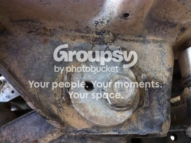

Next, I was reading through COB’s build thread (http://www.toyota-4runner.org/3rd-gen-t4rs/61636-cobs-4runner-timeline-pic-heavy-57.html#post1019539) and saw he bent the tabs for his front alignment cams. I’ve seen this before (especially on long travel trucks, I think Total Chaos even has a repair kit), but I spaced it out. While the skid plates were out of the way I decided to weld them up and prevent any future damage. I welded three of the four cams per side, the only ones I didn’t weld were back behind the steering rack tie rod boots (there wasn’t much room, and I didn’t want to burn a hole in the boots). If three of them are welded I don’t see the forth bending.
COB’s damage (I hope you don’t me posting your picture :))
ba71889e.jpg~original

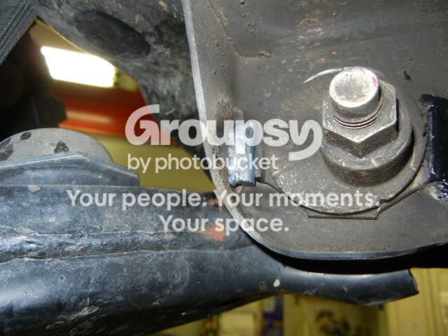

Here is a picture after I welded mine
DSCN1231.jpg~original
The back side of the front mount was a little tricky. I couldn’t get a good weld the way it was positioned, so I welded in a small section of ¼” round rod to prevent the tab from bending. It should do the same thing as welding it solid.
DSCN1233.jpg~original

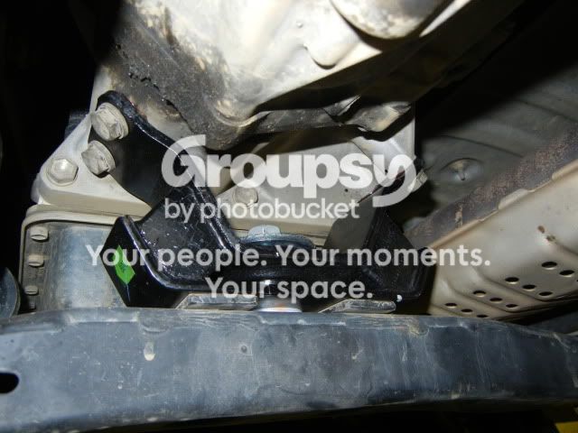

Next, I replaced the transmission mount; the old one was getting soft, saggy and was showing stress cracks everywhere. I’ve had issues with these on my old 4Runners so I decided to replace it and save the old one as a trail spare. The picture also shows the 3/16” spacers I made to gain a little room between the t-case and skid plate, they have holes drilled in them, and I used longer bolts to get full thread engagement. The spacer gives me a little over an extra ¼” of room under the t-case. (The grease is from my driveshaft slip).
DSCN1242.jpg~original

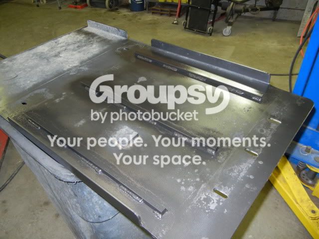

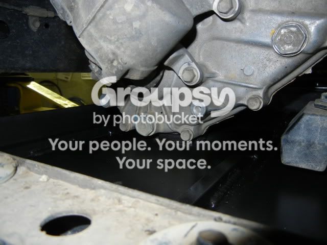

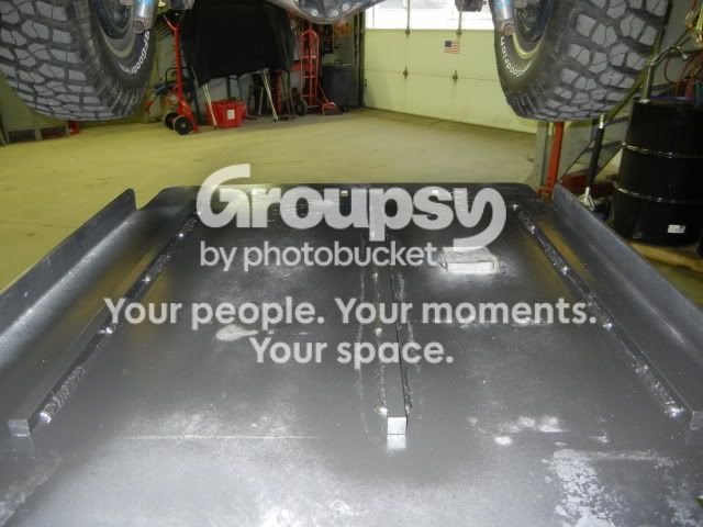

Then it was time to take care of that skid plate. I welded three strips of ½” x ½” solid steel to the long t-case section of the skid plate, it’s the longest unsupported section of the skid plate and the area that had the most rock rash. If I hit it hard enough it will still bend, but the cross members that hold it are only stamped sheet metal (maybe 1/8”?). I would rather bend the skid plate a little than smash the cross members apart; this should be a good compromise.
DSCN1239.jpg~original
DSCN1245.jpg~original
The rubber pad on the skid plate is the original isolator that was under the stock mini skid plate. It’s soft rubber, and will keep the t-case from hitting the skid plate when the drivetrain is bouncing around. I used weatherstrip adhesive to glue it in place, so far it has held up great and done its job.
DSCN1249.jpg~original

Awesome welding fixes! Great idea, and well executed. And the belly pan bracing looks perfect. Like you said, you have to compromise a little...better to bend a skid than tweak the truck.
The t-case hitting the skid is definitely a problem....it bugged the crap out of me on my old rig. If I drove over railroad tracks at 45mph, it would clang around pretty good. I never put a pad on it, because I was going to leave the whole skid off if I kept the truck.

It's really nice to hear that response (sorry, that sounds bad); I thought I was being OCD about the whole clearance thing but I really felt the t-case was going to hit the skid plate when I first installed it, so I made the spacers and installed the pad.

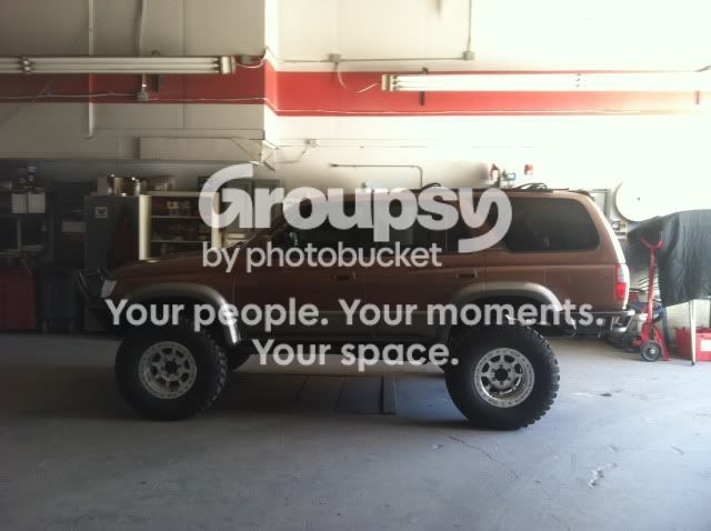

Building an all around comfortable daily driver / weekend wheeling rig is a challenge, but throwing a trailer in the mix complicates things even more. I have the SS1.2 suspension kit, which uses stock front LC coils for the rear springs. These springs have a very soft spring rate (around 160) and normally give around 4” of lift. I love these springs for low speed crawling and slow trail exploring; they ride/flex great and you hardly feel any of the small bumps that like to transmit through the suspension.
The problem is I carry a lot of gear with me, and it adds a decent amount of weight to the back of the 4Runner. The gear is always in the back of the 4Runner, and the rear suspension is noticeably softer than the front; while that’s great on the slower trails, it’s really too soft for faster trails and everyday driving, and it’s way too soft for highway driving. Adding a trailer only makes things worse. As you can see, the Sonoran Steel rear LC springs should give you about 4” of lift; I’m at about 2.5” and I have no rake at all.
DSCN1288.jpg~original
DSCN1292.jpg~original
Once I hooked up the empty trailer the 4Runner squatted down another good ½” at the rear wheel well (over an inch at the bumper), I’m sure it will drop even more once the trailer is loaded, and the 4Runner has some extra camping gear.
DSCN1306.jpg~original
While I have not towed the trailer on the highway yet, on the back streets around the shop the spring rate is noticeably way too soft and the rear suspension bottoms out on even a small dip or bump. The trailer is going to see plenty of easy and moderate trails (maybe even a couple hard ones), so something needed to be done about the rear coils.

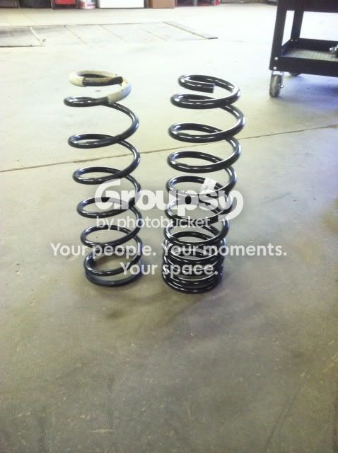

My first thought was to re-install the stock cone bump stops that are removed with the SS kit, then add one or two 10mm OME spacers; but that wouldn’t do anything about the super soft spring rate. I also thought about air bags, but I didn’t like the idea of the bags inside the coils chaffing and rubbing all the time.
My next thought was to use the OME 891’s, which have a spring rate of 210 and give about 3” of lift; this would have been my number one choice if I did not have the trailer. But, I was concerned that the weight of all my gear, plus the weight of the trailer would sag down the rear suspension to about the same level as the springs I have.
After a lot of thought, and research, I decided to use the OME 861 springs. These are a replacement for the front LC springs I have, but with a low lift (.25) and a heavy spring rate (220) that is designed for an additional 110-250 pounds of weight (on the front of a FJ80). I also believe these are a progressive rate coil spring. My main concern was getting too much lift out of them; it seems that most people get 4.5”-5.5” of lift, and that was just too much for me considering my front suspension is less than 2.5”. I crossed my fingers and got to work…
Stock LC spring on the left, OME 861 on the right
IMG_0300.jpg~original

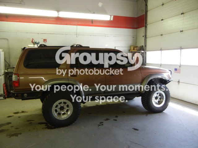

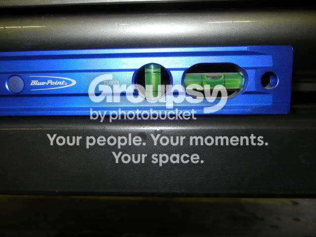

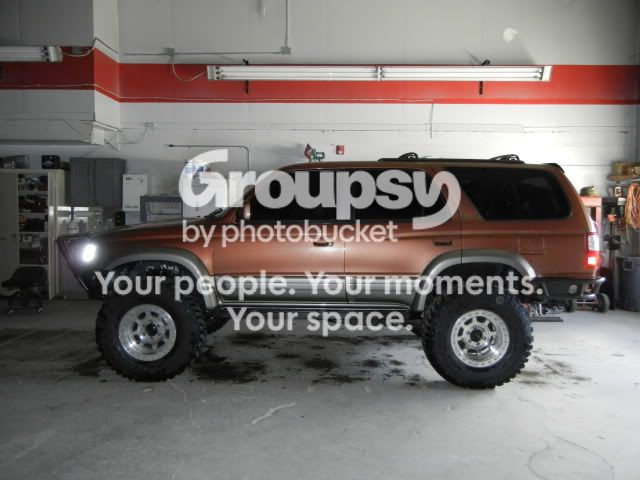

I installed the springs, lowered the truck, and found that it only lifted the back of the 4Runner about 1”. What a relief, I was really concerned it was going to be more! :)
Before
After
IMG_0301.jpg~original
Outside, in better light
IMG_0303.jpg~original
