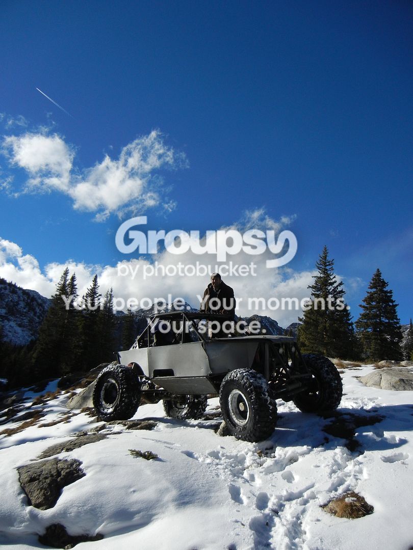

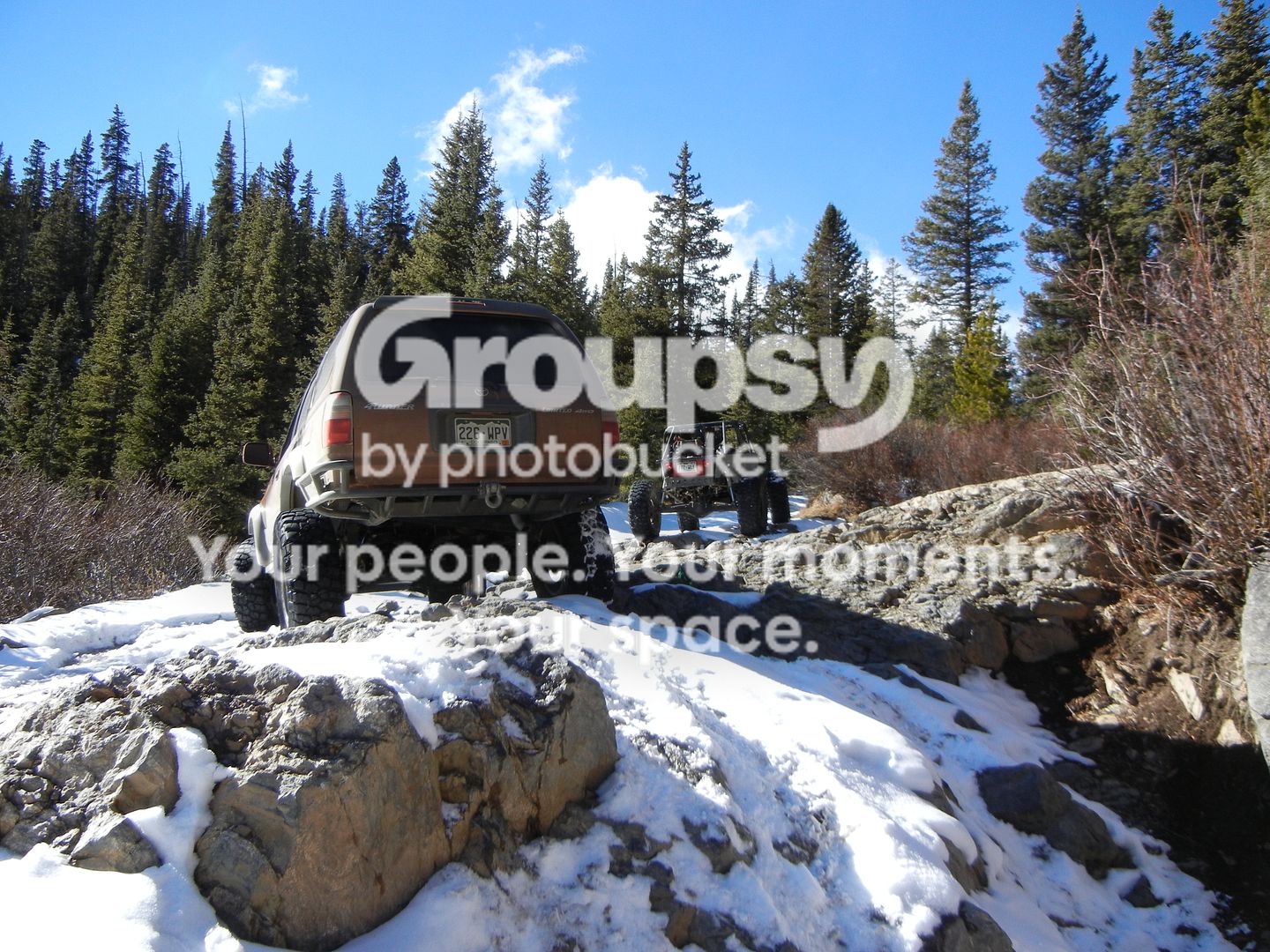

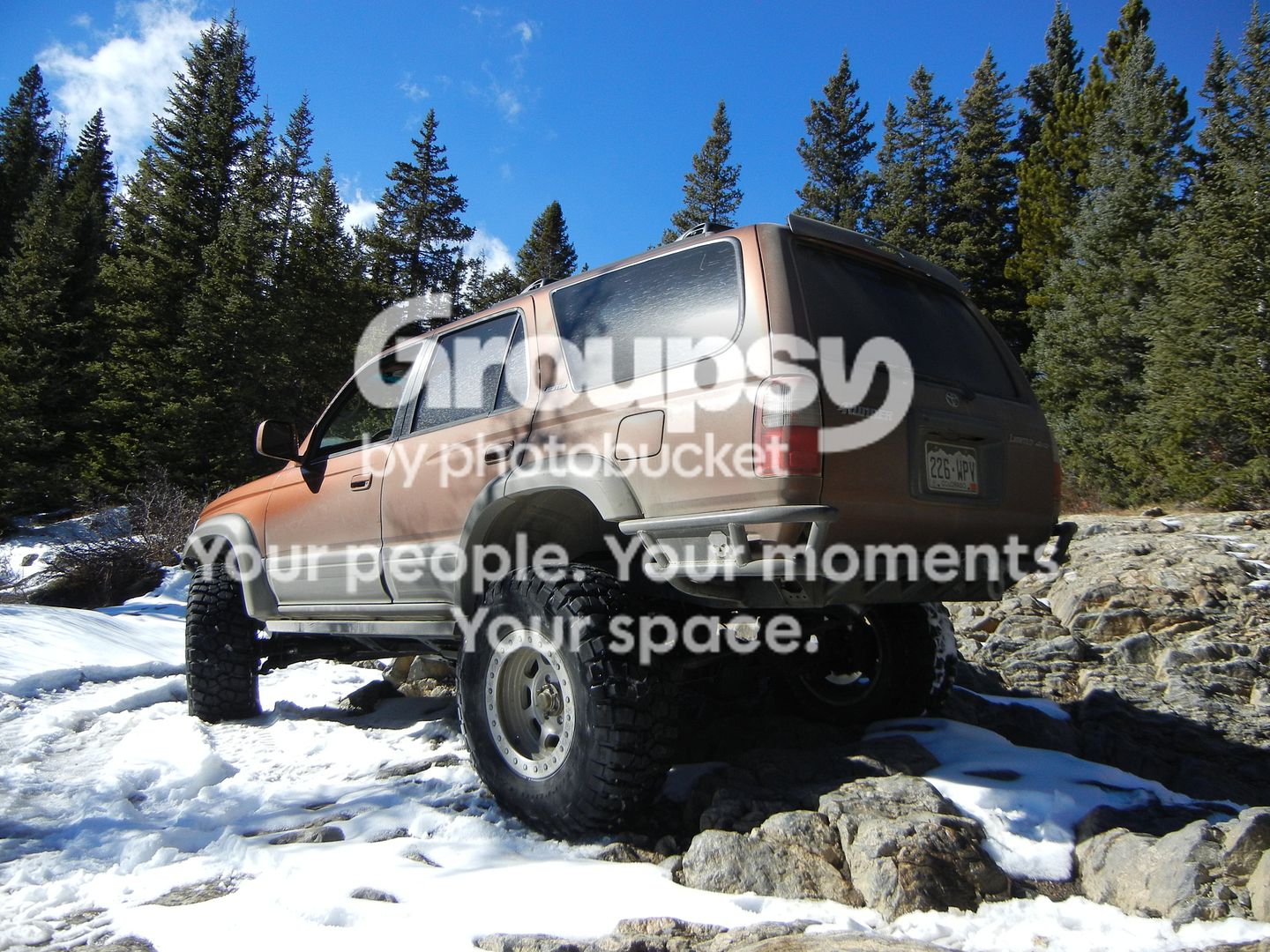

My buddy Cory and I made a last minute trip up Holy Cross this weekend! This trail is pretty hard when it’s dry (the creek at least), add a bunch of snow and things only get harder! We made it through the first couple obstacles without much of an issue; there was around six inches of snow, and the first obstacle took a little tire spin, but it wasn’t an issue. The ledge before French Creek gets a good amount of sun, so there wasn’t as much snow there. I tried the hard left line, but it was just too slick and the back of the 4Runner kept kicking out and off the line I needed. But I walked right up the right line without an issue, even with the snow.

We worked our way to French Creek and were greeted with a bunch of snow and ice! The whole creek was frozen with spots where you would break through. I knew I didn’t have a snowball’s chance in hell of getting through, but I still gave it a shot! I made it to the same place where I broke my CV this summer; with all the snow and ice there was no traction to be had, and after giving it a couple shots I turned around.

We ate lunch at the creek, and then I put on a couple extra layers and hopped in the passenger seat of the buggy for what was bound to be exciting ride! We made it all the way to the city, but it did take some work. For the most part the rest of the trail is in the shade, and it was icy!

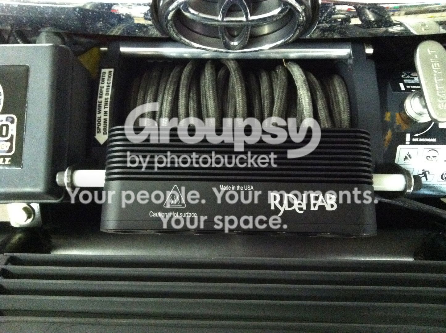

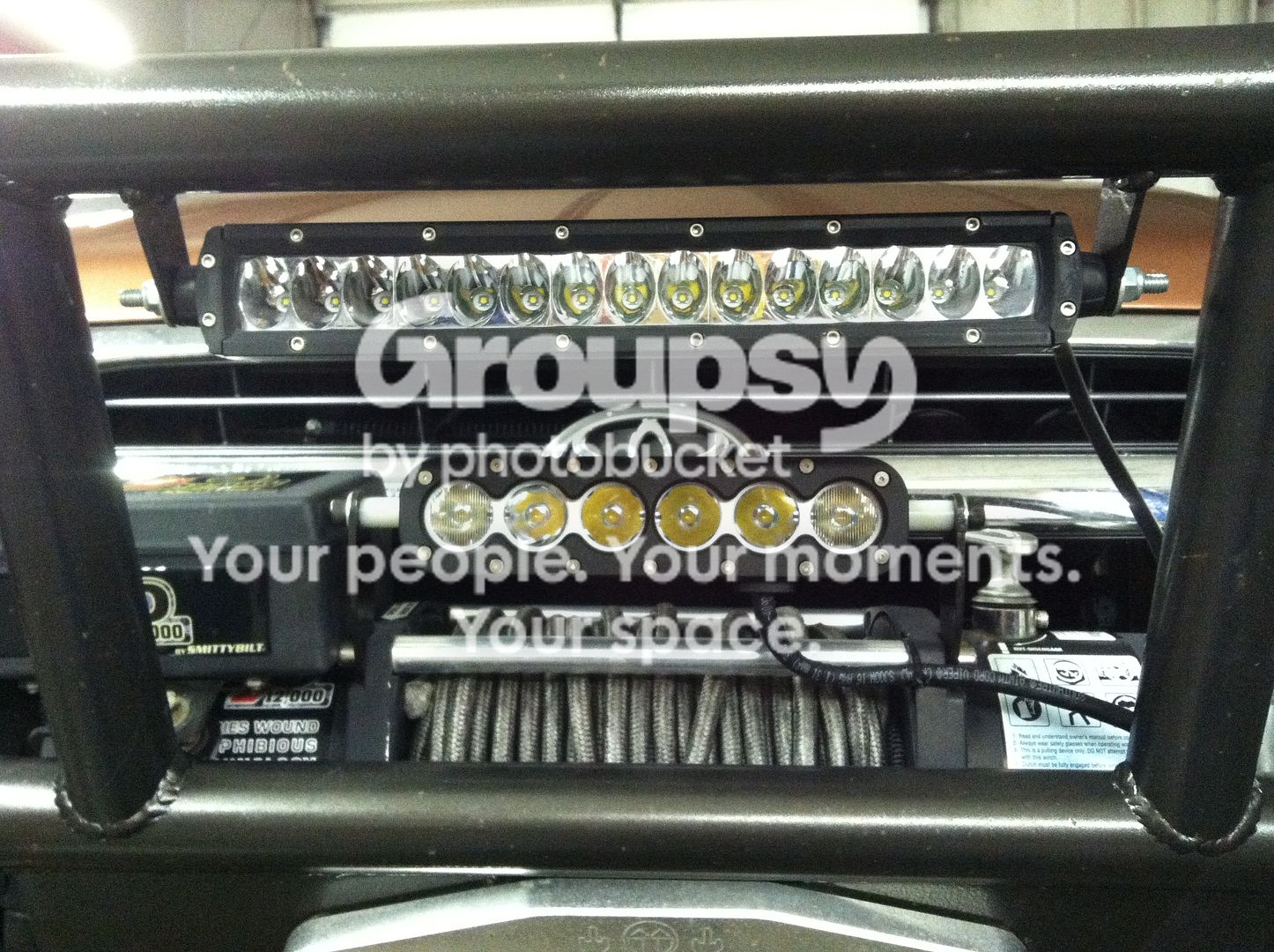

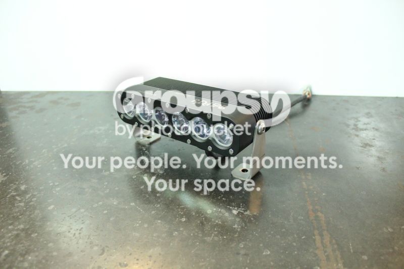

First, size: I wanted to add another light (or lights) for a while but I couldn’t find a location, or light, that would work without looking stupid and crowded/out of place. That was until I saw this light, and figured out the measurements. It’s an almost perfect fit for above the winch.
Second, the LEDS and pattern: My RI light bar has 15, 3watt LED’s in a driving beam pattern. This light has 6, 10watt LED’s. Four of them are in spot pattern, and two in a flood or diffused pattern. This light is rated at 5100 lumens (the same as my RI light). The pattern and power of the LED’s seemed like a great match to my RI light and should fill in the area’s that need more light (I hope).
Third, price: I have looked at the 10watt LED lights before, a Vision X 6 LED light bar is $570 but it’s 11” long and does not fit my truck. This one retails at $300, and I picked it up for $280 on the Black Friday sale. The internal parts seem to be top of the line; it uses Cree XM-L LED’s and the optics are interchangeable at a minimal price of $1.60 each. It also has low/high and strobe settings!
A link to the light and spec’s: https://www.rydelfab.com/index.php?route=product/product&path=59&product_id=50
ledbar1-800x800.jpg~original

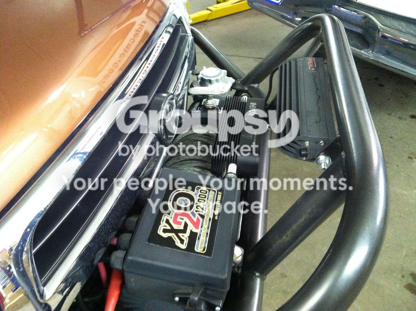

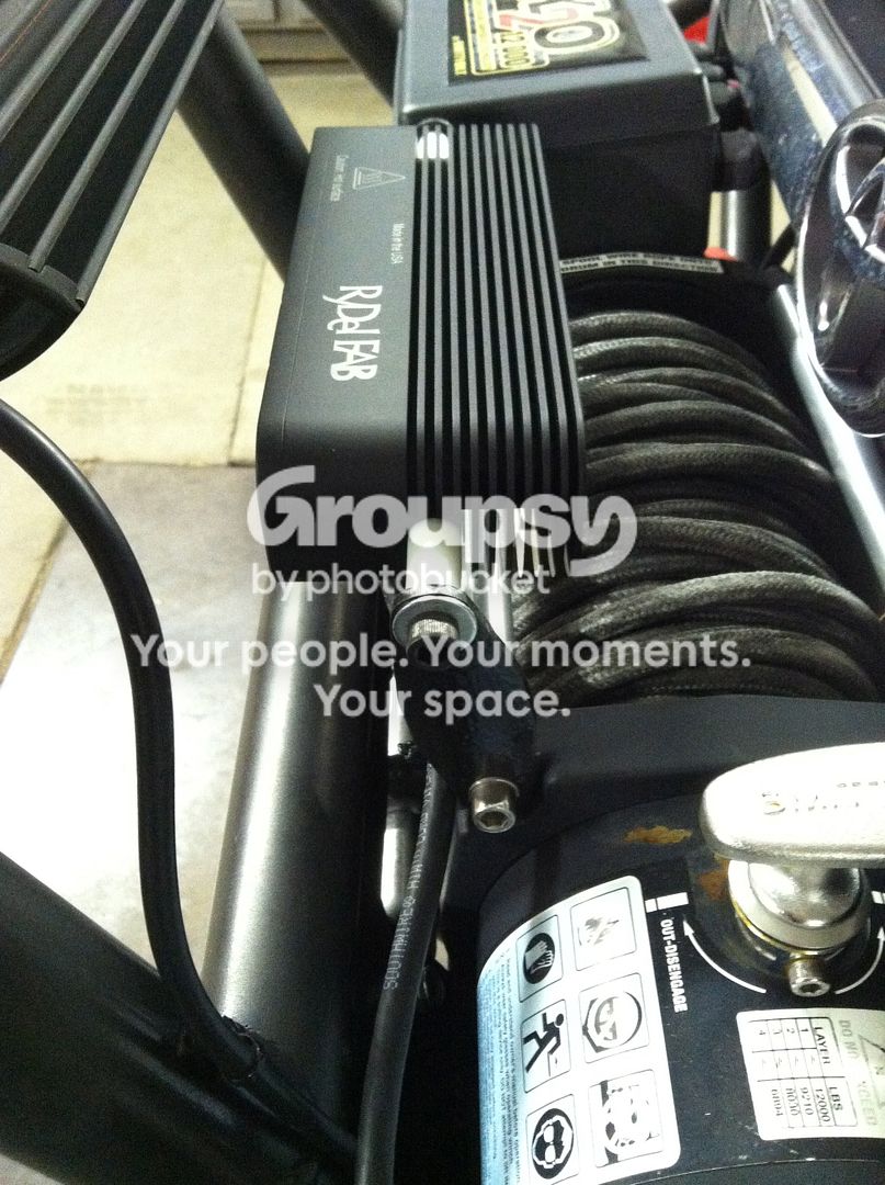

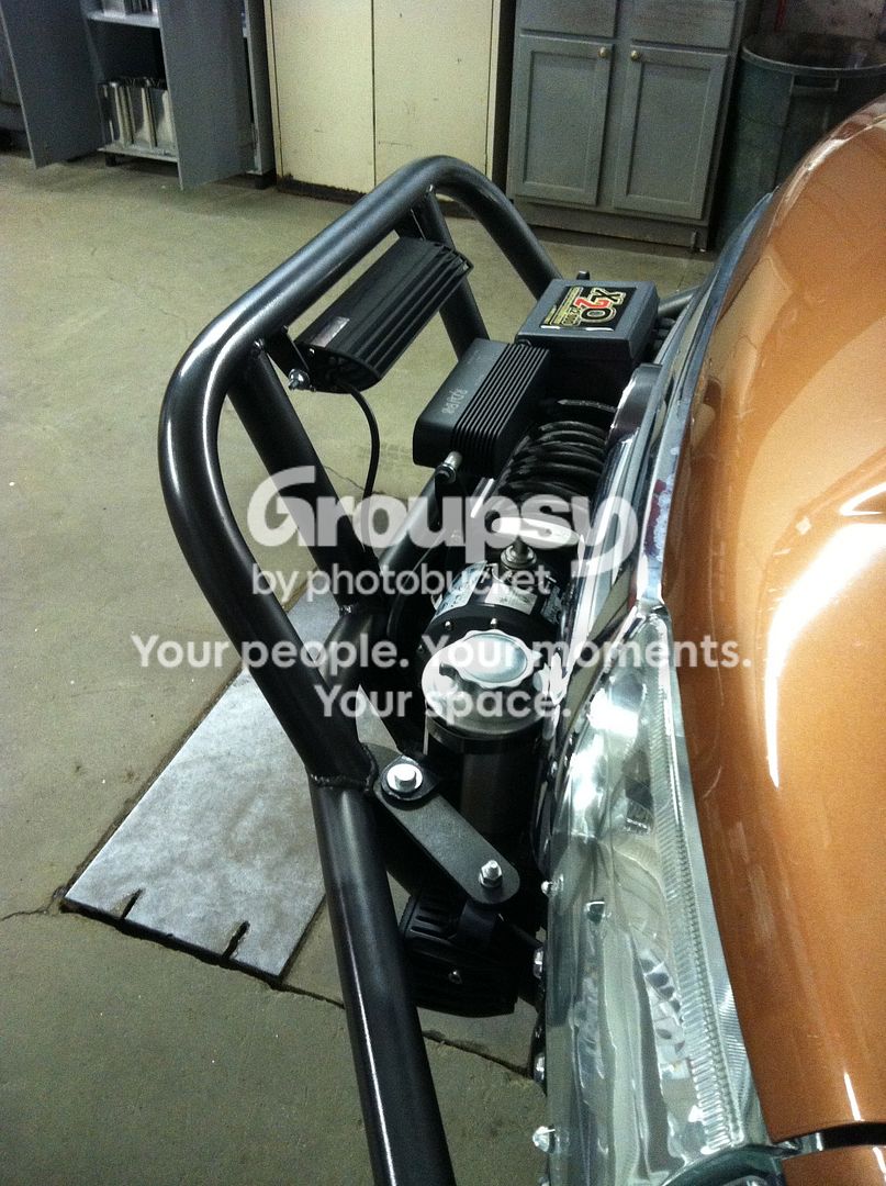

And here is the light installed.
I made some brackets that attach it to the winch, and some spacers to get the right width.
IMG_0762.jpg~original
IMG_0765.jpg~original
IMG_0769.jpg~original
IMG_0754.jpg~original
IMG_0751.jpg~original
IMG_0752.jpg~original
im very interested in pics of the output and your review on this product. if all turns out good i might have found my christmas presents.
Nice setup! I've been thinking about lighting lately, and have been looking at LED setups. After going to SEMA this year, I can day that there are definitely an influx of new lights coming, with many new companies bringing in stuff from China. Hopefully that will help ease prices!
Regardless, I'm interested in seeing your pics and impressions of the light setup you have. Is the new light that much brighter?

First time I've seen the Rydel Fab light bar. Some serious thought into it's build and components. Which wiring option did you choose?
Looking forward to output pics and your review.
Ha, so you found Rydel too eh? I was following his thread during all the design too... I bought one as a trial and it is nothing short of amazing...

Looks great, really cool that you figured out how to attach it to the winch.
Night pics pronto!
Thanks man! I wanted to still be able to remove the winch down the road (if I need to), bolting it to the winch seemed like the cleanest and best option.
I still need to finish wiring it, but once I'm done I will take some pictures. I can tell you that from my in shop battery pack testing, this light is bright! I hope to have it wired in the next day or two.
