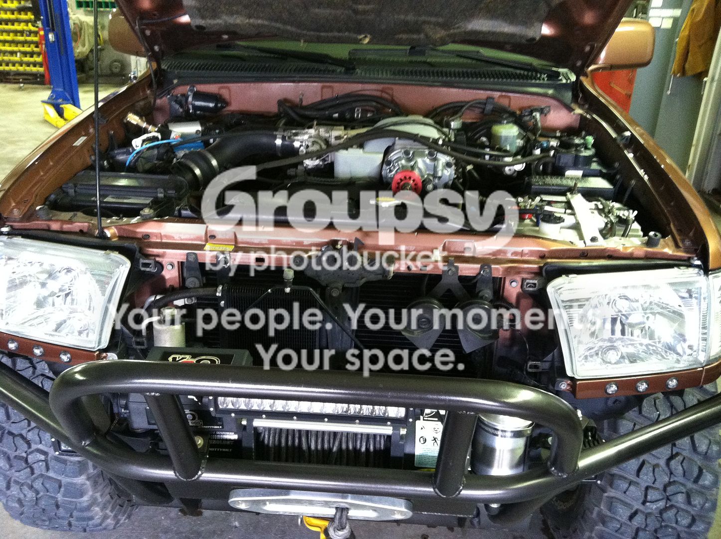

I took care of a few smaller things on the 4Runner.
My headlights were out of adjustment after the lift and the switch to the OME 861’s, and the driver side was way off. After looking at it I found a broken clip that holds the adjuster to the main bracket behind the headlight itself. I had to pull the headlight out to repair it, which also meant pulling the grille, and that leads me to the next modification.

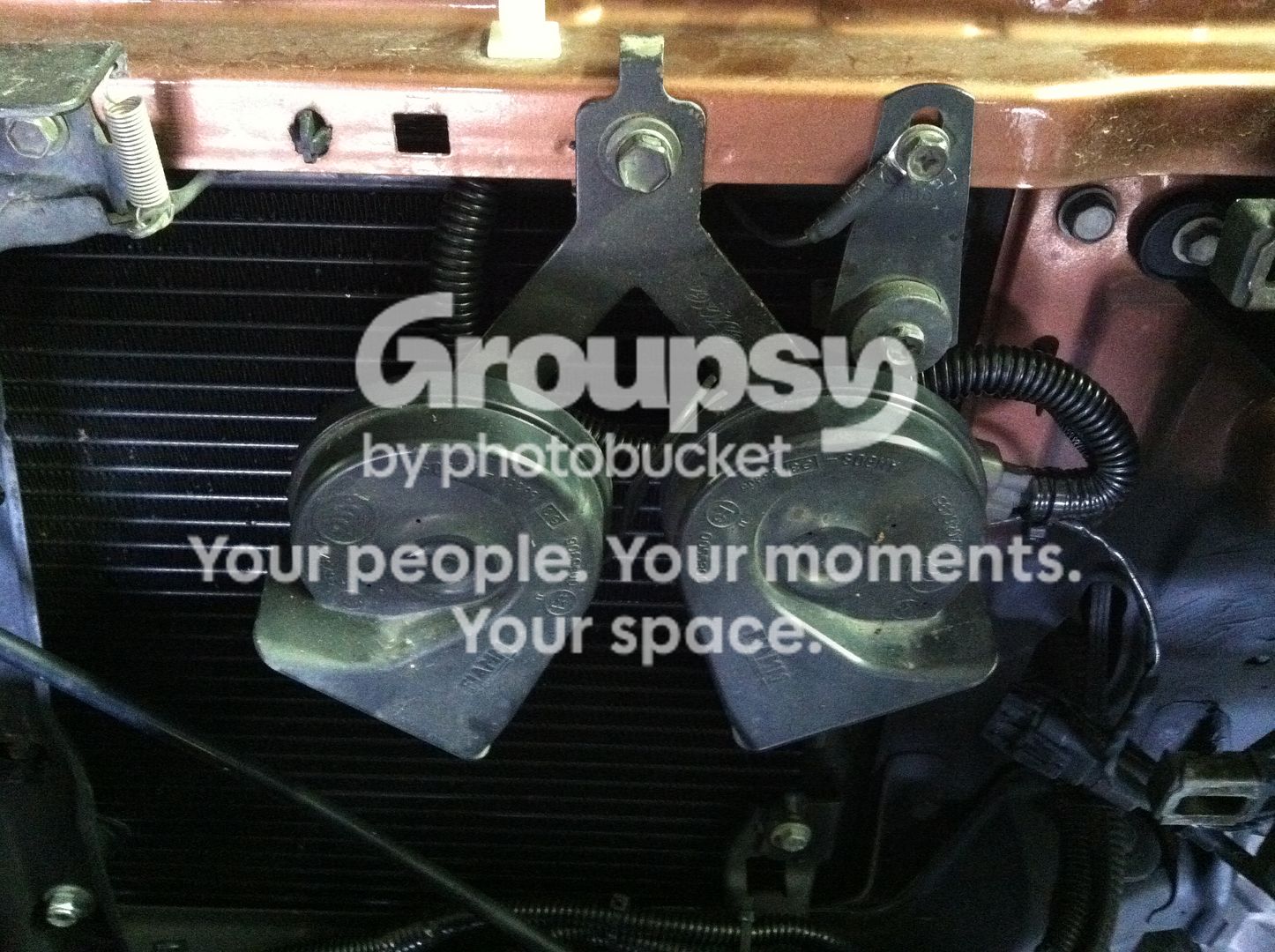

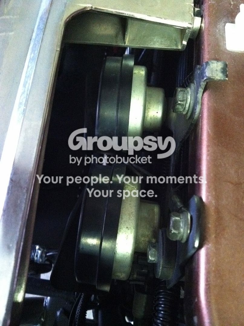

As we all know, the stock 4Runner horn is pathetic! I had some idiot try to pull out in front of me in a round about, I laid on the horn and I swear the guy laughed at me! It’s not so much how loud it is, as the tone of it. It sounds like it belongs on a Beetle or Mini Cooper. I thought about buying some aftermarket Hella rally car horns, but I didn’t feel like spending money on something that I will hardly ever use.
Just about anything American would do the job, so I grabbed one off a Ford E-350 van. It seems to be a little louder than the old ones, and the tone is much better!

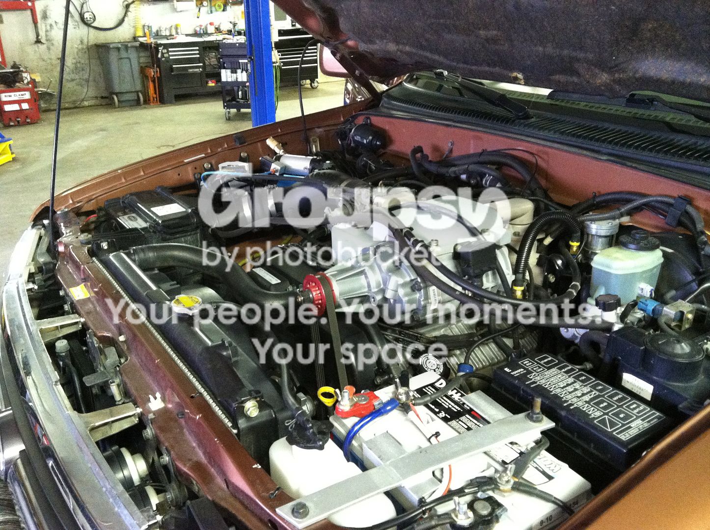

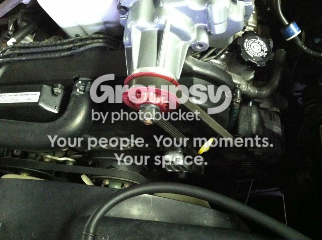

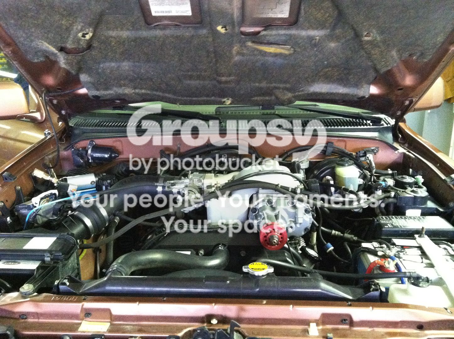

I also got around to upgrading my supercharger belt system.
I have the one of the first TRD supercharger kits and I believe it was installed when the vehicle was still new; it came with the pre-cut timing belt cover, fuel pressure regulator and reused the stock manual alternator belt tensioner. It was always a fine line between having the belt slip and over tightening it (which is hard on the nose cone), and I also noticed some oil/grease stains coming from the idler pulley. It was time to upgrade.
The newer kits come with a dynamic tensioner that is pretty much the standard these days. The idler is connected to a spring-loaded arm that controls the tension and adjusts itself.
