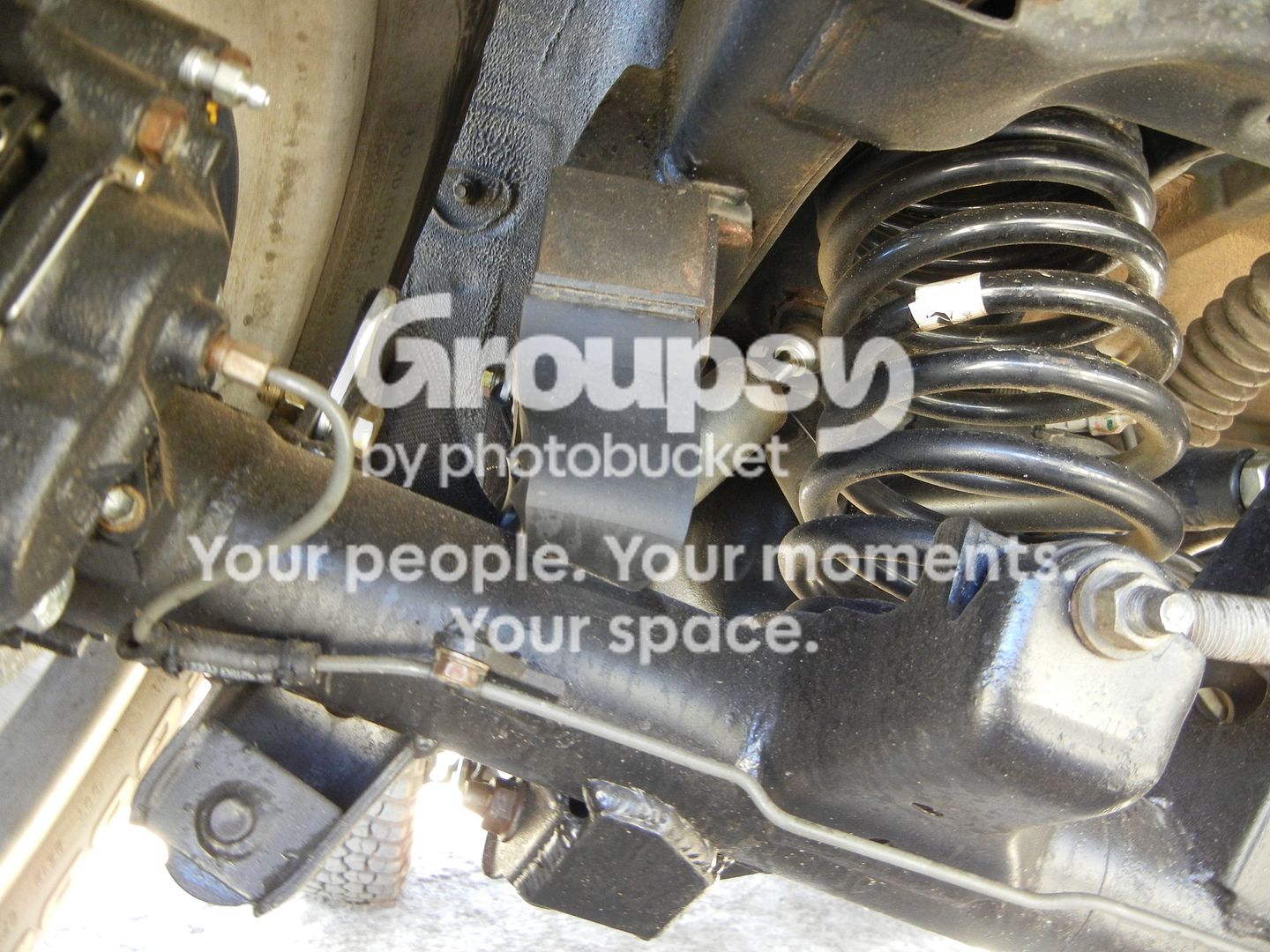

hey bud quick question. do you know the heim size that come on the PH bar. I am just gonna build one and need to know the bolt size.
PS looks killer bro
Congrats on the build win Dirtco! Well deserved. I think we all wish we had your skills. This thread is one I simply have to keep revisiting time and time again. Well done.
Thank you! I really appreciate the compliment. :)
Oh, by the way I love your seats! They look awesome and I bet they are very comfortable.
Beautiful runner... well deserved win for the month
Thanks man!
PS looks killer bro
Thanks! The Sonoran Steel panhard bar does not have heim joints, it uses a rubber or urethane bushing. Here is the best picture I could find.
DSCN1609.jpg~original

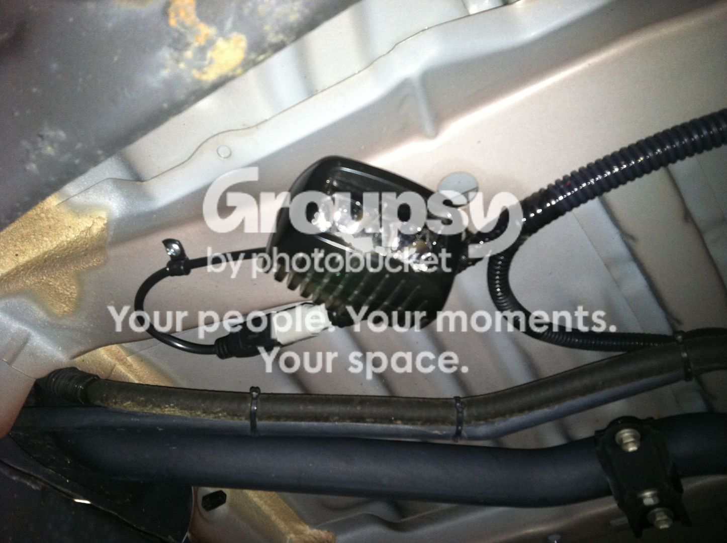

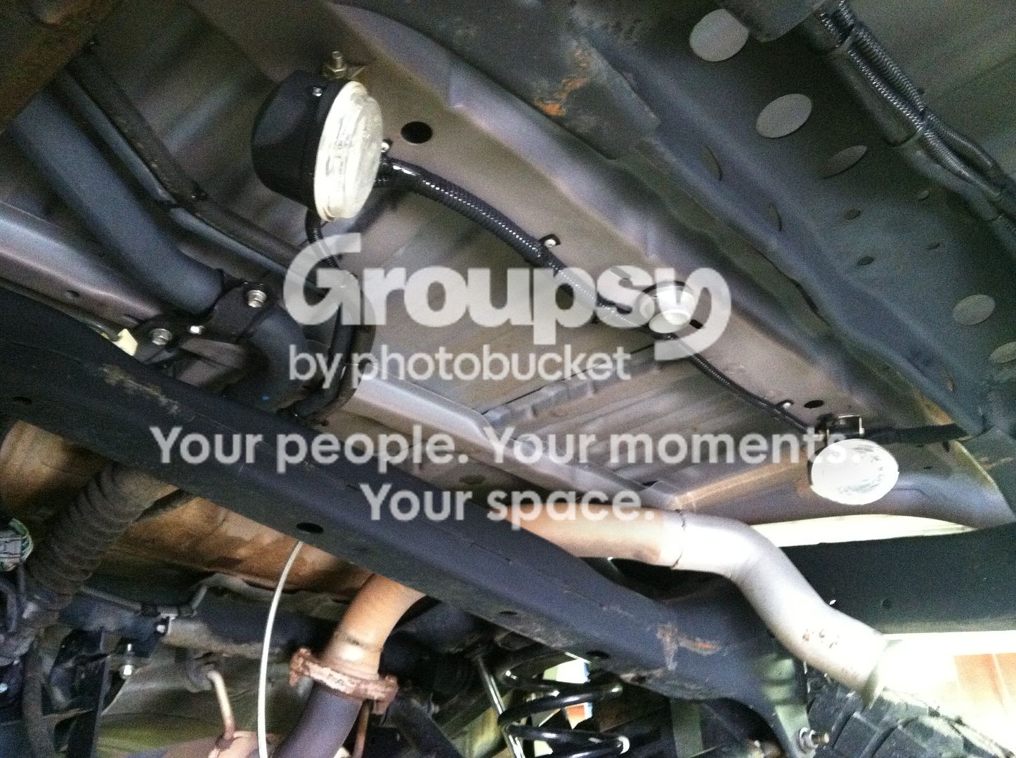

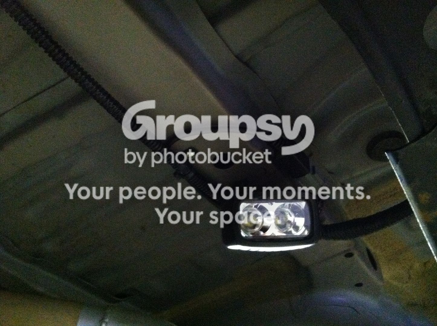

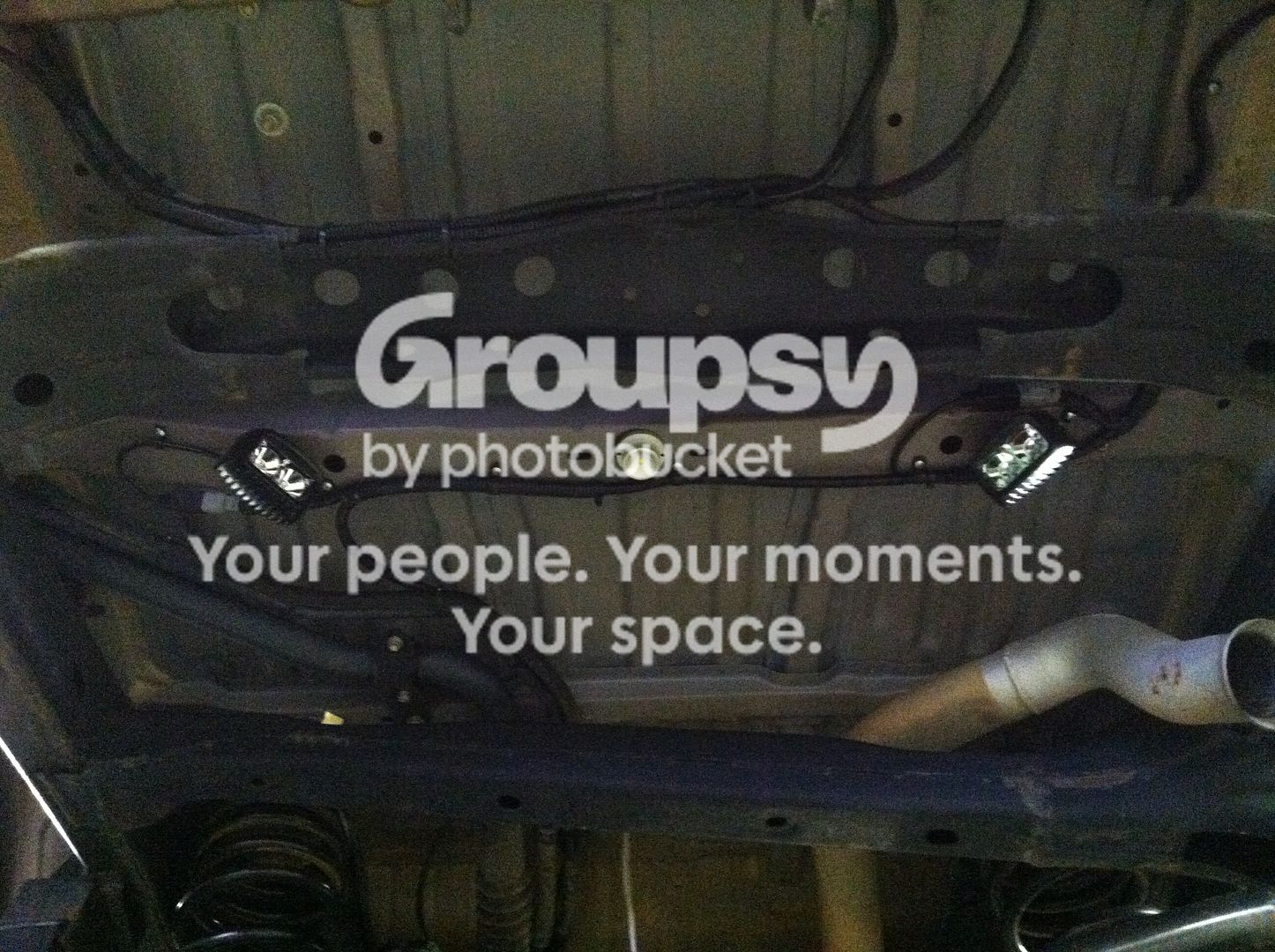

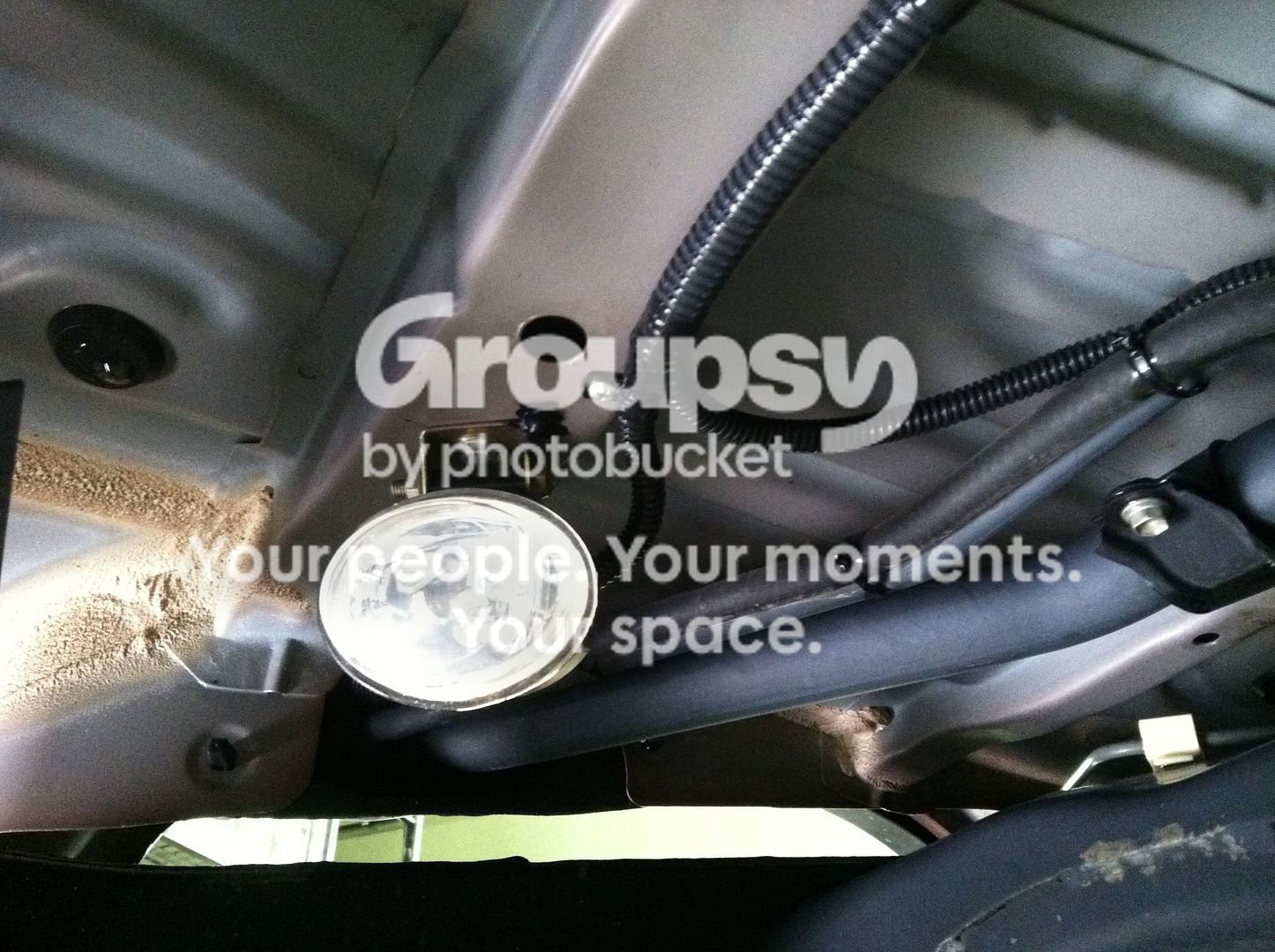

I was never very happy with the cheap aux. back up lights that I installed. They worked, but the light color didn’t match the rock lights and I’ve been waiting for a bulb to burn out or break from vibration. I had a pair of the flood pattern Rigid Industries SRM lights just setting in my tool box (after I swapped them for the diffused pattern when I was dialing in my rock lights). I figured what the hell, and installed them as a replacement. It’s a LOT less of a draw on the electrical system, much brighter light, and longer lasting.
Old
IMG_0829.jpg~original
IMG_0827.jpg~original
New
IMG_0830.jpg~original
IMG_0831.jpg~original
IMG_0832.jpg~original
