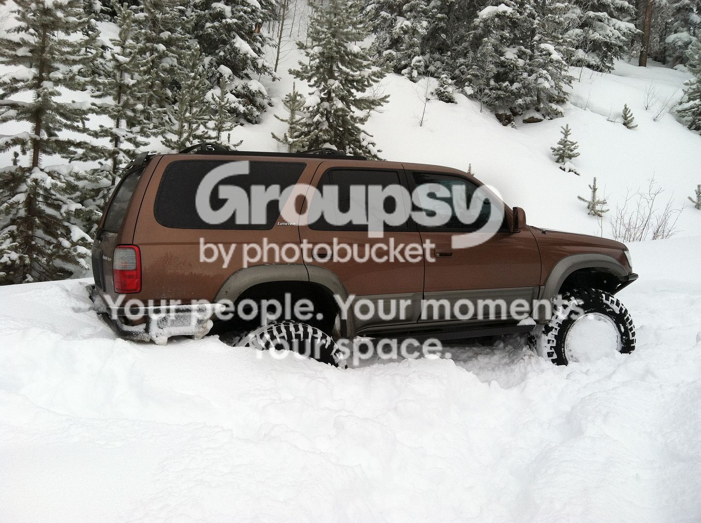

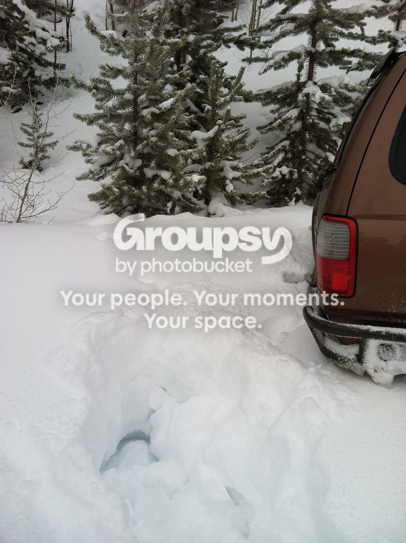

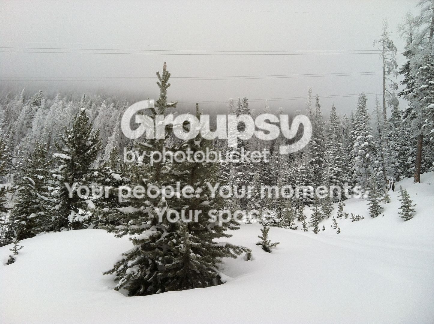

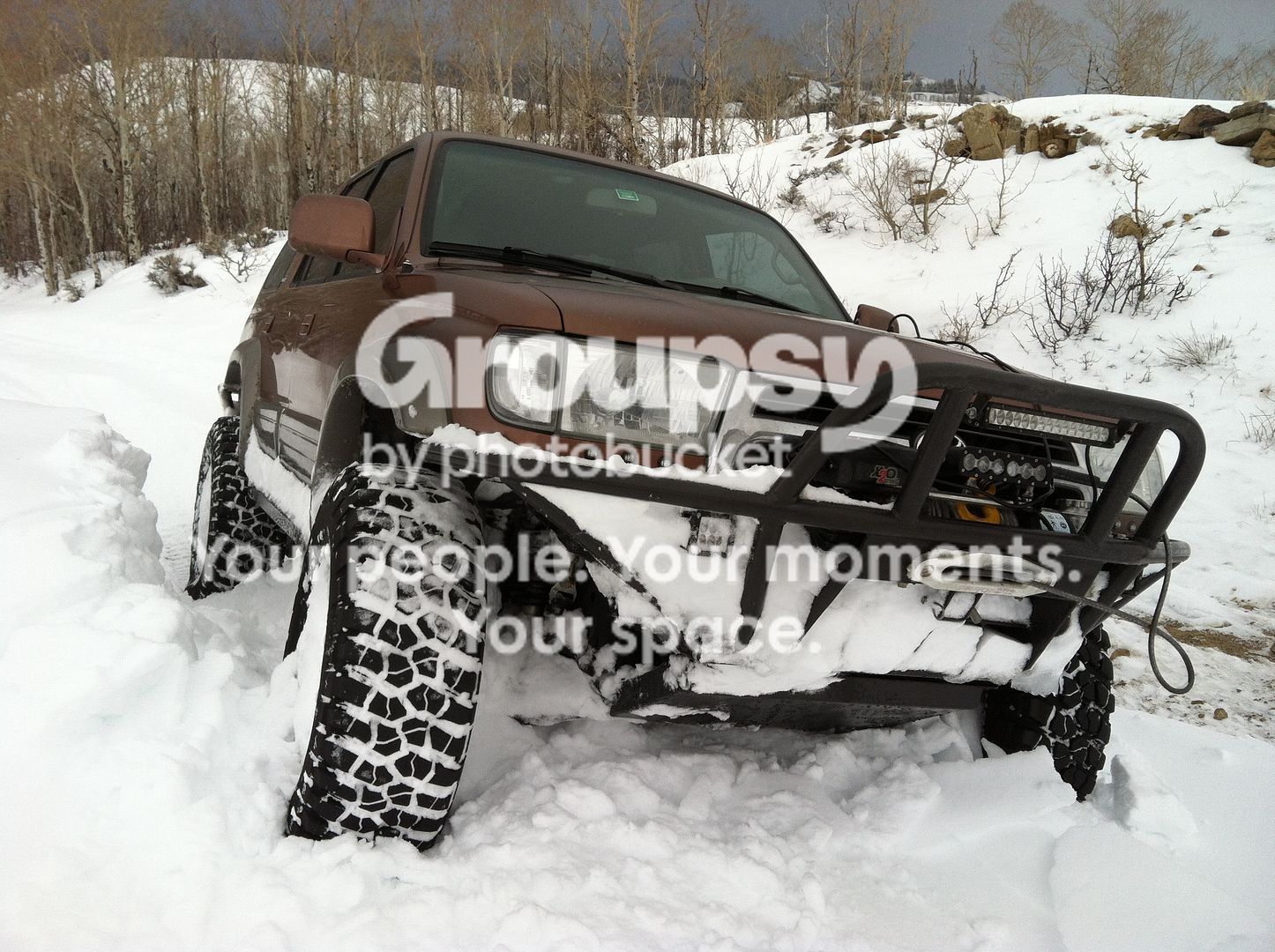

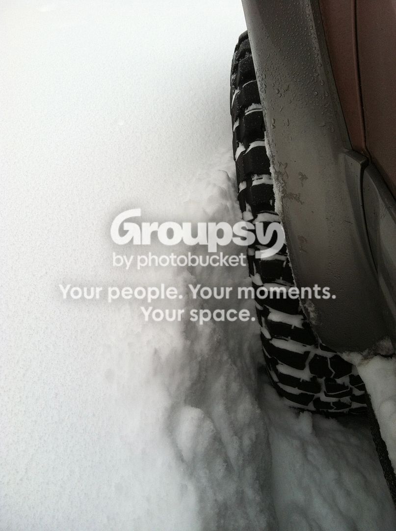

We got a little snow today and I had the day off, so I went to my snow wheeling spot. The snow was deeper than I expected and I pretty much got my ass handed to me, but it was still fun! What should have been a 20 minute trip to the good stuff took over two hours, I really didn’t think I was going to make it.
Once I got in the trees the snow got even deeper and I struggled to make progress. I got stuck a couple times, and once I got off my old tracks to hook up the winch line the snow was chest deep! Needless to say snow wheeling season is over until spring when the snow gets hard and wet, another month or two and I’ll be back.
A sign of things to come, this is on top of my old tracks from around a month ago.

This is what happened when I got off my old tracks!

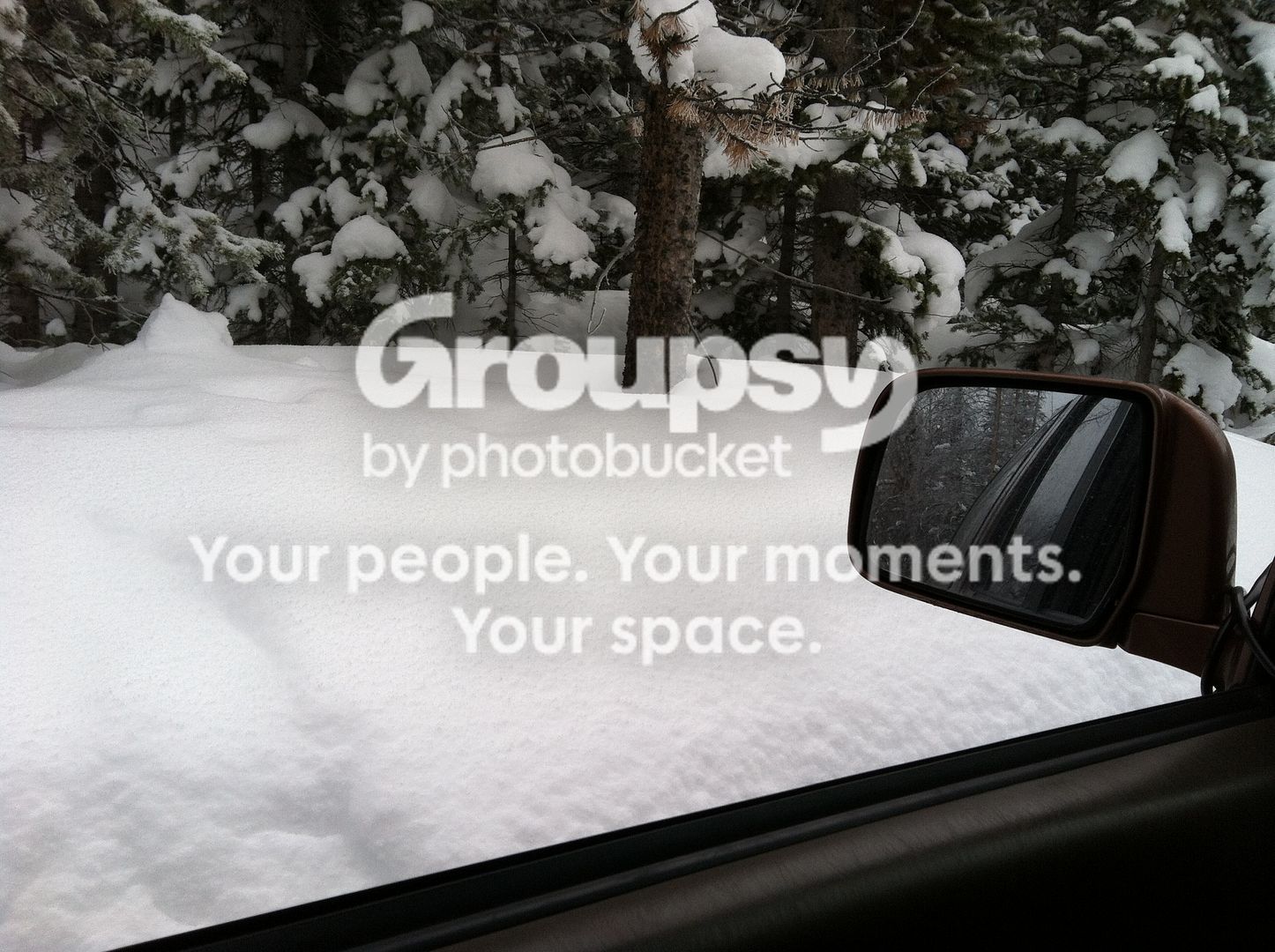

Some of the snow drifts were as tall as my window opening

Thanks man! If you like snow wheeling you will love those beadlocks you have, I had to air down to 3psi to make any progress. I know you don’t get much where you live, but for future reference... :)
