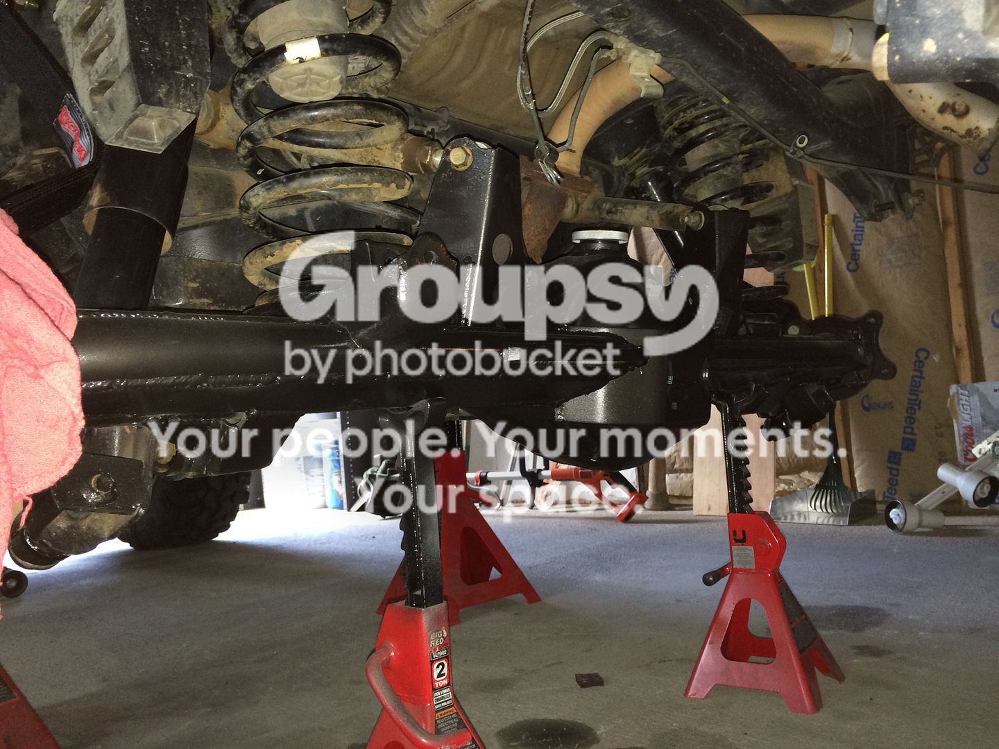

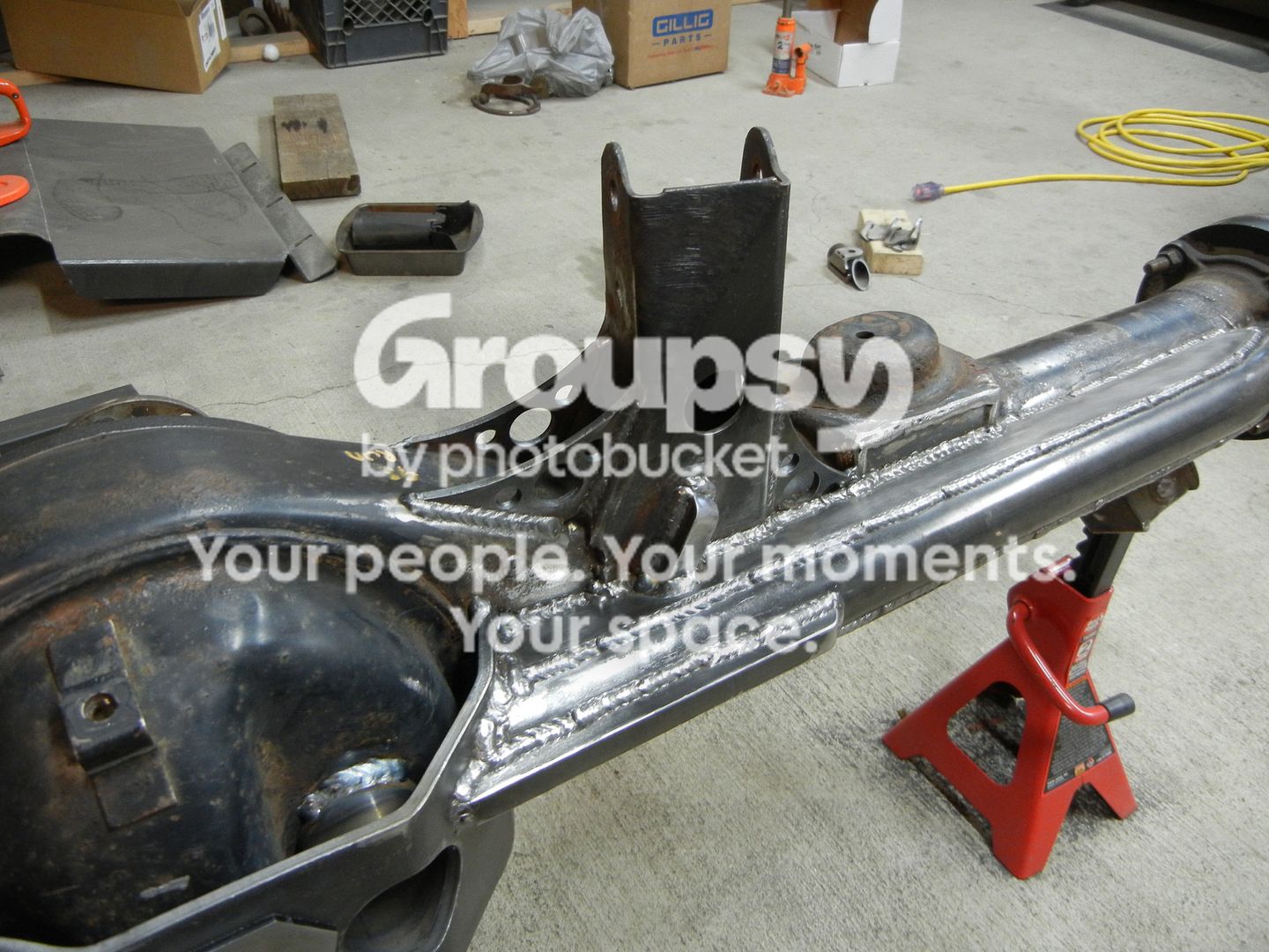

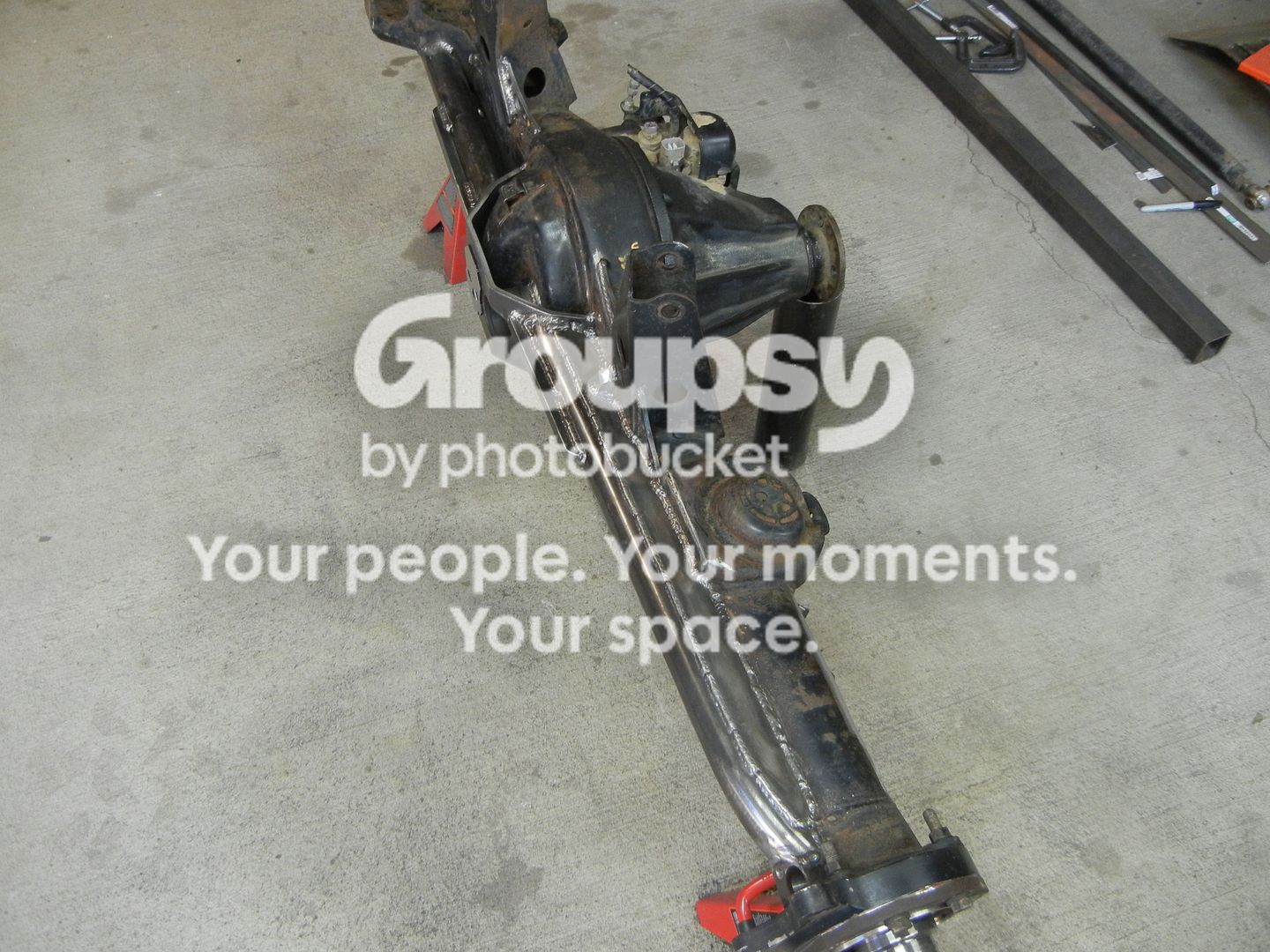

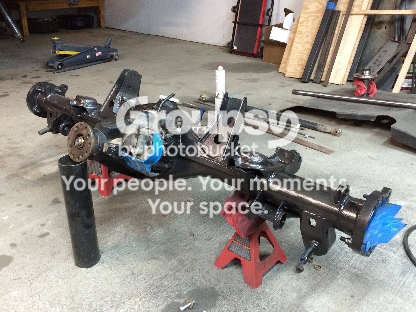

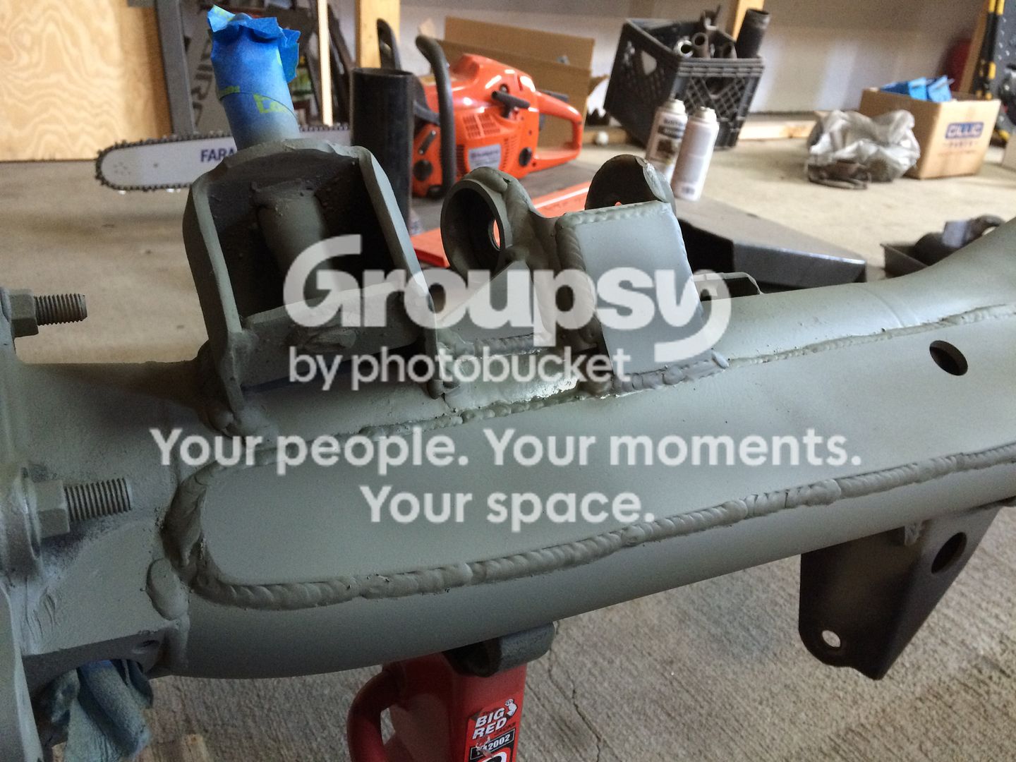

I finally got a little time to upload some pictures and post an update. The truss work is done. When it’s all said and done I went through over five pounds of welding wire, all an inch or two at a time!

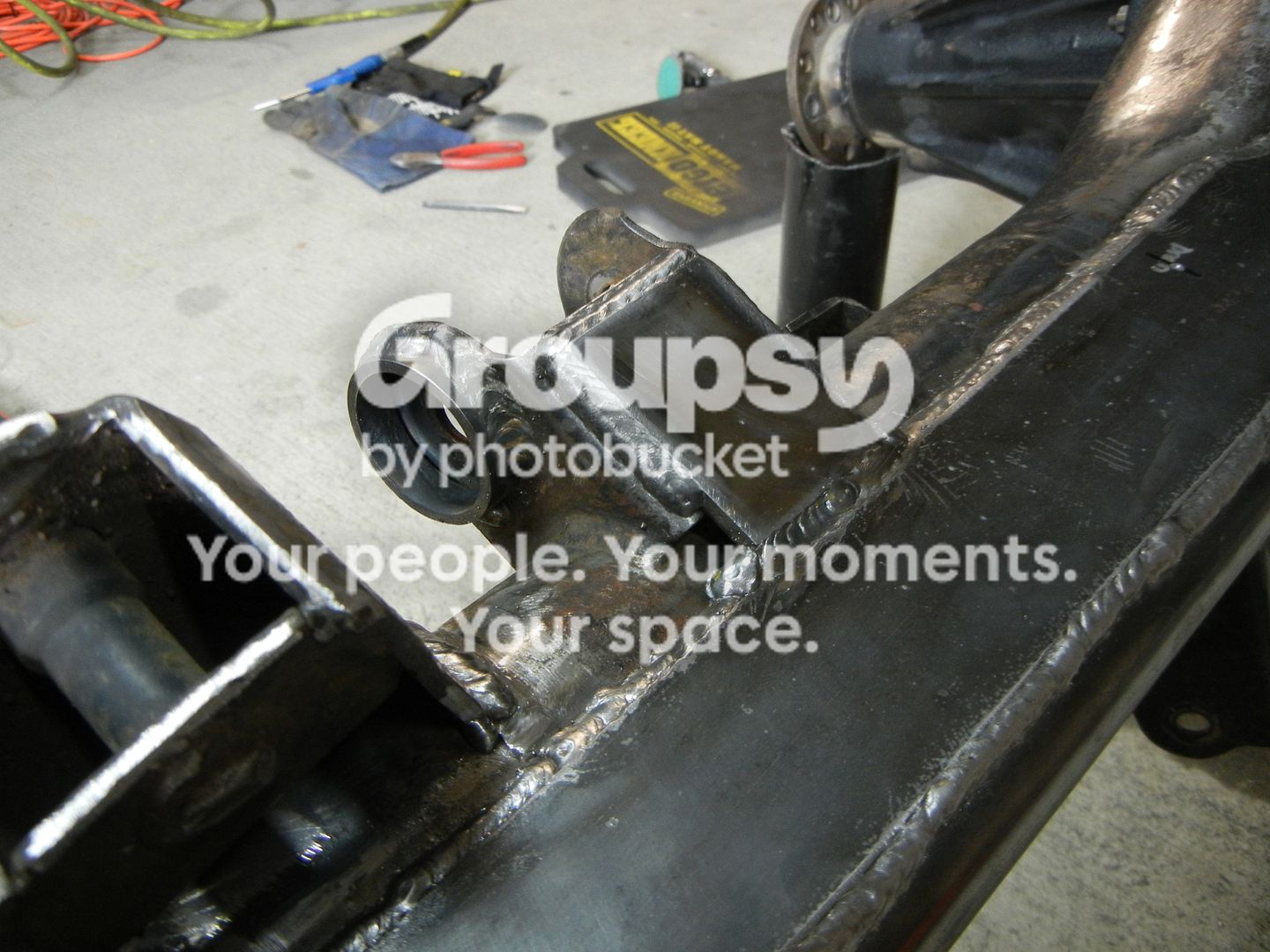

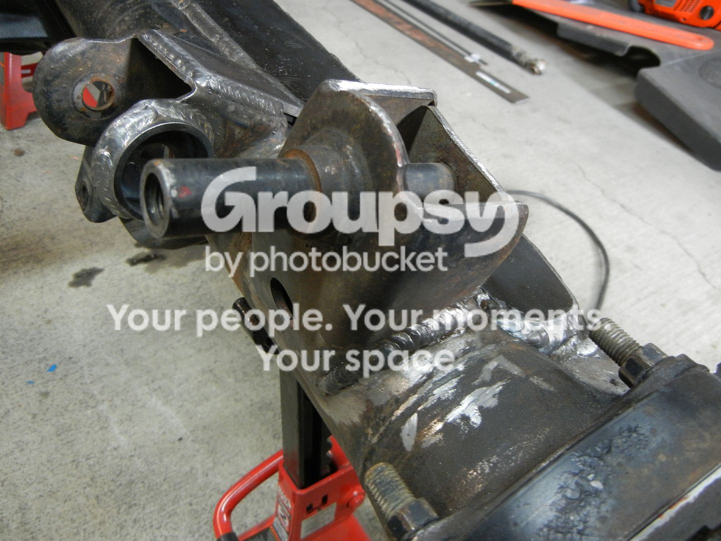

Once the main truss section was in place I braced the lower control arm mounts, and cut an inch out of the lower shock mount (like the last axle).
I also tied the LCA mounts into the lower shock mounts

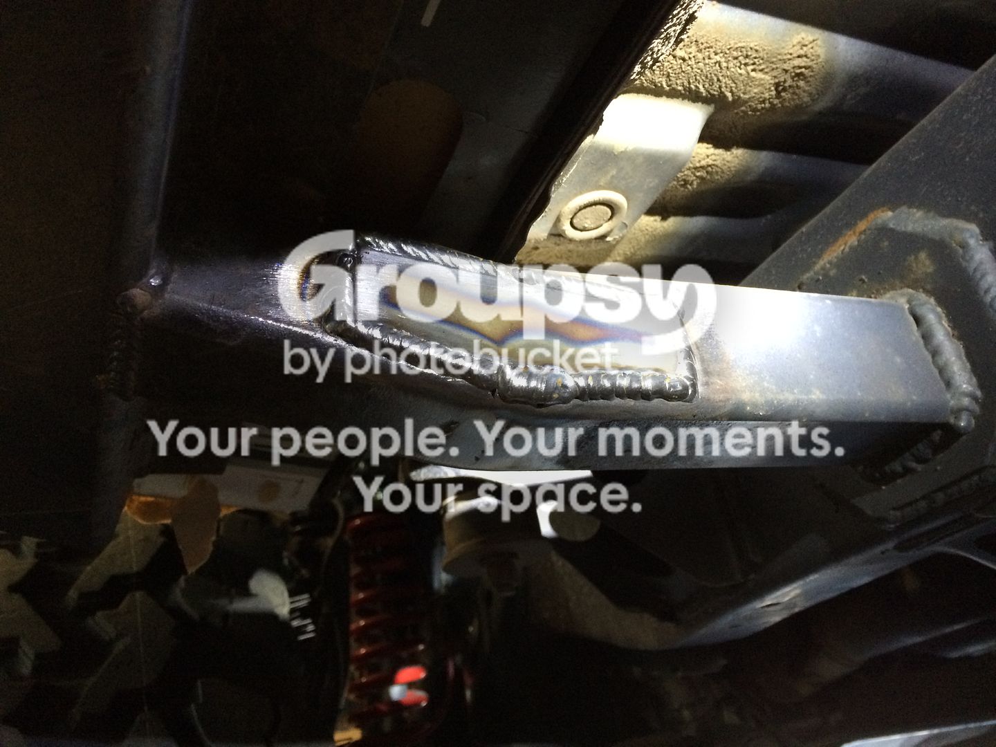

Upper truss plate and UCA gussets

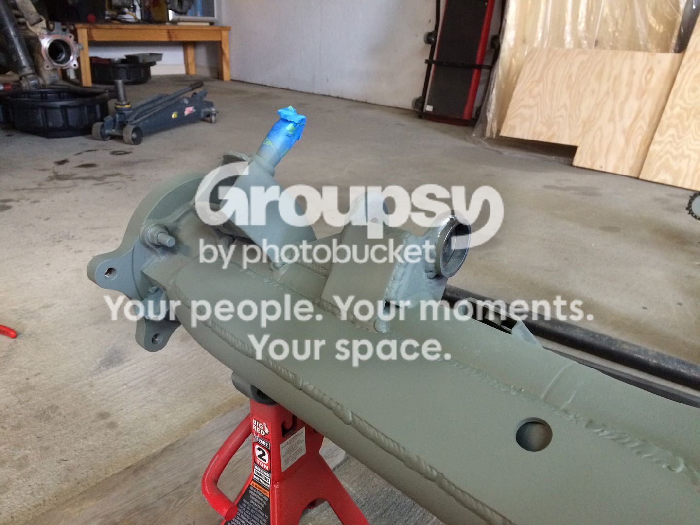

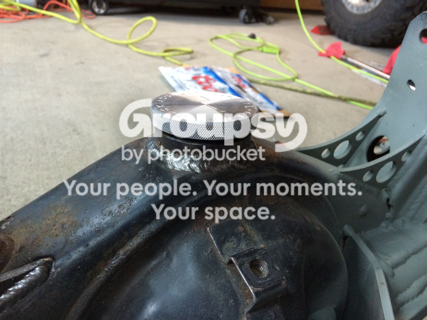

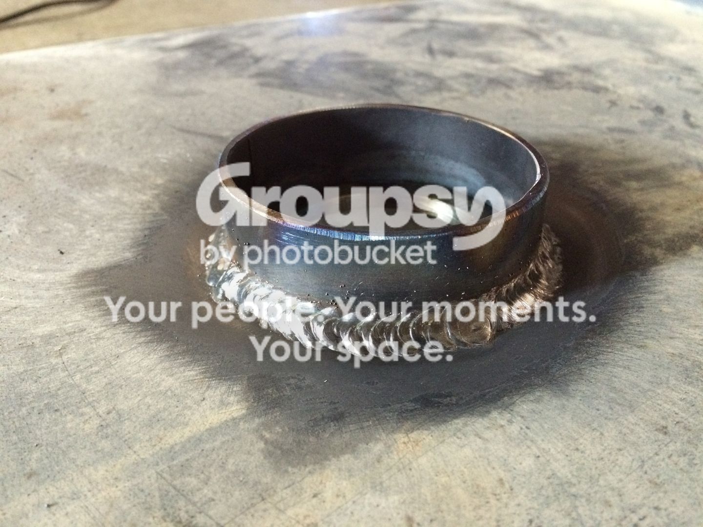

And I also installed a fill and inspection port to the top of the axle

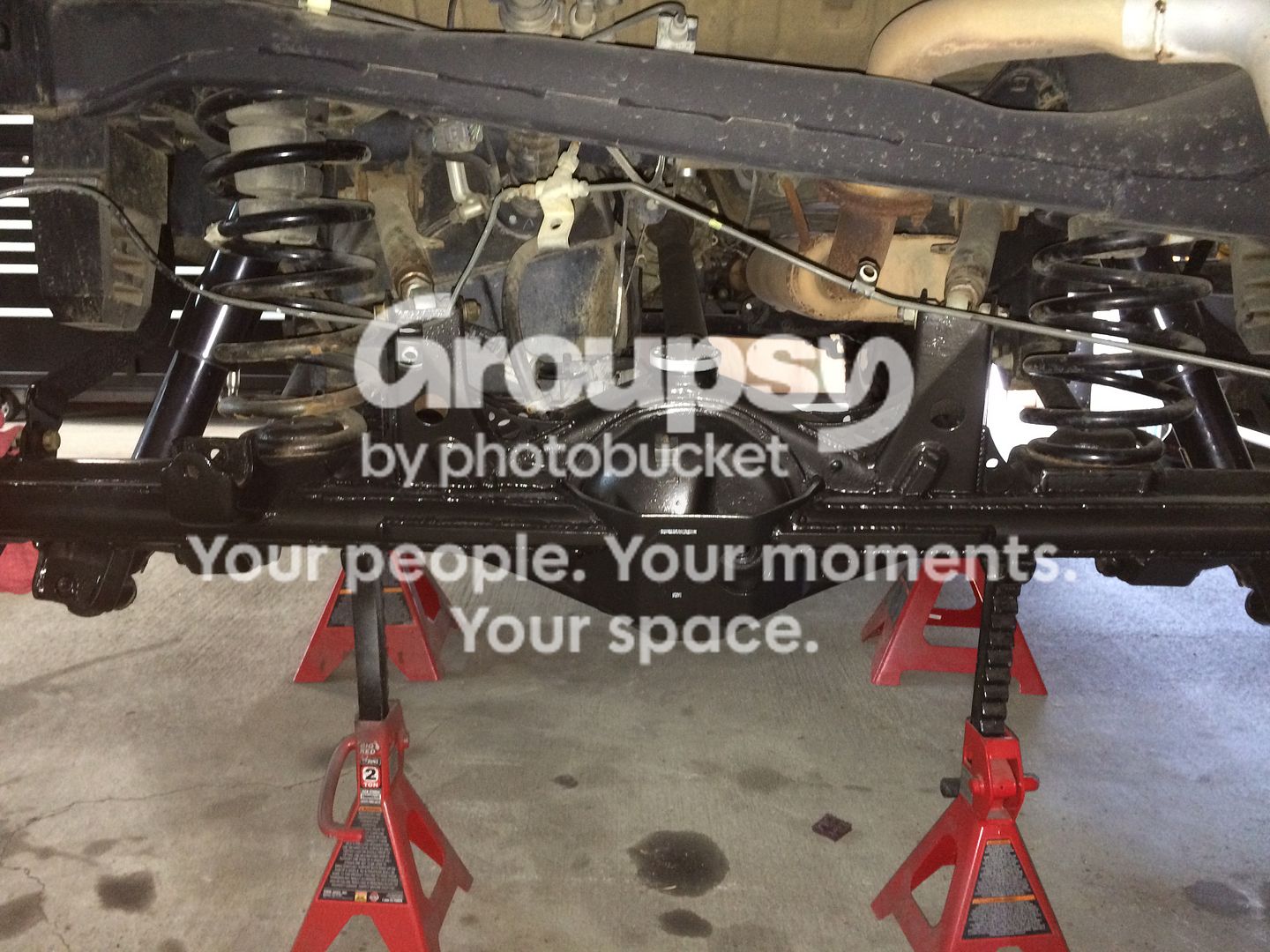

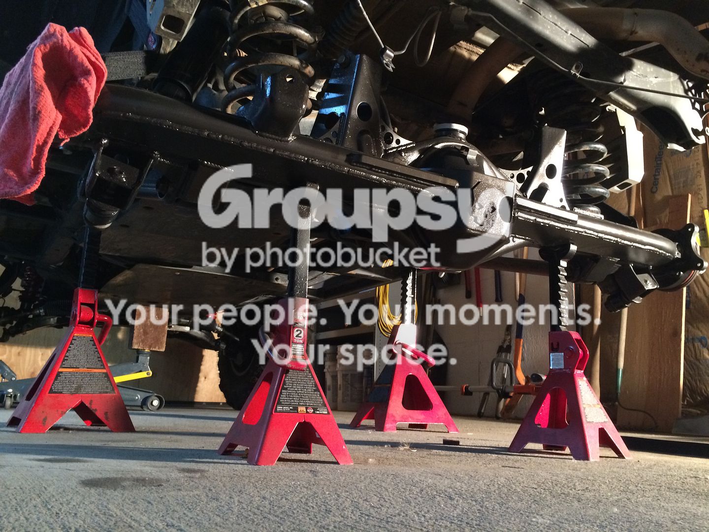

And here it is all painted and ready to be installed under the 4Runner

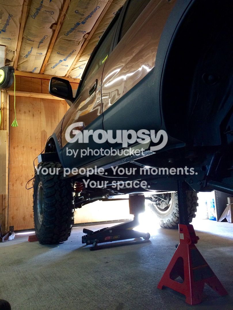

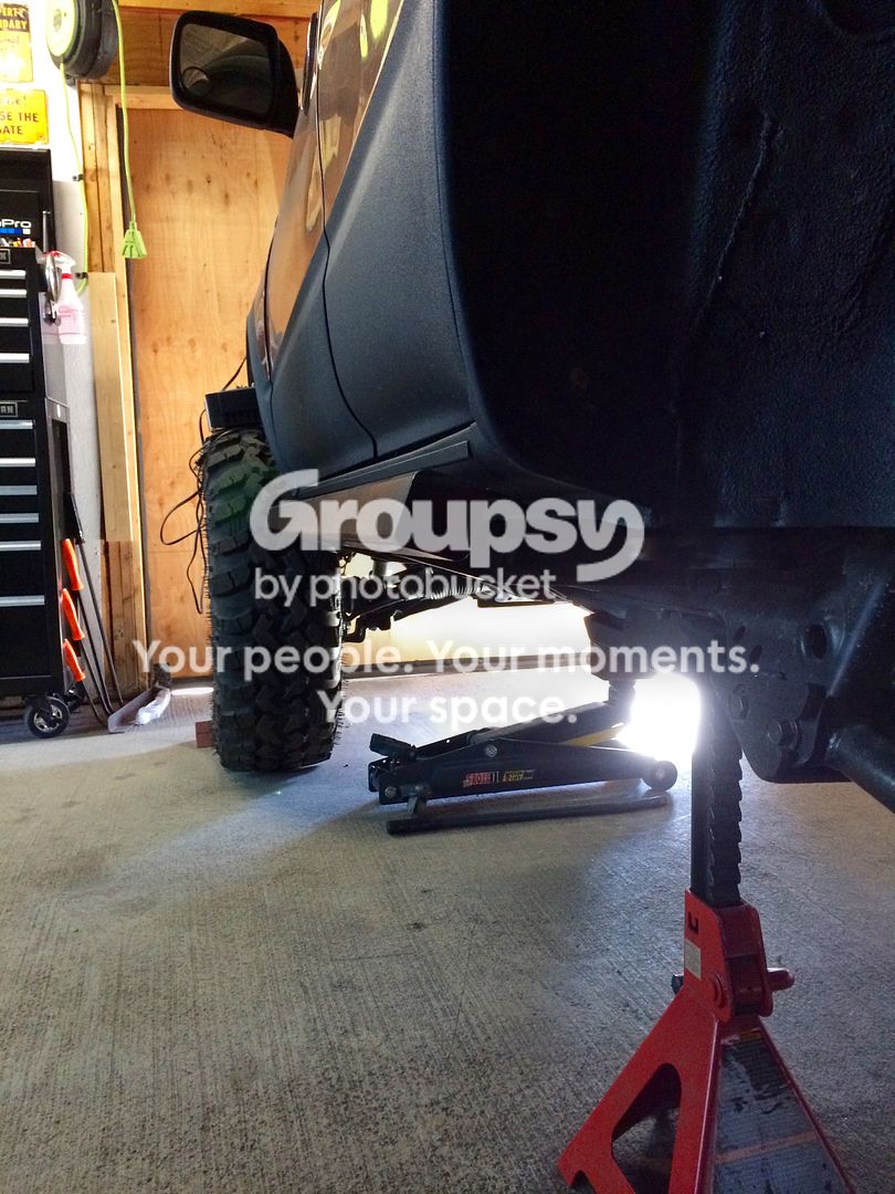

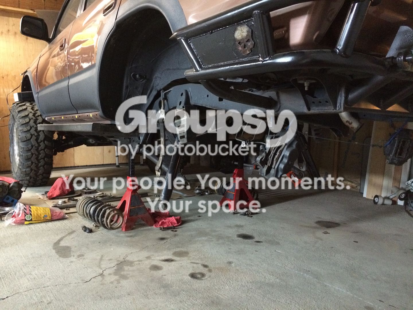

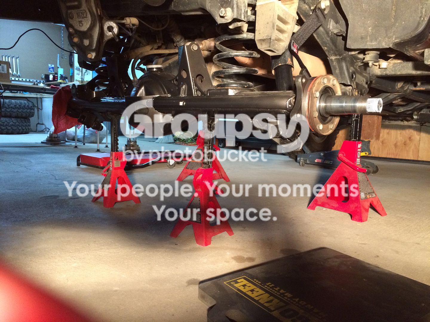

Old housing removed
New housing installed!

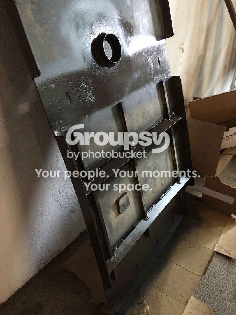

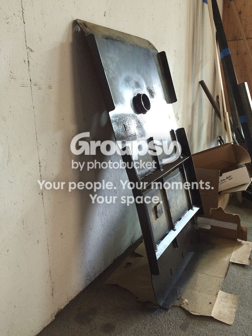

I wanted to make a few modifications to the belly pan section of the skid plate before I reinstalled it. The first was to make an access hole for the transmission drain plug; snow wheeling and towing my trailer around is hard on the transmission so being able to drain and fill the transmission on a regular basis is important. I used a hole saw to cut the hole, then I welded a section of tubing around the hole to add some strength and keep ATF from running down the skid plate when I drain it.
Next, I added some more bracing to the skid plate. I installed three sections of ½” solid bar previously, but the skid plate still deformed. This time around I added two more sections of angle iron on top of the previous bracing, we'll see how it holds up.

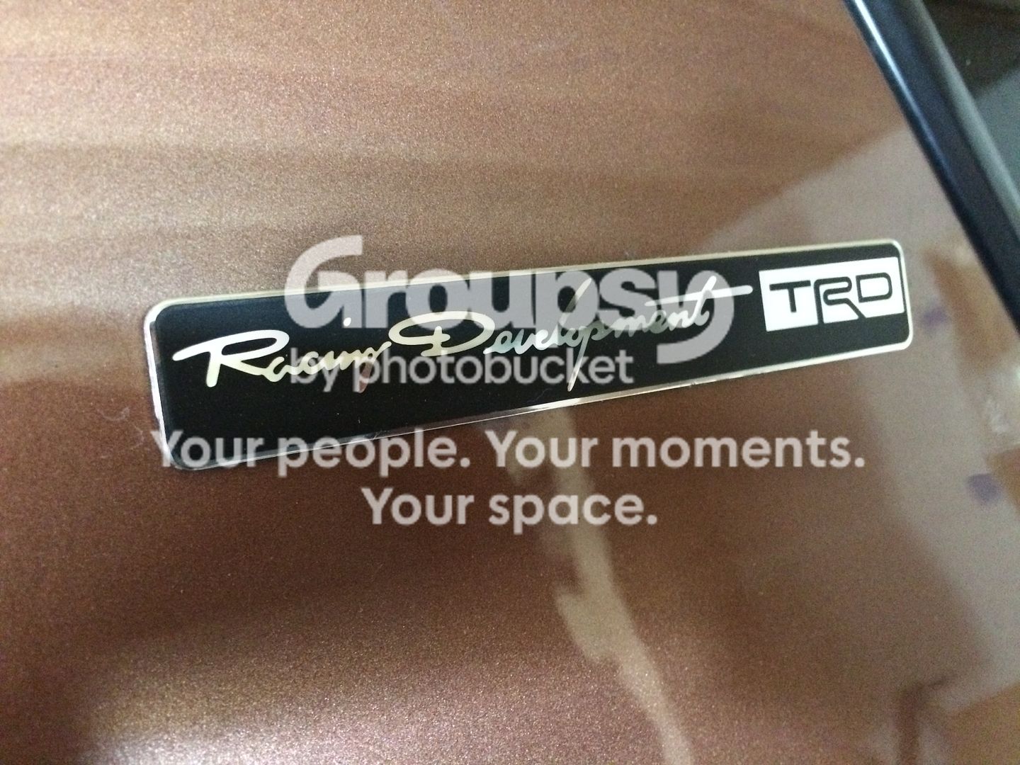

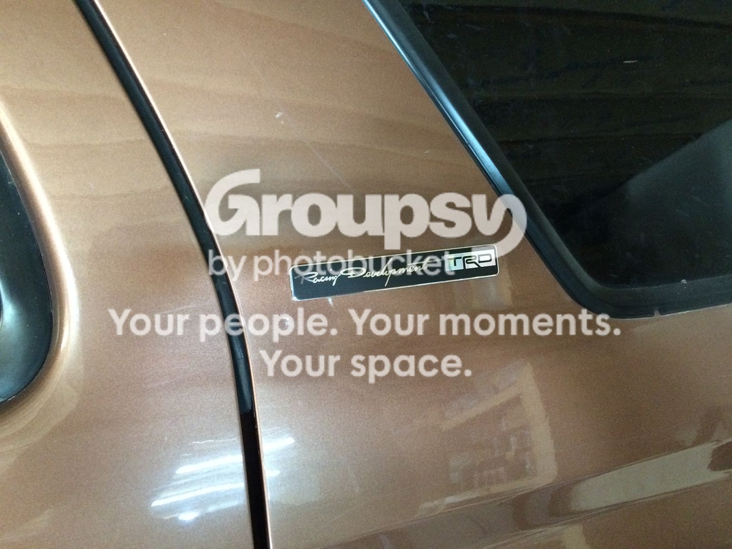

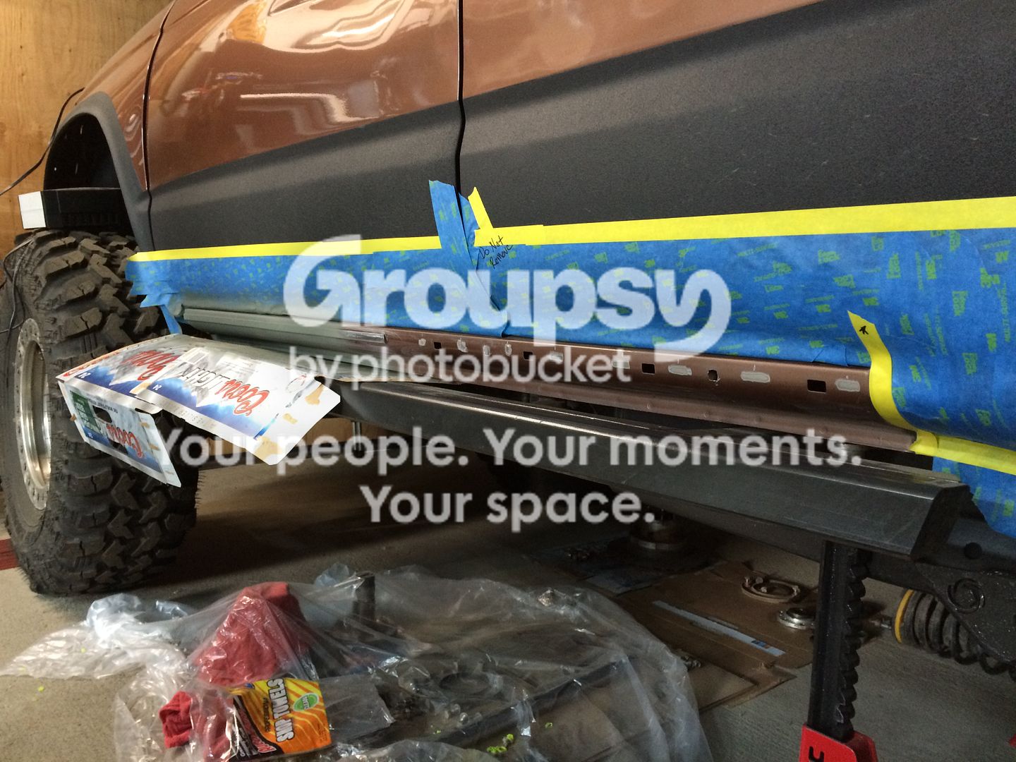

I didn’t like how the Limited emblems looked on the side of the 4Runner, with the black bedliner the chrome emblems stuck out. I removed them, but found that they had been installed when the paint was still soft and it made a small depression. So I looked around and found these, the black and chrome tie the truck together and they look stock.
The next project was filling the holes on the lower rocker panel. With the position of the rock sliders it was going to be a major pain to fill every hole, so I decided to spot-weld a trim piece that would cover the holes.
Before
During
And after
And then I made even more work for myself...

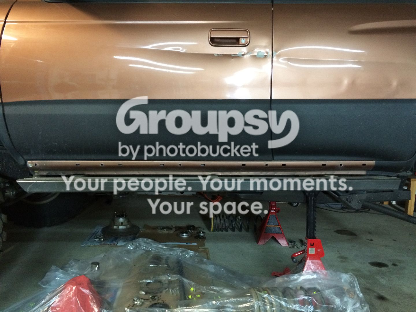

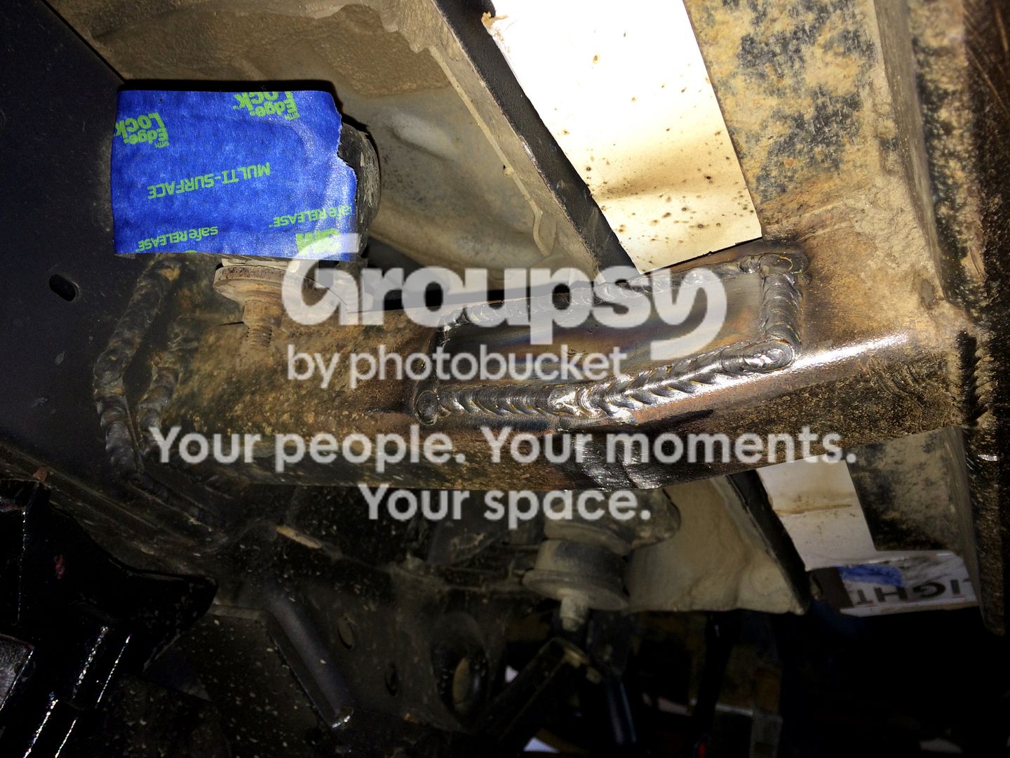

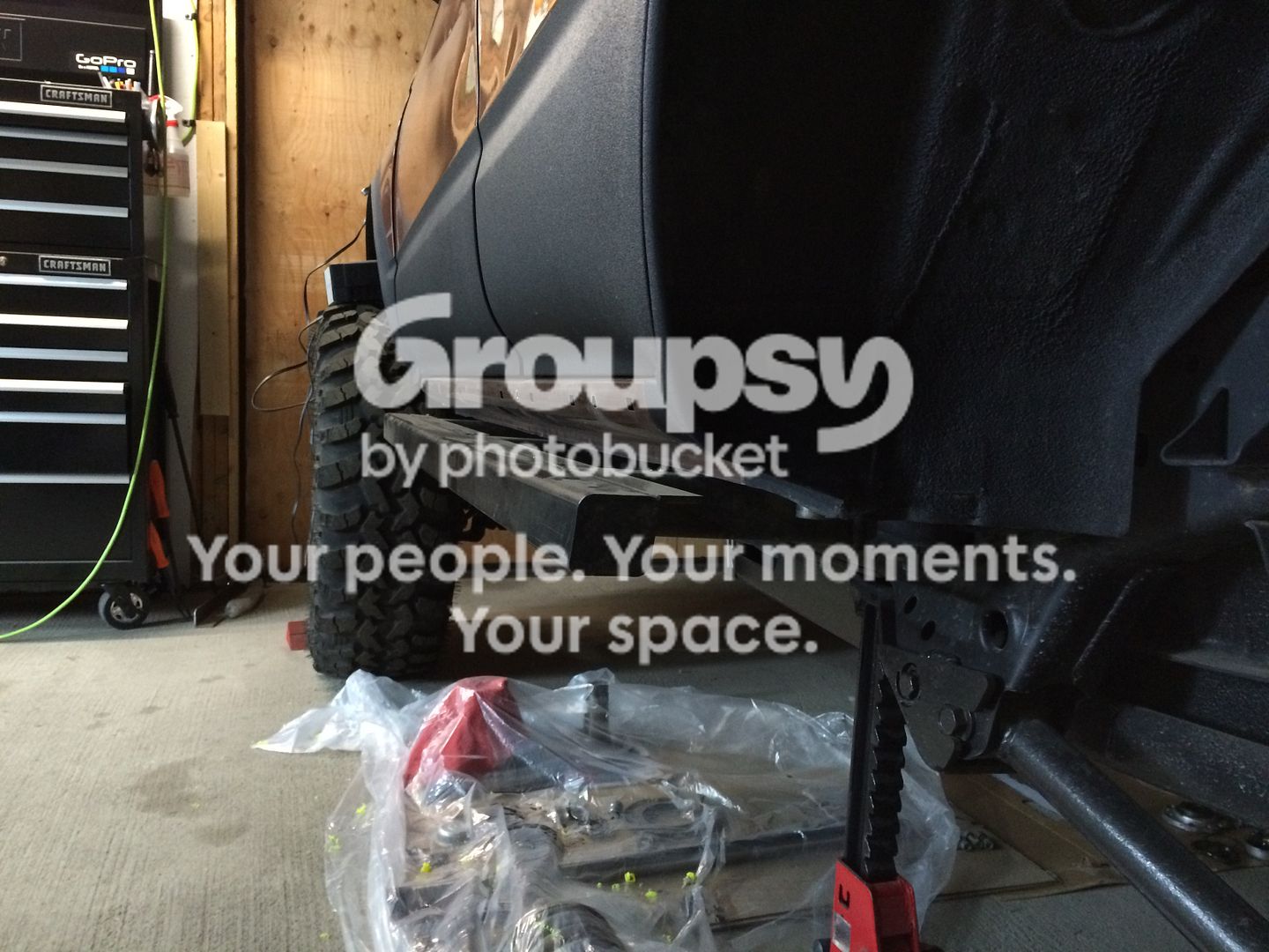

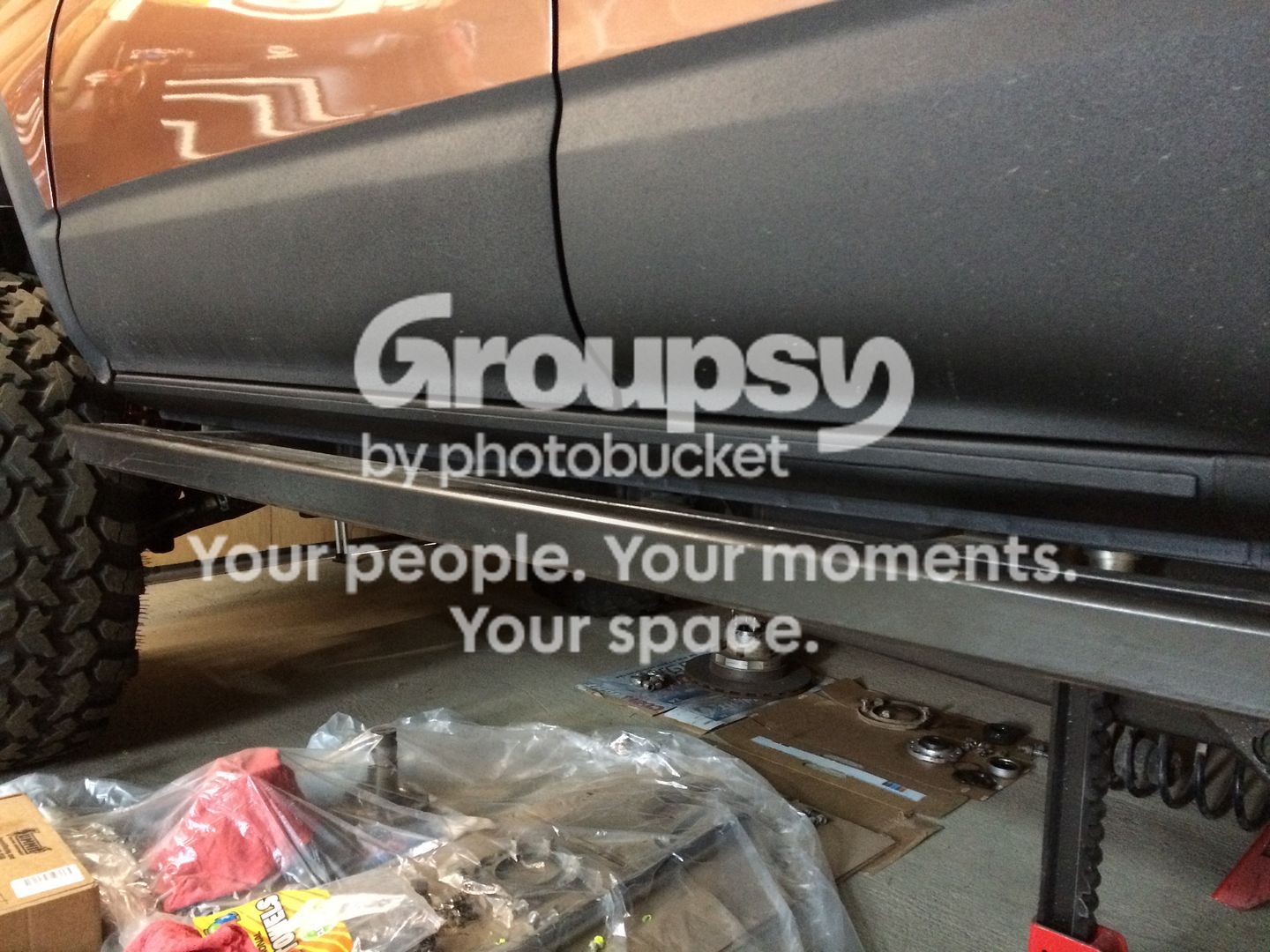

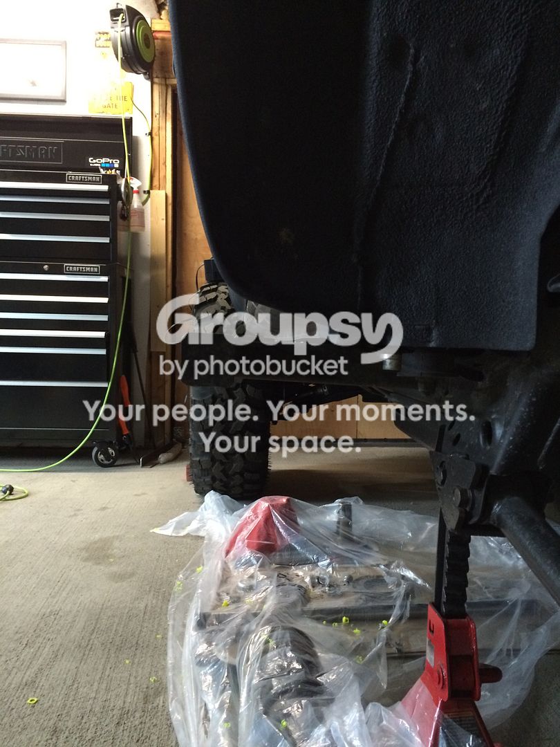

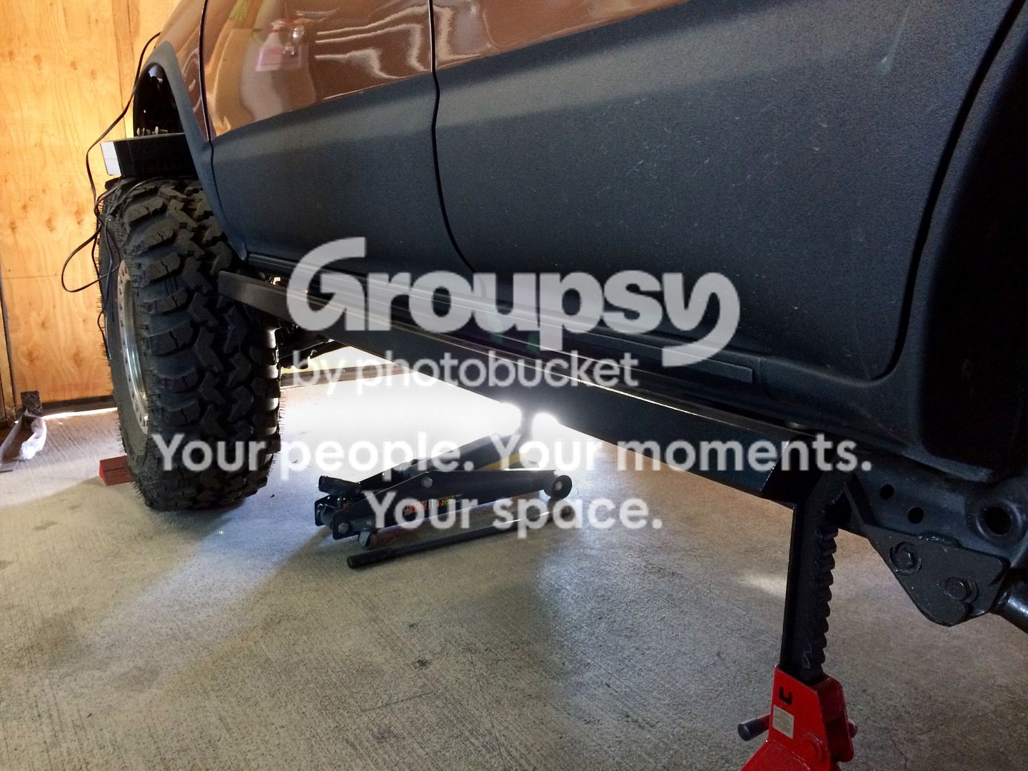

I didn’t like how low the rock sliders sat now that the plastic cladding was gone, here is what I’m talking about.
So I decided to angle the sliders up towards the body. This would A. clean up the body line, and B. add over 1 ½” of additional clearance. That’s pretty much a win-win, except for the extra work that’s required.
Definitely like the look of the angled sliders vs the flat ones. Added clearance is always a plus!
