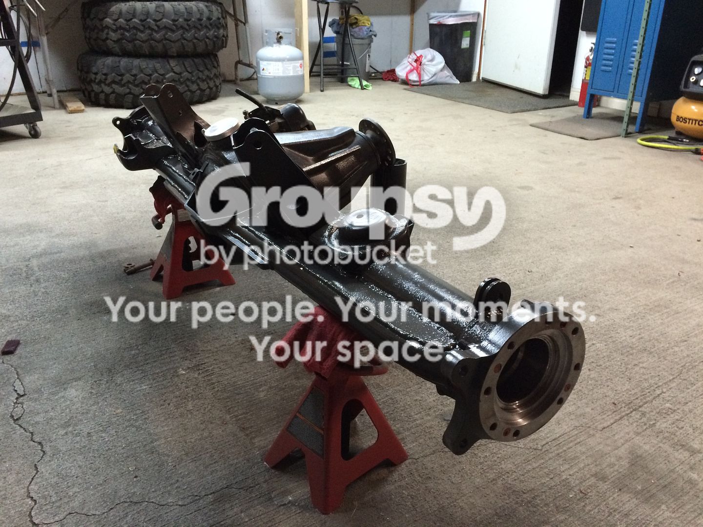

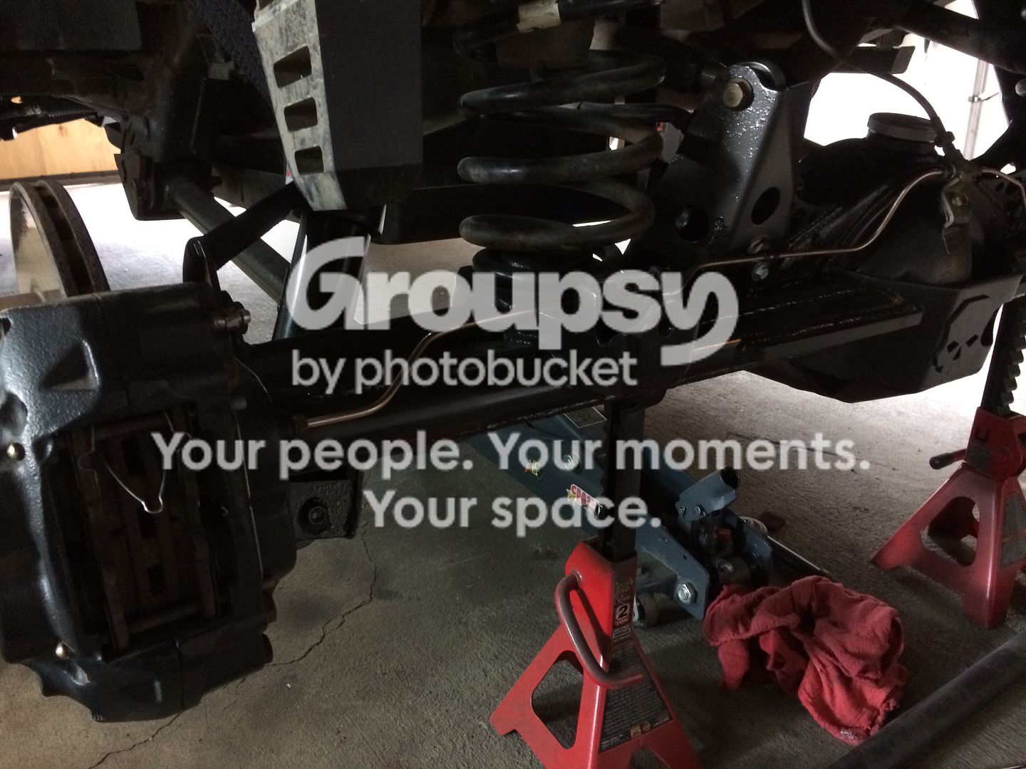

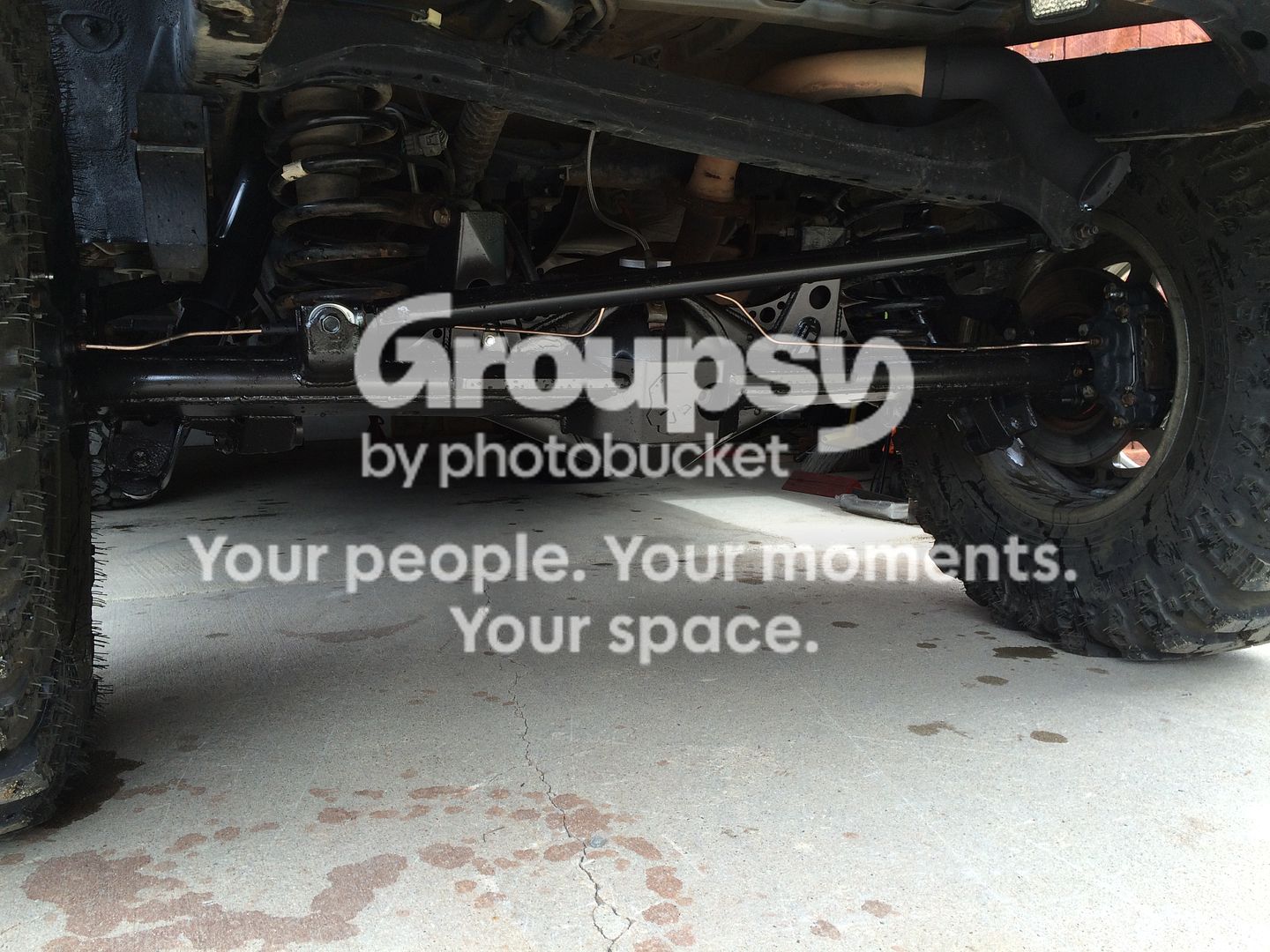

I got the rear axle assembled and made some new brake lines

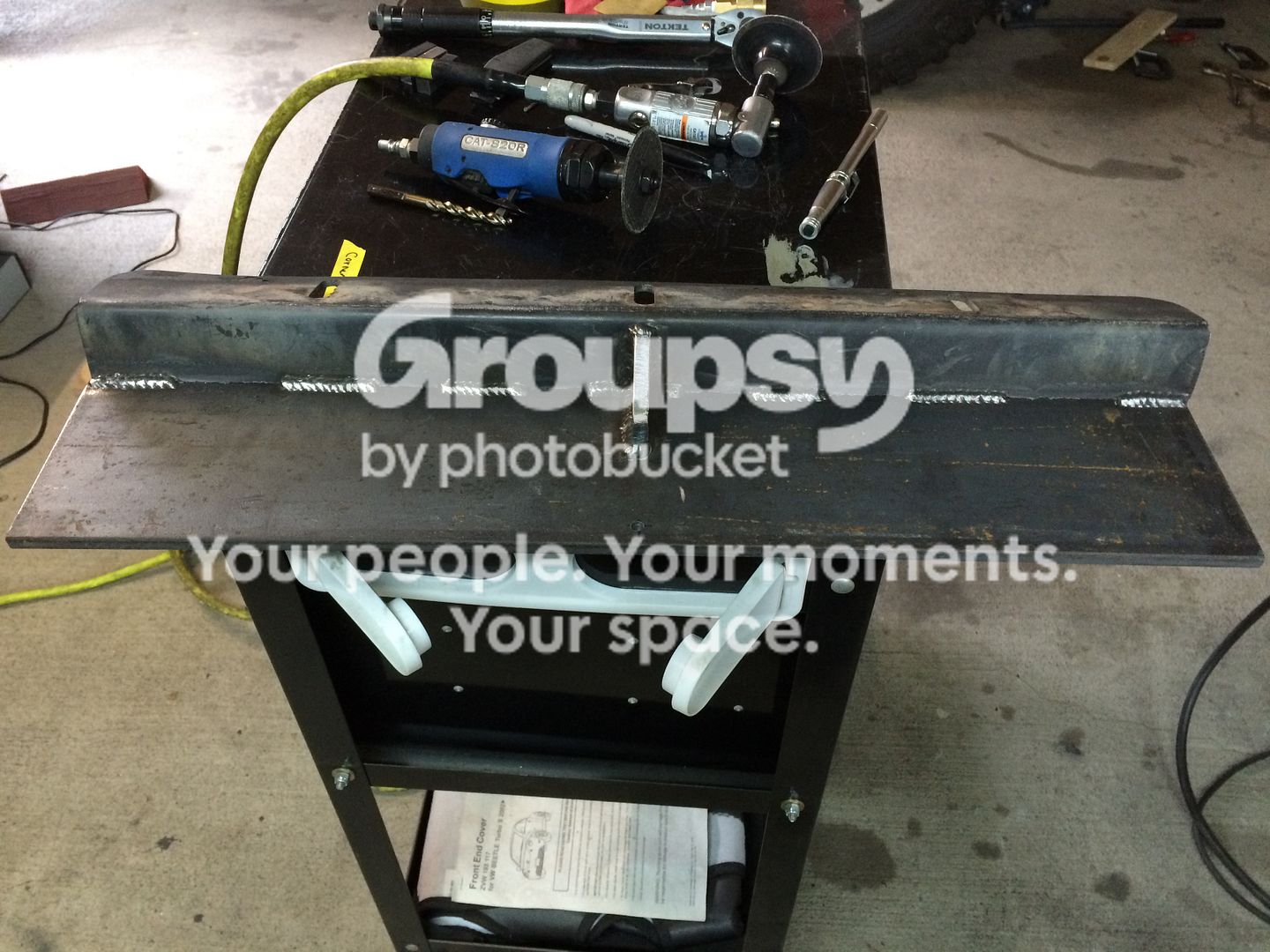

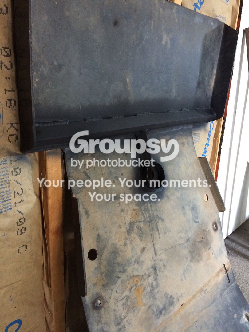

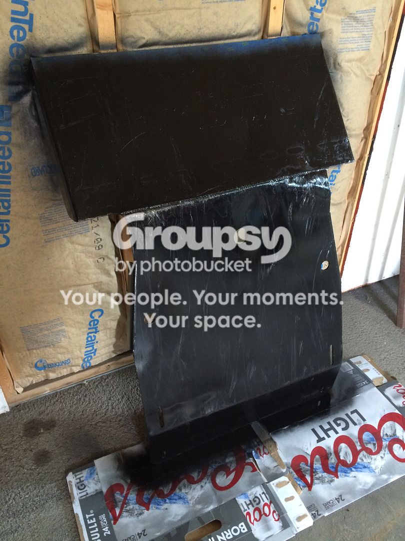

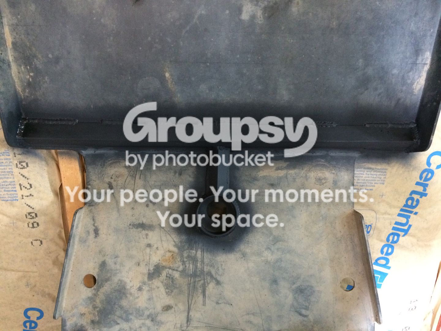

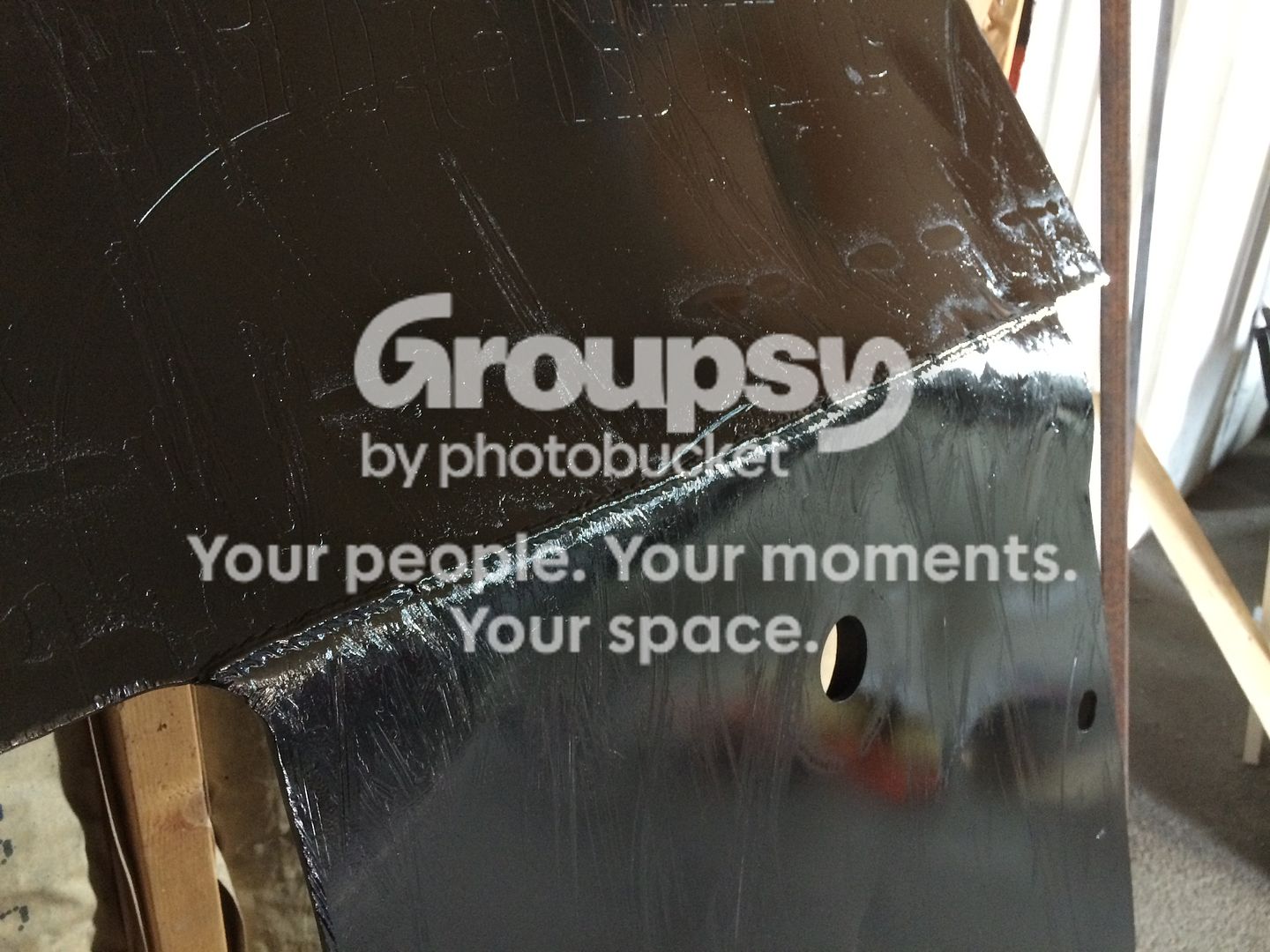

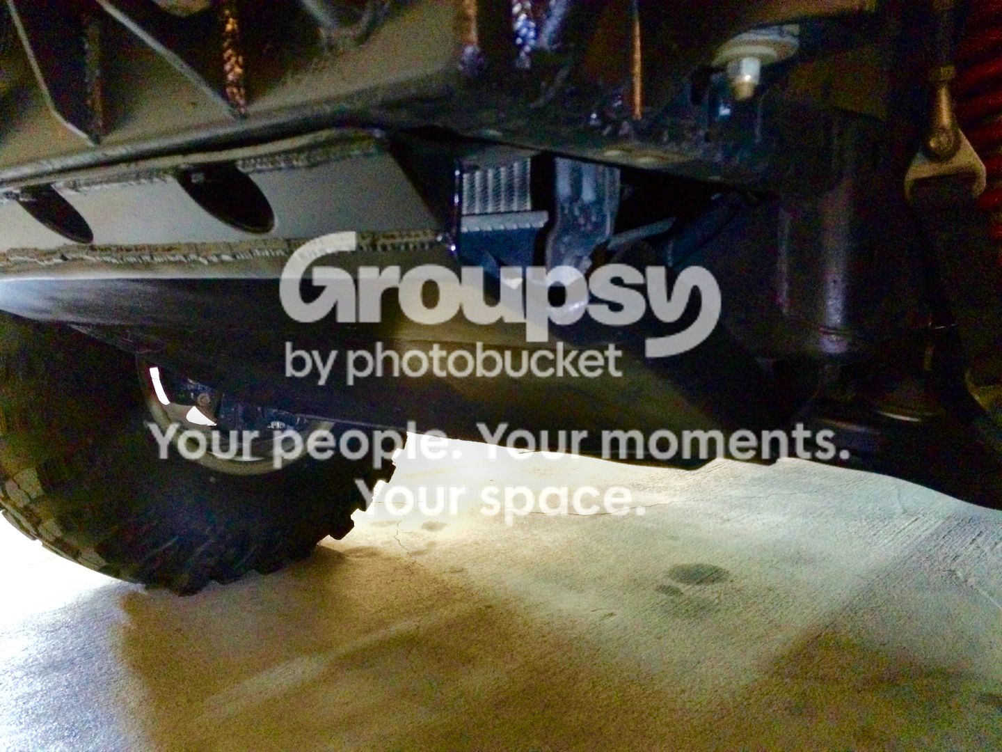

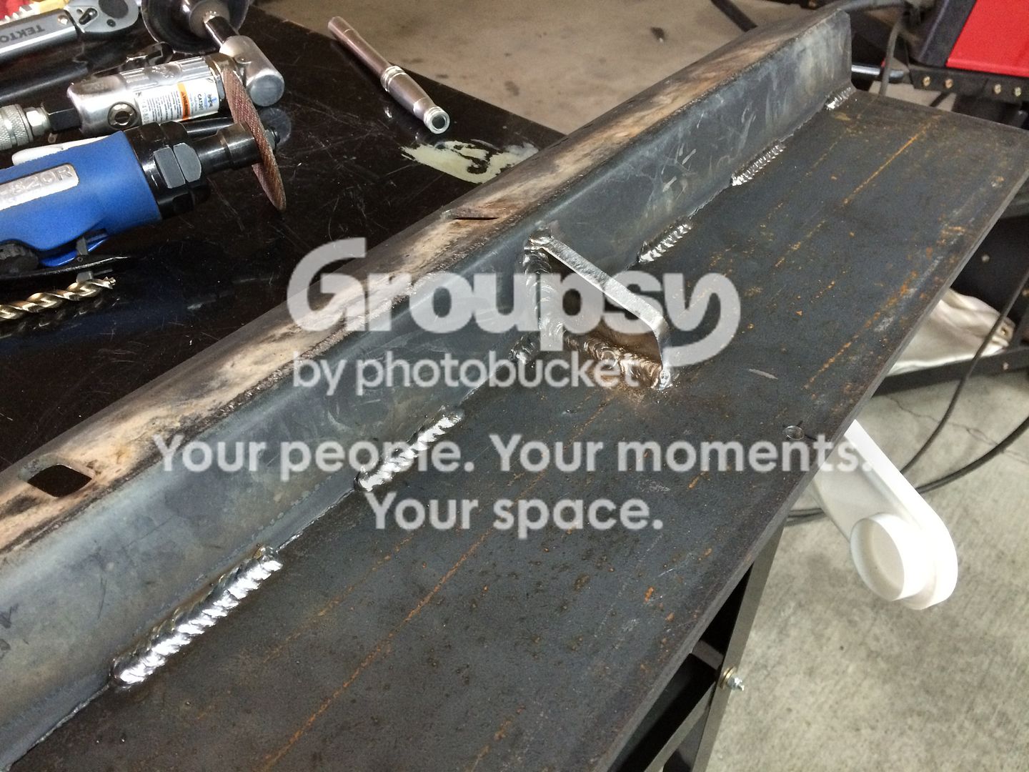

The front skid plate was hammered and wouldn't bolt back up to the truck, so it needed some work. I started by cutting the leading edge off the skid plate and making a relieve cut on the lower front section of the skid. I added a section of tubing to the engine oil drain hole to keep oil from running down the skid, and I added some extra bracing to the lower leading edge of the skid where it seems to take the hardest hits.
Then I welded the the skid back together where I made the relieve cut

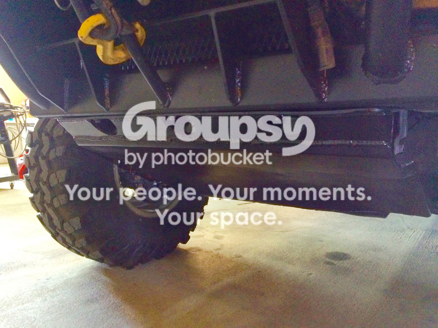

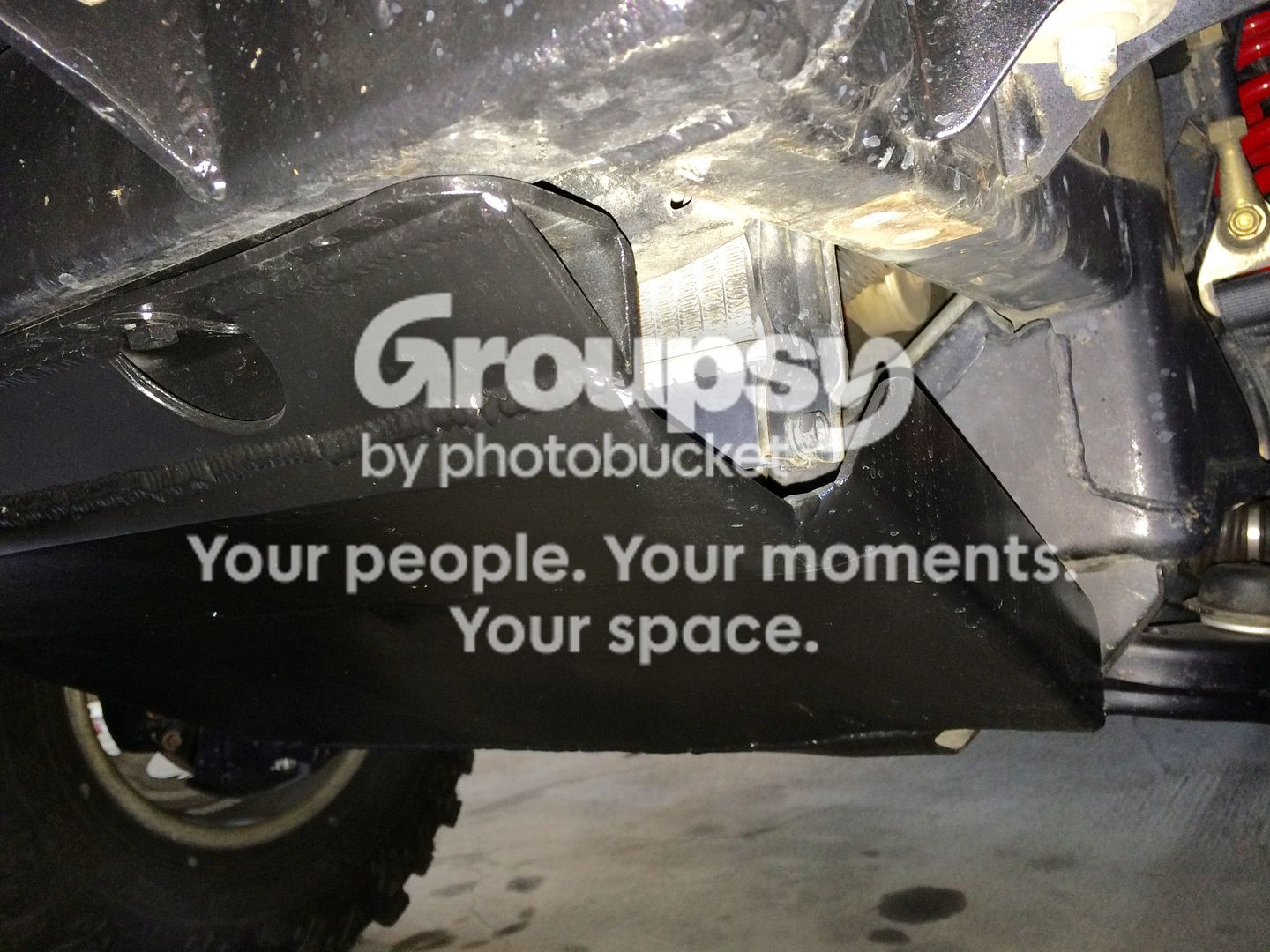

Instead of having the front of the skid plate mount to the stock flimsy crossmember I relocated it to the main structure of the front bumper. I had to extend the skid plate a little so I used some 3/8" plate, it's total overkill but I needed something that was solid enough to reform the 3/16" skid plate back to straight.
And here are a couple crappy pictures of it installed and done, I'll take some better pictures when I get time.

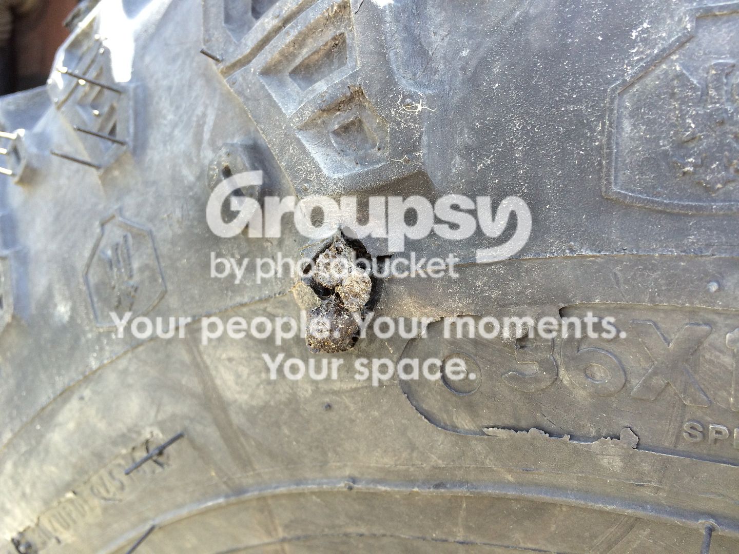

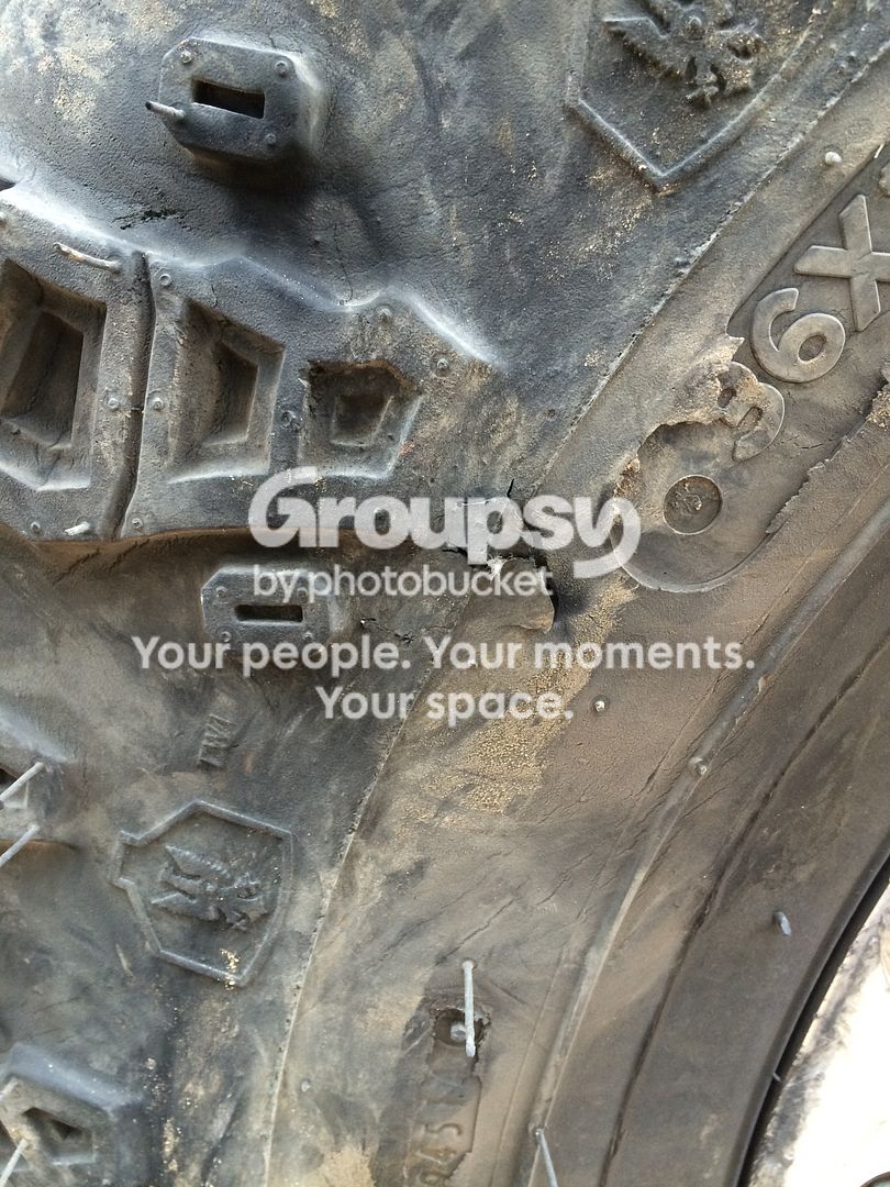

The following weekend I decided to take a short trip behind my house, there was a trail that I’ve never had a chance to finish and it seemed like a good time to check it out. Towards the end there were a couple down trees, one I was able to drive over and another I winched out of the way. Coming back down the trail I noticed that the 4Runner wasn’t handling right, I got out and saw this. Needless to say I wasn’t very happy!
I was able to plug the sidewall and get home; but with less than 500 miles on it, and all the work that had led up to this, I had no choice but to park the 4Runner for a few weeks and focus on other projects around the house. And, to add insult to injury my laptop met the end of it’s life a couple days later. No truck and no computer makes Jeremiah a very dull boy!

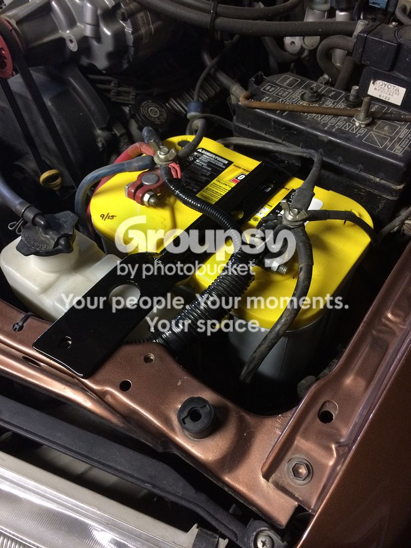

After a few weeks of hard work around the house I made the order for a replacement tire, and I waited for it to show up. Between the month that the 4Runner sat after the Jamboree, and all the time it sat last winter, the battery was on it’s last leg. I couldn’t get it to hold a charge for more than a couple days, and even at the Jamboree I had issues with the fridge shutting down due to low voltage. I had no choice but to order a new battery, especially with the amount of wheeling I do alone.
This time I went with a Yellow Top Optima, I was able to get it local and I figured I would give it a shot. I had to make a new battery hold down but that didn’t bother me as I was never that happy with the last one.
Man, that's a hard couple weeks for the 4Runner. Really sucks about the tire.
Yeah, it's been a rough summer. I guess it's just part of wheeling.
It's not the end of the world. I can patch the old tire's sidewall, run a tube, and have it as a full size spare. I've also had the old battery on the charger for the last week, it could make a good second battery for the trailer. The trailer is always plunged in, and has a solar panel. It's just outside the replacement warranty, but it's possible I might be able to get it prorated towards a new battery if I find the right store.
Bummer on the tire and battery! That battery tie down is nice looking.
