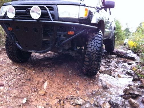

Awesome truck! Do you plan to add some protection for the radiator, such as a plate over the center cross section? If you're worried about air movement you could always drill holes in it.....
Something like this.. Just a suggestion, mind you.

I have a Budbuilt skid plate that should protect the lower section of the radiator. If I feel it does not offer enough protection then I'll add a section of tube between the frame rails.

I was thinking about continuing the front angled section of my bud built up to my chopped arb. Then cutting holes for the bolts to go into it. It may work for ya. Just extend it up to the bumper and then make some little tabs to attach it to the bumper. It may work if you feel you need it. My deal is that the entire front vertical section of my bud built is exposed (like yours is) and one good smash on that will rip the flimsy front stock X-member it bolts to. The welds holding the factory x member are all ready starting to rip. Just a thought. bt that bumper looks great
Thanks for the input, I've also thought about doing the same thing. For extra strength, and to smooth out the front end for snow wheeling (that way I don't have that lip digging into the snow). I'm going to wheel it for a little while and see how it does, I have enough big projects that need to be completed before I start on little stuff like that. Thanks again for the idea!
I had busy day working on the 4Runner. I wanted to finish up a couple small things so I could install the front Budbuilt skid plate. I still need to take care of a couple more things before the belly pan can be installed, but I feel better having the front section in place.
First I replaced the steering rack bushings. I bought the kit from Wheelers Off-Road and used this write up on I8Mud. It was really easy; I didn’t have to remove the tie-rods or the boots but I did have to remove my diff drop to get the long d/s bolt out.
Steering rack bushing replacement
I also replaced the front sway bar bushings and changed the front diff fluid to Royal Purple.
Then (with the help of a friend) I was able to install the skid plate.
