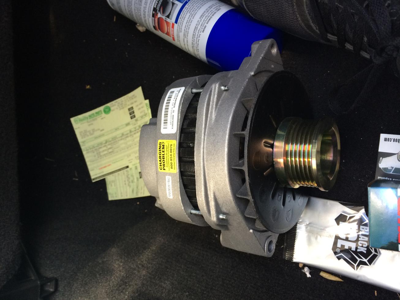

So I got some updates, I've done an alternator upgrade, added sliders (finally) and got a bumper! So check it out first the alternator;
You can defiantly see the size difference something that kinda bothered my about the truck was every time I rolled down my windows everything would kinda dim out and my radio would get a bit fuzzy. Also my alternator died on me the day before I did the upgrade.
As I did this and got the wire harness I noticed that it had no color coordination, but referring to doc2012's write up you will notice the harness is labeled as follows;
You don't need to worry about using the S labeled because it doesn't have a wire to connect anything to, the thickest wire goes to the Toyota white wire, the L labeled wire goes to the yellow Toyota wire, and the F labeled goes to the red Toyota wire. Like so;
Pretty straight forward upgrade and I'd recommend doing the big three to anyone who wants to do this too.
