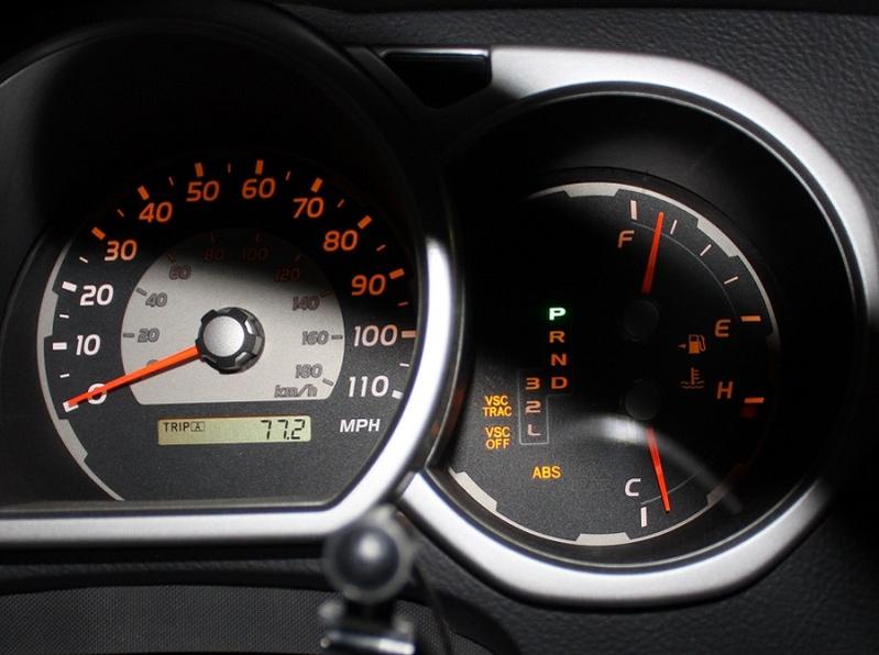

So I just tried this mod. I spliced into the white wire, used butt connectors to attach a wire on each end. Fed it up to through firewall to a spst switch. Plugged it back in under the dash. Now when I start all the lights for this mod are on before I flip the switch. Turn engine off and on try multiple times and it still lights up before I flip switch? What did I do wrong? Suggestions??

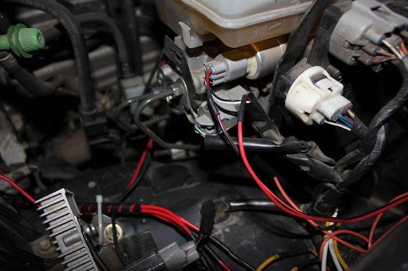

did this today.. spliced the wire.. soldered the new wires in.. OEM VSC OFF switch hacked..
has to be pushed in for the VSC to work as stock, which is fine.. took all of 45 minutes..

So I could've sworn I knew what I was doing but now I'm confused. If I just wanna disable the VSC I should put a switch on the Red line? And if I want to disable VSC and ATRAC I should put a switch on the Green/White line? I thought I had it figured but when I unplugged the green/white plug nothing lit up on the dash. When I unplug the red/white/black then VSC, ABS, and VSC Trac come on but not the car with the squiggly lines (which I thought was the ATRAC). Could someone help me out? Ultimately I want my ATRAC disabled.
Cut that red wire and...HIT IT!

Easy enough to splice it back together if you sell it or scare your wife or what ever.
Works in 2wd 4x4hi, 4x4low and with diff locked or not.

Car off, flip switch, car on...no nanny, no click,click,click no beep,beep,beep no tick,tick,tick. <--insert your own sound effects.

My hacked T4R.

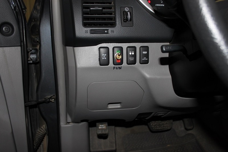

useless button
Anyone else have an RSCA disable button? Has anyone tried to use this button for the disable trac, vsc mod? I dont really see a reason to disable the RSCA and this is a factory switch. with a little stencil work that button can say anything for me.
I just did this with a rocker switch. I had a green and white/black wire in the pressure switch. Cut the white/black, soldered speaker wire to the switch (I have locker, AC120v, RSCA and one blank in the dash - used the blank) and it works great.
I understand wanting to keep factory look but those switches would be difficult to wire up... All I can attest to is the simplicity of 2 wires to a simple switch, glad I kept to K.I.S.S. Plus if you ever sell, you'd not only want to undo the ABS/VSC mod but also undo the RSCA switch but just my $0.02.
I got a lighted dependent OTRATTW switch, have not hooked up the lighting but it works fine as-is, may just leave it alone. THANKS!
The RSCA switch is a momentary contact switch, it doesn't latch on/off.
So no , unless you use it to trigger a latching relay.
