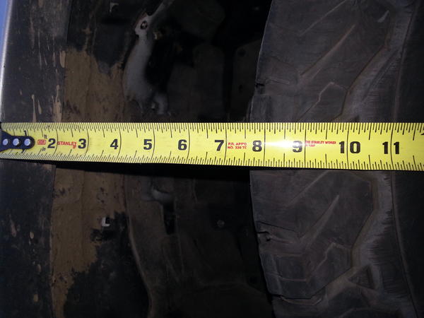

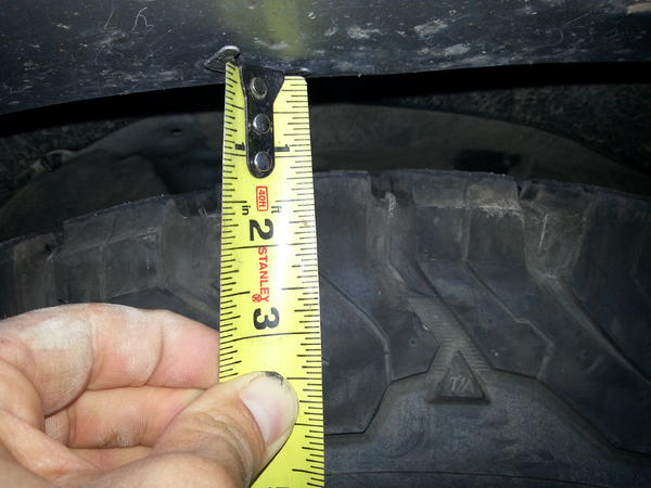

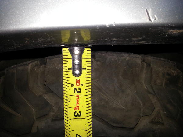

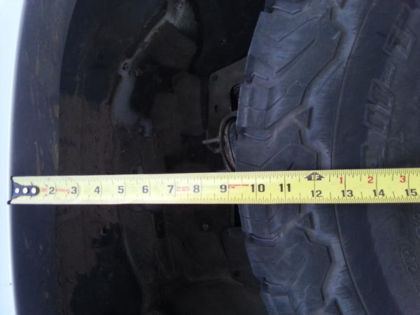

Since there are differing opinions on whether disconnecting the front sway bar makes a difference, I decided to test it on my stock height 96 Ltd.
Connected:
highmiles-albums-1996+4runner-picture42027-front-sway-bar-connected-stuffed-wheel-1-25.jpg
highmiles-albums-1996+4runner-picture42028-front-sway-bar-connected-suspended-wheel-7-5.jpg
7.5 inches - 1.25 inches = 6.25 inches articulation with sway bar connected.
Disconnected :
9.25 inches - 0.25 inches = 9.0 inches of articulation.
So, on a stock 3rd Gen, there is 2.75" of articulation gain with disconnecting the front sway bar. In the mountains, that really helps.
Connected:
Disconnected :
