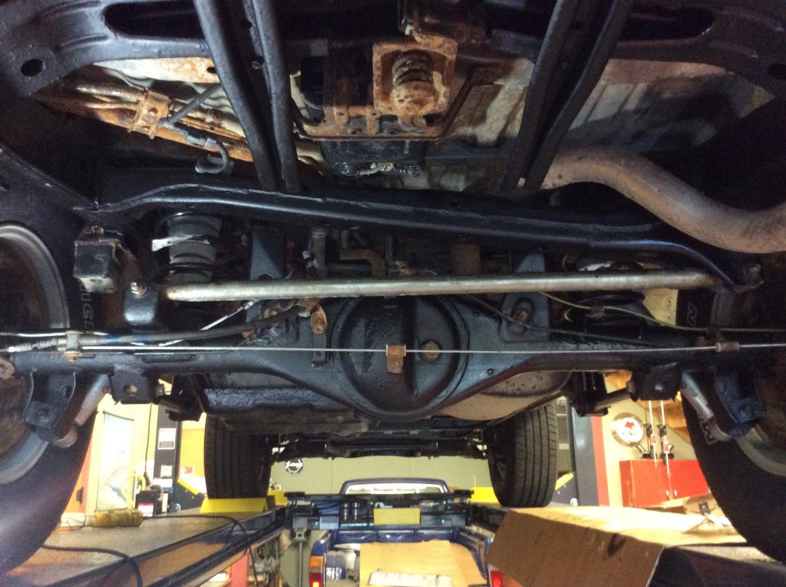

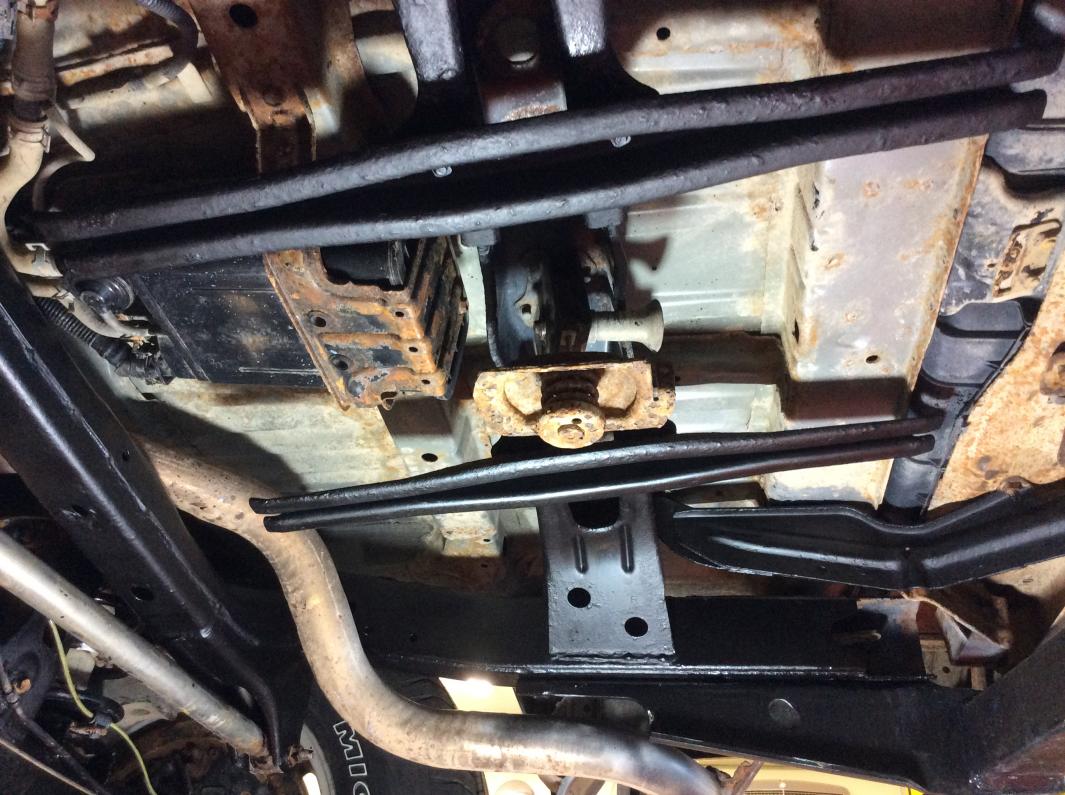

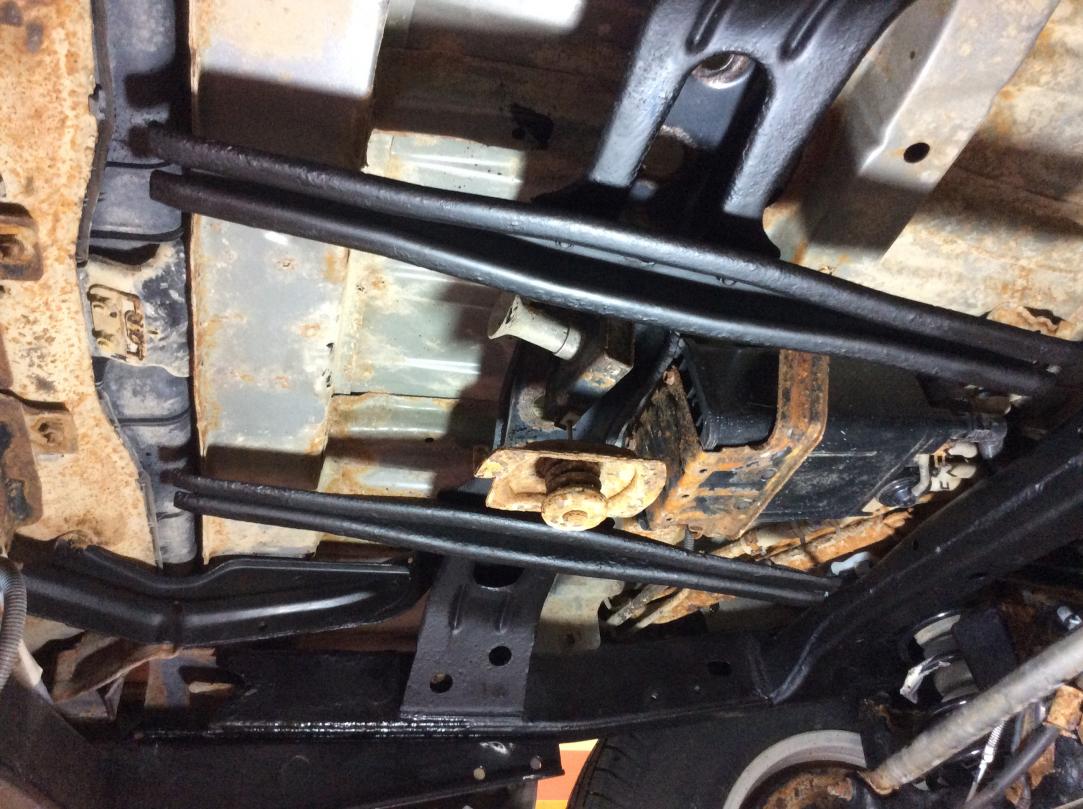

Been down same road as many on this thread......
Just about to call it done on applying POR-15 to frame, spare tire mounting, rear axle housing and factory skids.
Been a long journey with heavy duty wire wheels on angle grinder and a compact needle scaler......what a messy job.
Did not include front suspension area as didn’t really see the need as these trucks seem to need attention towards the back end.
The plan is to apply Fluid Film annually to entire undercarriage, including inside frame rails and rockers.
Thankfully I found the frame to be solid in all areas, even by the muffler.
Hoping this investment in sweat equity pays off and I can safely use this as my DD without fear of destroying the frame from salted winter roads.

I'm planning on doing this the next few weeks. Will probably drop the rear axle so I can get it coated really well and have better access to the frame. Did you just tape over the bolts and holes you didn't want to get POR15 on?
Used a bit of painters tape on some and others I just carefully painted around.
I was tempted to drop rear diff and exhaust but after removing all flaking rust on frame and not finding any suspect areas decided it wasn’t necessary.
I also think most rear diffs that leak from the housing due to rust usually leak from the cover area and not on top of the housing so why go through all the work of dropping diff.
Thinking annual application of Fluid Film will take care of areas I didn’t treat with POR-15.
