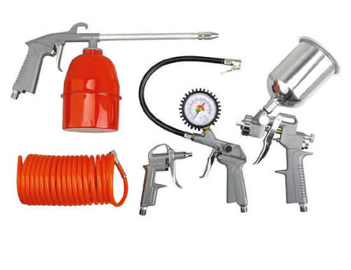

Oil spray gun
I bought this air tool kit on ebay to spray used motor oil with bit of gear oil to underside of the runner including inside the frame. It was bit hard to find this kind of a oil spray gun (top left, red gun). One day, a Canadian seller listed this on ebay and I didn't think twice to by it. Cost $50 to my door.
Does this have a name, or any way to reference it in a search? I sure would like to use my used oil!
Thanks for the suggestions! I don't have an air compressor so was thinking of modifying a $10 garden pump sprayer with an extended nozzle. I wonder if it would be able to spray a thicker fluid like oil.
IMPO - a pump sprayer, only transfers thinner liquids / probably not oil or wax-oil effectively.

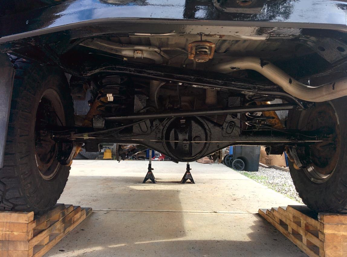

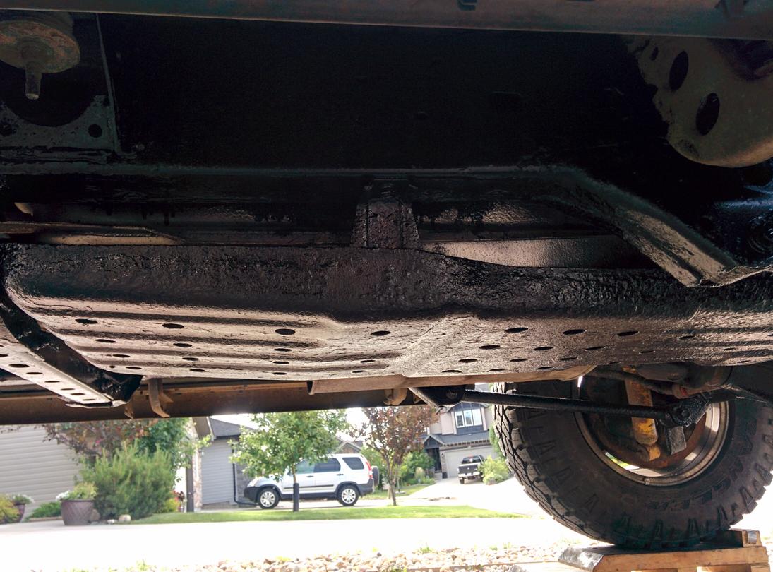

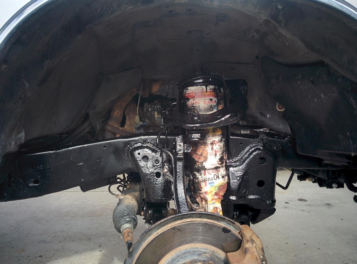

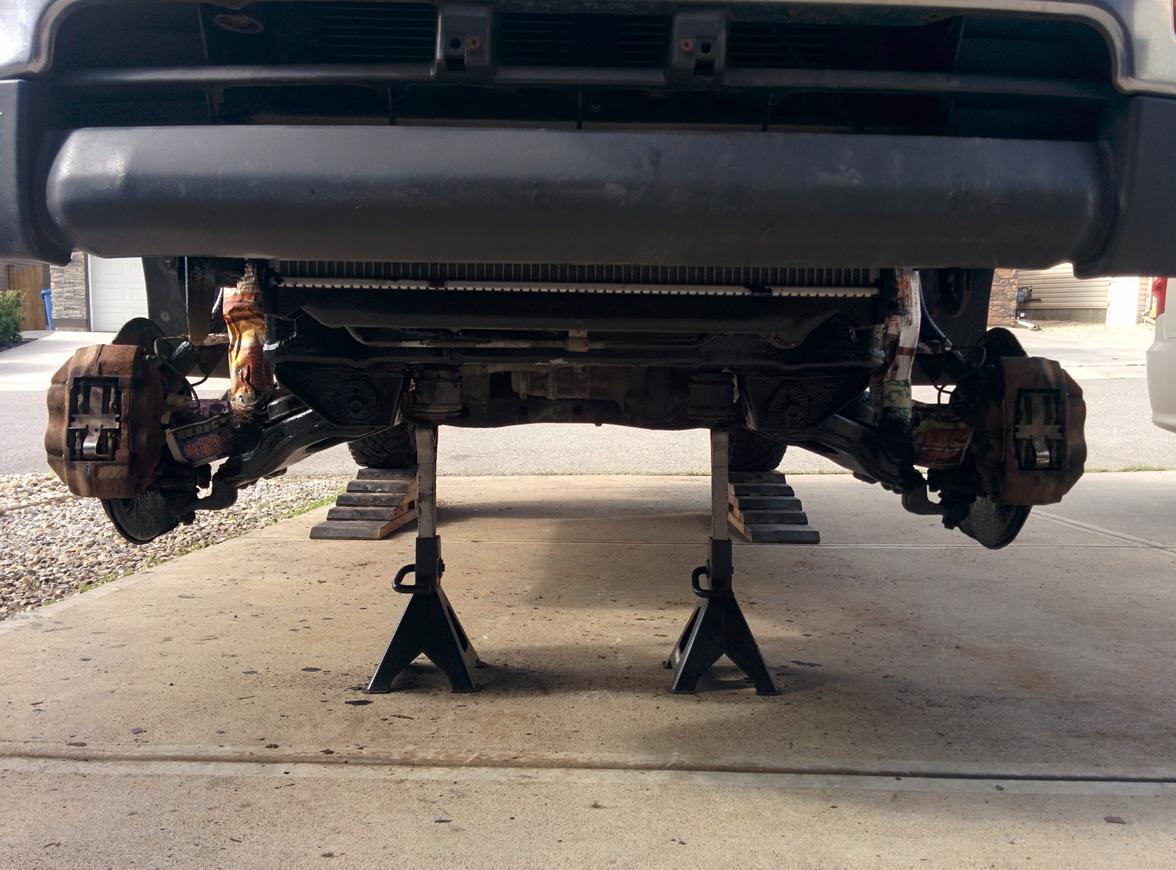

As an update, after doing a bunch of reading I went ahead and bought a small 1L pail of POR 15. Surprisingly, this stuff goes on really thin so one pail was enough to do the entire frame, fuel tank skid plate, rear axle, and control arms. Without taking the body off, I would say about >90% of the frame is doable. Took me about 20 hours to do this, 2/3 of which was just prep work. Definitely VERY messy work!
Went through the entire frame with a wire brush (hand and power drill), screwdriver to pry away some of the flakes, and also a nice degrease + rinse. Then I painted on the POR 15 with a small paint brush and also sprayed on a final layer of Rust Check black rust paint because apparently POR 15 is UV sensitive. My frame mostly had surface rust, including some larger flakes, but nothing that was too serious.
This stuff definitely feels like it'll hold up well. I plan on taking the truck in for a professional Krown rustproofing inside the frame rails and various body panels. We'll see how this POR 15 stuff holds up after the winter.
Wish I took better before pictures, but here are some of the after shots.
