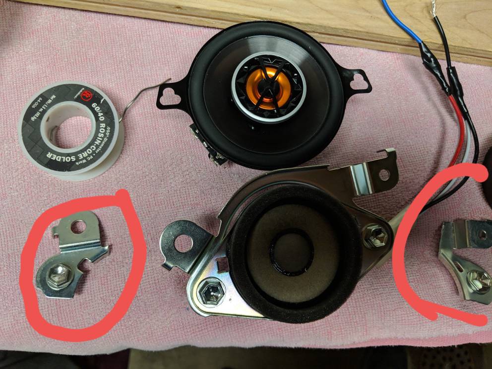

Those are the factory speaker brackets. You'll see pics of them attached to the factory speakers, early in this post.
You mean the ones circled in red? Are they just cutouts from the OEM mount? 20190124_002105.jpeg

After seeing a few posts about speaker upgrades, I decided to do one to the dash speakers in my '18 TRD Pro, and thought I'd share. In short, this lower cost, relatively easy upgrade is well worth it, and makes a huge difference in sound quality!
