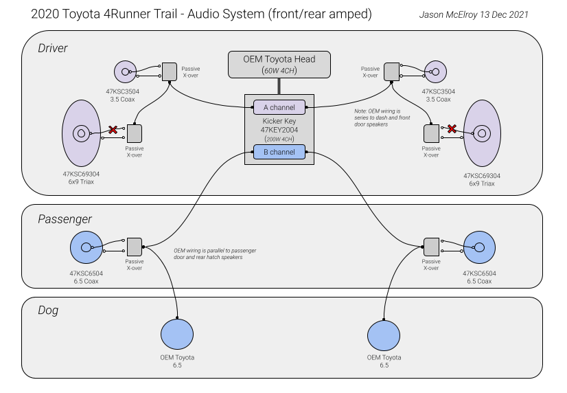

I too shaved the stock brackets to take the new speakers. Pretty straightforward. Used the Red Wolf adaptors so I didn't need to chop the stock wiring.
Next week. Amp install. Still waiting for some connectors to make a nice harness without hacking up the stock wiring behind the HU. It's a bit tight back there and there's not much extra length of wire to work with. Seems like it'd be a real PITA to solder a bunch of wires there.

My thinking at the time was that the Kicker Key amp will set the EQ as needed.
Have installed that amp as of a couple months ago and something's still not right.
Rear still sounds like mud despite now being amplified and having drivers changed out with nice ones. What the hell does the head unit send out on rear channels? Crap, apparently.
Front can vary greatly with source material from sounding amazing and well balanced to quite boomy.
Going to switch to biamp mode, amplifying the front door position speakers separately from the dash position speakers. Not sure how/if the passive x-overs should be used so I'll likely investigate some on line forums before rewiring.
