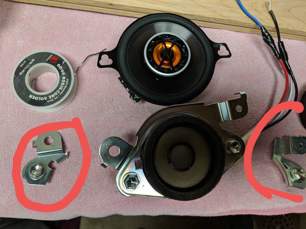

The construction differences between the OEM and JL Audio speakers are notable:
Removal of the stock speakers is easy. I started by using a plastic trim tool (part of a set like the ones at https://www.amazon.com/dp/B00ZRJCYQ2), and gently prying from the center/rear-most portion of the speaker grills to "pop" the two clips that hold them in.
From there, a small ratchet, extension, and 10mm socket was used to remove the two hex head screws (with Phillips patterns in the top, as highlighted in red in the image below). After these screws have been removed, the speaker mount and speaker can be lifted out as an assembly. Push the tab on one side of speaker plug/harness to release it from the blue "cap" of the stock speaker, and disconnect the speaker assembly (the second image below is one where the factory mount is still in place, but I suggest removing the speaker and bracket as an assemblly, via the Phillips head screws)

Next, I fabricated some mounting tabs out of 1" wide x 1/8" thick aluminum bar stock, which can be purchased at most hardware or home improvement stores. These didn't have to have as complex of a shape as I made them, and a simple rectangle would have worked, but mine are shaped like they are due to earlier plans changing a bit, and not wanting to re-make the brackets.
Rectangular tabs would be 1.75" long and .75" wide. Two holes are drilled in the tab, 1 5/16" apart. The smaller one at the top (which the Phillips head screw will go into) was drilled using a 5/32" bit, and the larger one was drilled with a 3/16" bit.
The hardware used to attach the tabs to the speakers is 8-32 button head machine screws that are 3/4" long, with matching nuts and washers. I put one washer under the screw head, two washers between the aluminum tab and speaker (for spacing), and one washer under the aluminum tab.
The Phillips head screw can be used to make threads in the smaller/top hole. It takes a little force to start the screw in the hole, but do this, tighten until snug, and then remove the screw. It is much easier to do this outside of the vehicle, than inside when mounting the tab/speakers in the dash.
This photo depicts what the tab looks like when mounted on the speaker. The Phillips screw was removed prior to putting the speaker in the dash. I put blue thread locker (aka Loctite) on the button head hardware, and tightened it fairly well, but just loose enough so that I could move/align the tab with the speaker in the dash hole.
