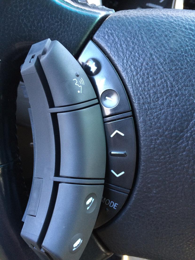

[MENTION=50507]CookieRoe[/MENTION] quick question. I received the right side cluster (84244-35030-bo) in the mail last week and they look like they have a different finish then the left side buttons I already have. The right side cluster seems to have a matte finish whereas the left side seem to be more glossy/shiny. I am wondering if there are different finishes you can order or if the left side controls are just 'worn'

I'm willing to bet that your left controls are just worn. The only differences in buttons are the colors, the textures of the buttons (I've seen them all....... 4Runners/GX/LandCruisers) are the same.
Realize your rig is 11 years old and 11 years worth of touching/rubbing is going to have some affect on them. About a year ago, I changed steering wheels on my 07Civic. I have an EX sedan and got an Si wheel. The buttons seemed to be "shiny". Finger oils/untold "Armor All"/UV exposure/etc etc. I don't notice it now.

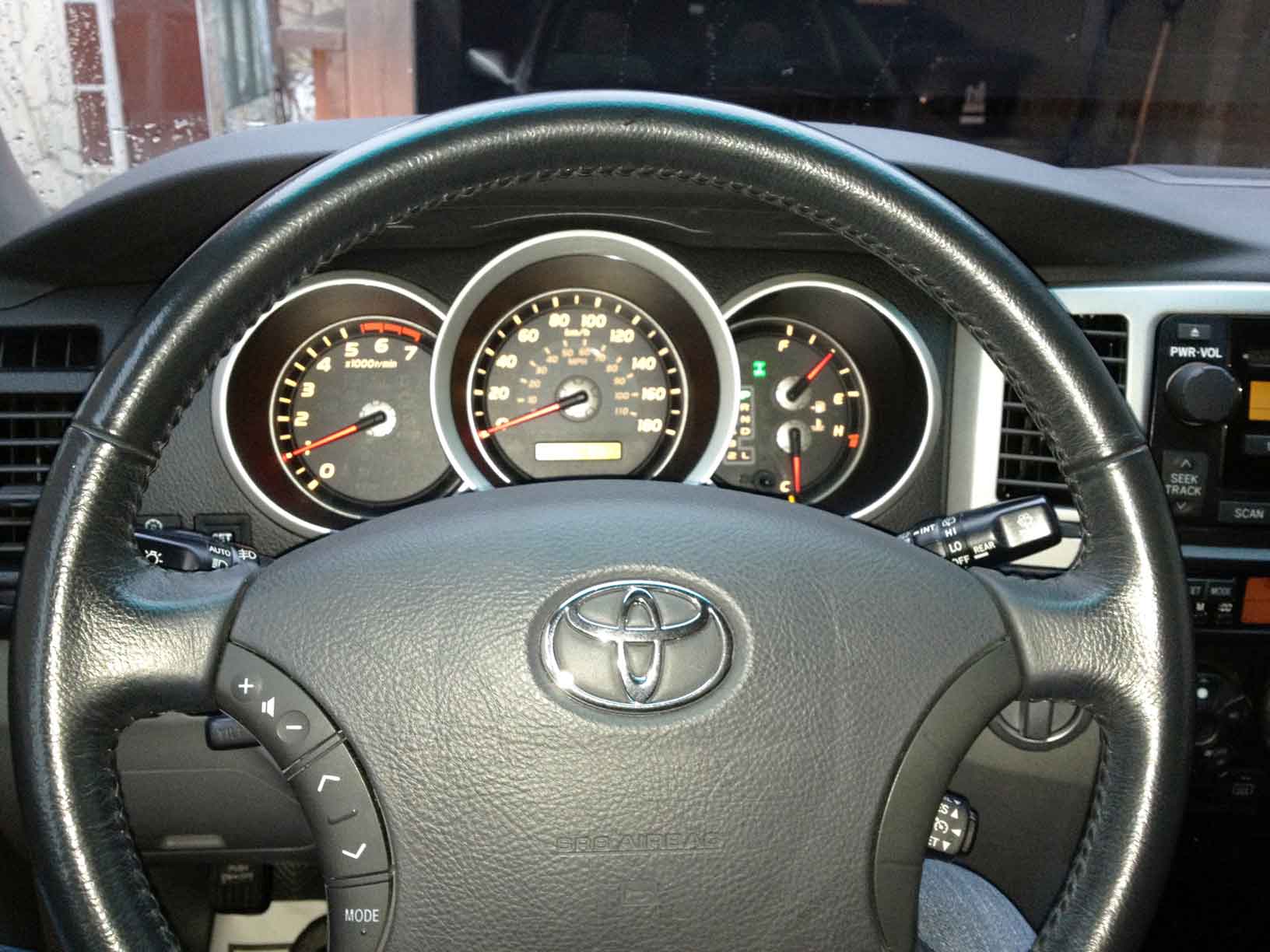

Just to confirm, the part number I ordered (in the pictures above) is 84288-35030-BO. So you agree that the part I need to match what I currently have for the left side controls (volume, tuning, mode buttons) is the Dark Charcoal 84244-35030-B1?
I understand your frustration. I am quite sure you need the part number ending with B1.
My advice is (what I did too because I was also not sure about the color) I went to the dealership, the parts guy came down to my Truck and read the plate on the driver’s side and then looked in his computer and told me the part I need is the part number ending with B0. And I ordered the part from the dealership along with the Ribbon.
Now you decide which way you want to take. Good luck.
You can see my truck’s steering before this switch was installed.

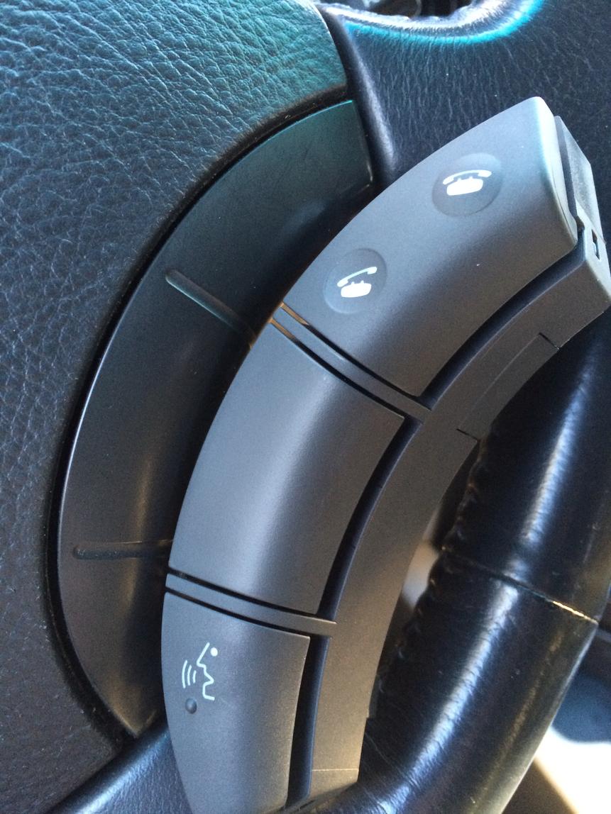

Thanks again [MENTION=50507]CookieRoe[/MENTION] for the write up. Finally installed mine today took less than 30 min. Everything works great. I can confirm that these controls are compatible with the 2013 Scion FRS Pioneer Bespoke touch screen head unit. :clap2:
