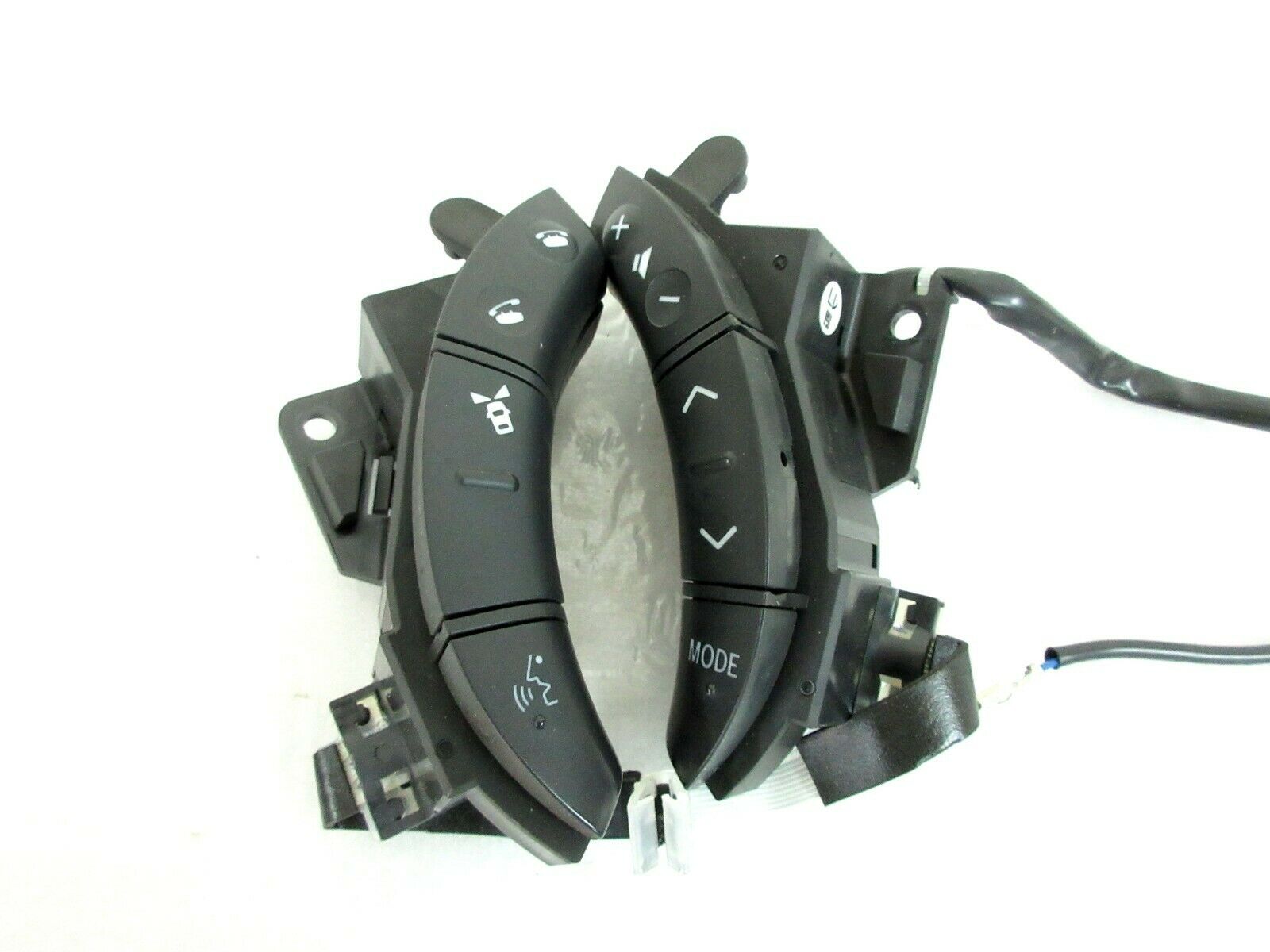

Great thread, I’ve been wanting to add the Bluetooth controls to mine as well. Do you know if this one will work in our setup? Mine is a 2008. Will the ribbon plug into our stock volume controls? If not will replacing them both work and the new wiring harness plug into the steering wheel? This one is an ANH10 75B037 model if that helps.

Wow, that are some interesting controls you found there! Never saw them. Are those front parking sensor buttons??? What do they do? Anyway, I'm fascinated, but I'm warry about if the plugs do the same as the stock 4Runner. It's worth a try, it is only $57 compared to $150 to the stock ones (or more).
To answer you question, yes, the ribbon cable should wire up to your stock volume controls, there is a an unused plug for them on the steering wheel volume control assembly.

Idk honestly lol. I thought maybe a navigation button? I want to do the mod but not really enough to spend $150+ Just yet. Was just hoping to find a second hand right side, good shape and in working condition.
Maybe it will wire right up and work, except for that "parking sensor thingy" which of course our rigs don't have. I'm sure someone can figure out if they work by looking some some schematics. Whatever, it would be nice to know if this is a good low cost alternative to getting the factory buttons (cheaper).
